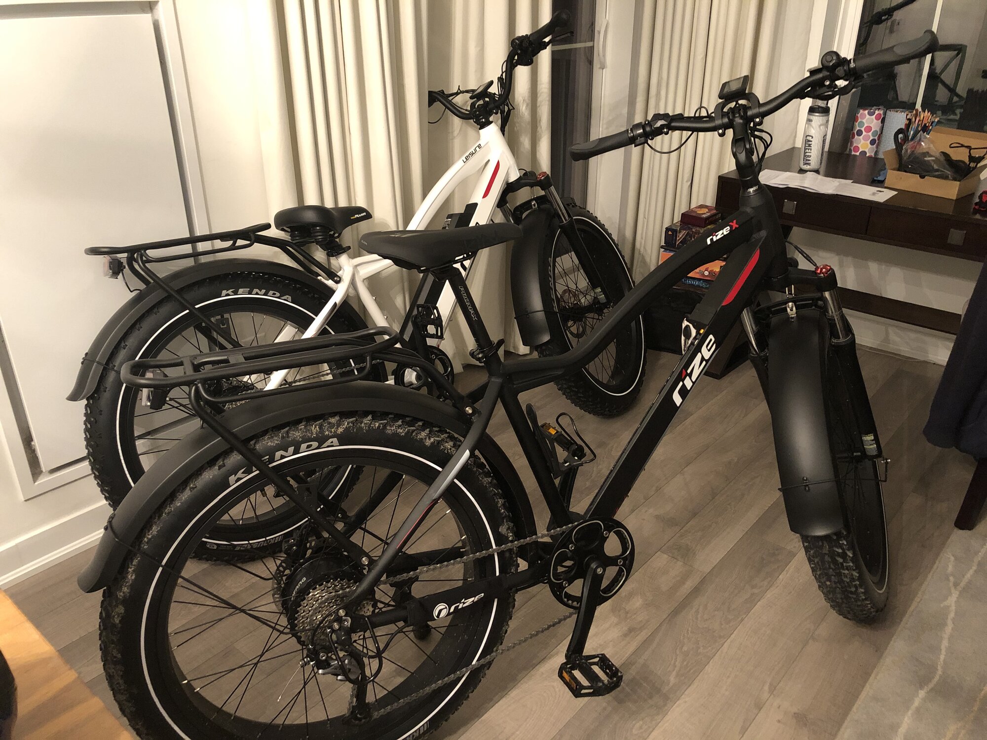

For my wife, we had some struggles getting her comfortable with the Rize Leisure bike so far. She is 5 foot 2 and is intimidated, so I think she has to get over her initial fear of the thing and just get riding on it to get accustomed. We brought it inside and I tilted her seat forward and lowered it further so we will go out and try again tomorrow.
I am actually very interested to compare the difference between the Rize X Torque pedal-assist vs the Leisure's Cadence pedal-assist. I wonder if I will find it noticeable.

Both the Rize X and Leisure have been great so far. My wife is getting more accustomed to the Leisure and enjoys it more each time out. I was worried at first but am less concerned now as she gets used to it.
Also, when I'm on the 9th gear of the shifter, it tends to jump sometimes if I put a lot of torque, I bet I could adjust it a little not to do that, but I just stay on the 8th gear instead and the problem is resolved.
That's concerning considering the small chainring, I would hate to give up use of the highest gear on the back. Do you mean the chain is jumping? I'm more of a low cadence high torque rider.
The lower you go into the assists level, it feels more like if the bike takes you to, let's say, 15 km/h for assist level 2, no matter the torque you put in.
That's interesting that you are running into a speed limit with the PAS. That sounds like the PAS assist levels on the Rize X are based on speed rather than power that I've seen mentioned on other bikes like Ride1UP and Radrover. I had read a Rize RX review (on this forum) that made it look as if the PAS on that bike was more power related as the speed range varied based on pedaling intensity for each given PAS level.
And someone else mentioned increasing the PAS level on the Rize X when going up a hill, as if the bike otherwise did not maintain speed and that the PAS level was based on power vs. speed.
Also, is the cruise control based on maintaining constant power or constant speed? Like if you start to go up a small hill, will cruise control increase the power in order to maintain speed, as Juice describes their cruise control on their website?
