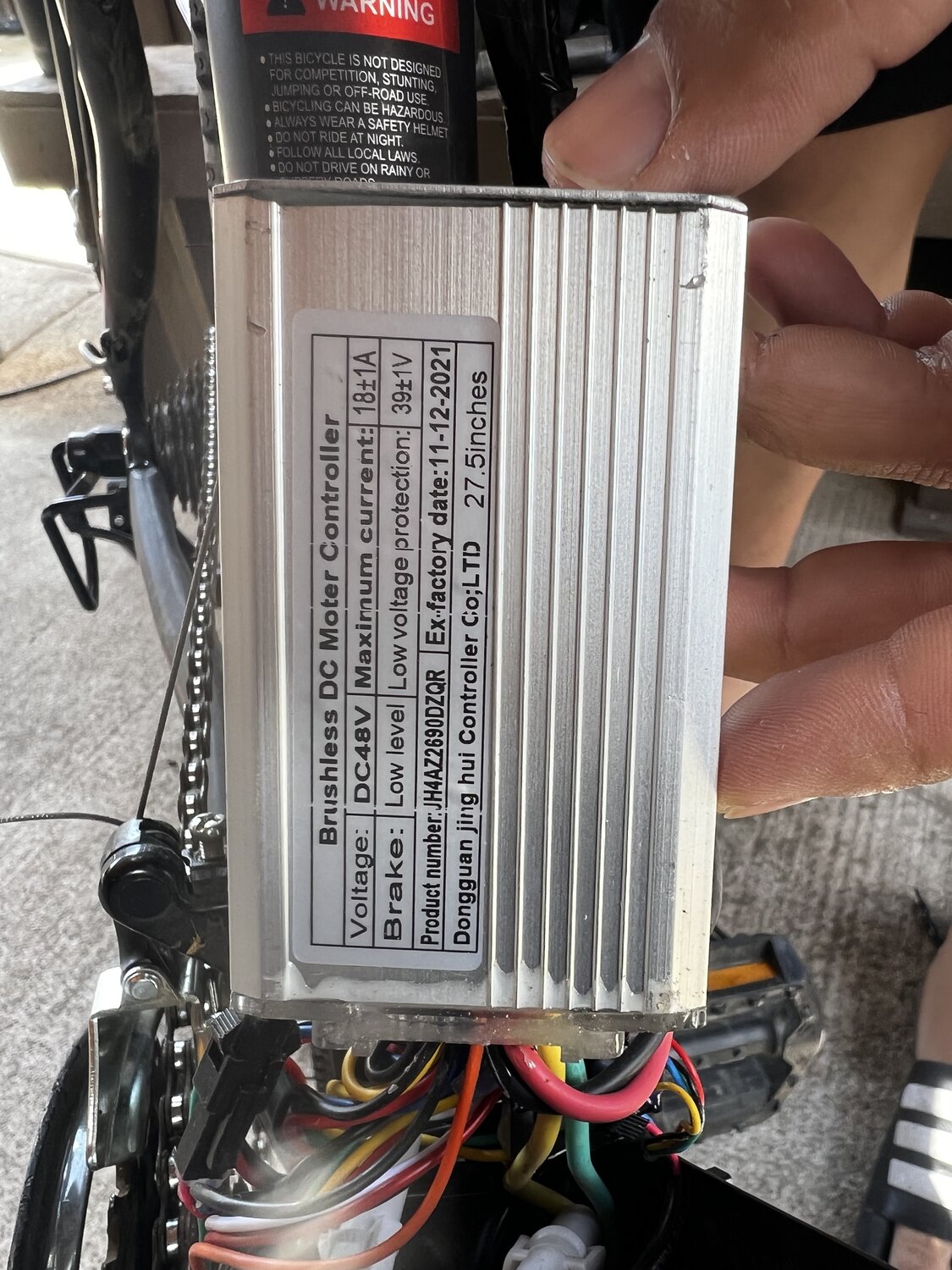

Now I’m having issues with my bike shutting down From possibly a low voltage…
Initially everything is good, after maybe 10+ miles the bike will dead stop. I will then look at the battery indicator and it will show no charge, but when I power cycle the battery it will turn on and show it has 4 bars. Now when I try to ride it, it would always die under load or if I ride it long enough. So even if it shows about 70% charge it would still die. Here’s a video of it
Not sure if the controller is drawing too much power than the battery can handle? Idk really what’s causing the shut down.
If I do charge battery again everything will be fine even under load until maybe about 10+ miles

Trying turning the max voltage down to and see what that does it might , link didn't work for bike but if that's your controller it's controller to much power

The link to the battery is broken in your post, but I was able to fish it out:
While that link indicates you chose a 48V battery I wonder if they sent you a 36V? Except for the chooser section, all text on the page speaks to 36V batteries.
Do you have a multi-meter to test the voltage? At full charge a 48V battery will read 54V. A 36V battery, 42V.
Your battery can't handle the power your controller demands,, what battery was on there before
It was a 48v 10AH battery that was here before and everything was perfect till it died. The Amazon seller refunded me portion for the battery so I ended up purchasing the one above. The new battery is Labeled 48V 10AH.
Everything runs great when it’s freshly charged, can maybe 10 miles even with load… the battery level indicator on the battery never matched what’s on the ebike screen so I’m not really sure if the true battery level…
But anyway maybe after 10 miles it will randomly turn off described in the video above and I have to keep power cycling the battery for it to work and turn on. But even if it turns on once you sit on the bike and give the motor load.. it will die..
It really only works fresh out being charged full
I don't think you should expect a lot better from this battery. Your controller can draw, wide open throttle, 52.4V x 18AH = 936 Watts/hour and your full battery 524 Watts/hour, that is less than 1/2 hour of wide open throttle before the BMS cut.

My understanding that it is ok to go higher amps on battery just not volts? Because the controller can only grab so much.

Like If battery is 20ah and controller is 11 ah but both 48v?
There is battery capacity measured in Ah then there is discharge current measured in Amps. Any 48v electric bike battery offered on Amazon should be suitable for a 500w motor. The 18 Amps of the controller translates to a max draw of 750 watts which is typical of a 500w motor.
