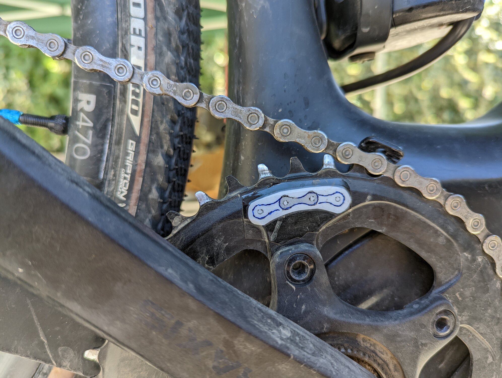

Hi,
I am new to the forum and it looks like there is a LOT of great info here. My wife has a 2020 Creo and it had been working well for hundreds of miles, but now the chain is dropping off the front chainring on EVERY ride. Every ride = 4 in a row so far ;-) I recently got a 2021 EVO and ridden on each of those rides and my chain did not drop, or falter in any way. I see a lot of posts about the Praxis chain drop issue and it seems like the Gararbuk chainring may fix it, but their website says it could be 15 - 30 days for a chainring!!
General question: Has anyone else experienced good performance, then suddenly started to drop the chain?
Here's what I have checked:
- Is chain aligned on chainring correctly? Yes, matches the etching on the inside of the praxis chainring. I taped a copy to the outside since it was dropping so much!!
- Is the clutch on? Yes, for all except one instance. I swapped tires for her and forgot the clutch once
- Chain wear? chain is good
- Derailleur alignment? check, it is straight and I actually took the wheel off and used the Park hangar alignment tool. Hangar is good and derailleur when mounted is straight
- Shifting is adjusted and smooth
- Mounted the Specialized chain guide before the last ride and chain still dropped/jammed in the chain guide
What I noticed after this weeks rides is what seems to be excessive, or abnormal wear on the Praxis ring. The entire outside, of the outside tooth is shiny. Not worn yet, but definitely heavy rubbing (see pics).
Any ideas or suggestions?
Thanks!

I'd replace the chain - it's noted GOOD - but if certain tests were done - it's more than likely stretched
to the point, that it no long fits the pitch of the sprockets, and more than likely will crawl off.
The easiest test is wrap the chain around the sprocket almost full circle tight as possible,
it should be impossible to pull any portion of the chain away from circle of sprocket.
If any portion of chain is floating offset from the teeth of sprocket. It's Junk.
Best point of test is 180 from free ends of chain.
Prolonged use like this will only destroy the sprockets as well.
Once the new chain is put to the same test, it will become quite clear.
One could lay them side by side, and see the pins of chain no long match a foot or two pulled tight.

It could be that one or all of the small bolts on the chainring are lose or tightened but one or all are out of torque spec. I put a new chain ring on a different bike . Along with new chain and rear mech. Tighten it all but could not get the chain to stay on thru all the gears . So I called a guy I know at the LBS . His first suggestion was even though I tightened the chainring down . It had to be torqued exactly to factory settings . I found out that spec and tried what the Mechanic had suggested . Sure enough that was the issue . I remember when he suggested this my first thought was how could that matter that much . They only go in so far I thought . But it was my issue . MAYBE IT's YOURS
Not a Creo here but I've used Praxis 48t and 36t with a variety of chains and clutched and clutchless derailleur never had a chain drop on 9 and 11 spd.
Is the chainring aluminum or steel? If aluminum I'd suspect it may be wore and maybe wore if steel, or the chain may be wore.

Yes, that is actually a very good test. I originally checked with the Park tool, but did the "manual" test this morning as well and it is OK. I sent the photo of the chainring wear and the problem description to Praxis. They said that was "normal" wear, but did offer a discount to buy a new one from them :)
I think I will order the Garabunk ring and keep fiddling until it arrives.
Thanks for all the good tips. If I find out anything new I will post an update.

One of the first things I remember in Courts Videos is his attention to mention not to pedal and e-bike while attempting to shift . It is amazing how many people I see riding e-bikes . That keep peddling thru the shift .
Interesting, and a point to consider. Do you have a link to the "Courts video", i'm not familiar with that reference.
A good idea about a possible bent link, that WOULD help explain that all of a sudden it was common occurrence. Perhaps, after the first drop it jammed and bent a link... from then on it would happen a bit easier. I'll check.
I have another friend who just got her bike out of the shop for chain drop issue and they blamed the worn Praxis. Replaced it with new. We'll see what happens to her.
Not to pedal is incorrect here. On a Creo it is necessary to pedal with reduced effort through a shift. It is a type 3 e-bike whose drive train stops when the rider does not pedal. I believe this is also true of your friend's Verve. Reduced effort is especially important when pedal force is boosted by a high level of assist.
