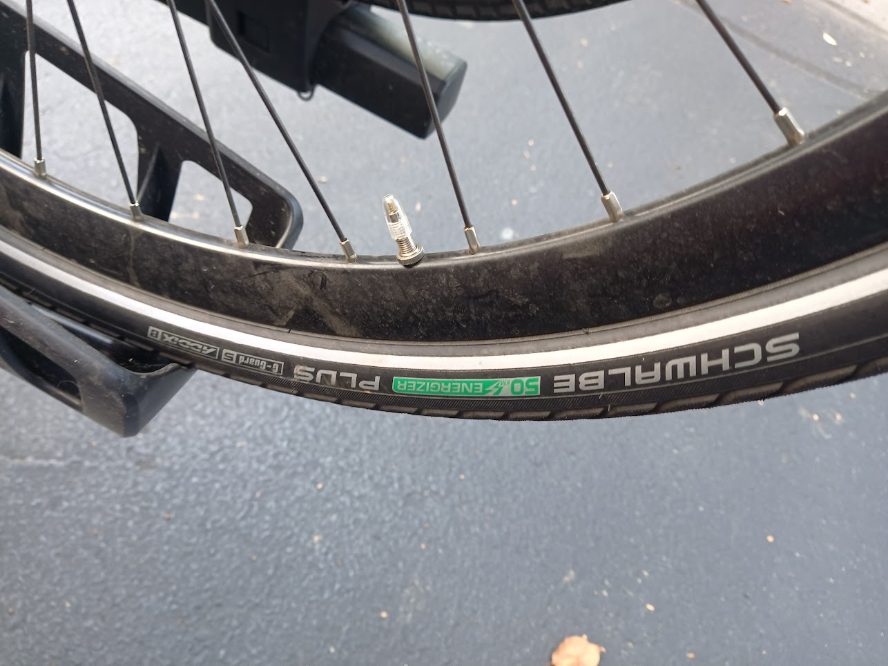

So the Schwalbe "Energizer" (??) tires are fine for commuting. But on weekends I like to do rail trails with some gravel, etc. Compared to the Vado 4 tires that went over gravel much better these seem to kick the rocks to the side or the wheel will jump a little. I would like to get something a little more aggressive like the Vado. Some years ago I had some MTB tires that also had a solid bead in the middle so for street riding it had good wear and noise features but the sides had a lot of grippy bits.
