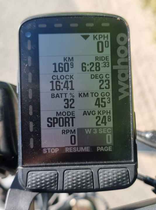

For your information: The modern Garmin Edge or Wahoo ELMNT bike GPS computers are fully compatible with your Vado, and will serve the purposes of ride recording (taking the data from your e-bike via ANT+) and GPS navigation. Also as an extra display...

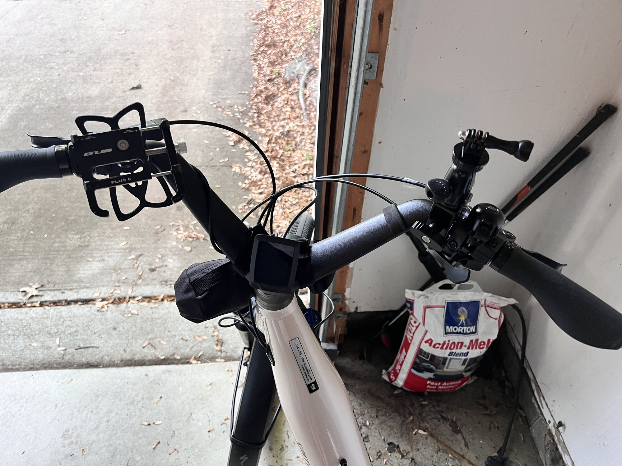

Thanks for the reply. My new bike is a Como and it isn't obvious that there's any good way to mount a Garmin OR a phone. The handlebars aren't round except at the very ends, where the grips and brakes already reside.
Oh. No round space of 22.2 mm left past the brake lever?
There are plenty of bar phone mounts on the web if you look hard enough. There should be enough room on your Como bars just beside the rt/lft grips to attach a phone to as this member has done on his Como 4.
A Peak Design universal bar mount could also work. Both my wife and I have the out-front versions and they function incredibly well utilizing a magnetic catch. In our case, we use 3rd party cases and the Peak Design universal adapters.
I love the Peak Design phone mount.
For V-shaped bars you might be able to find a "bridge" (there's one for Brompton for sure) which gives you a straight bar across the V.
The TCD also uses a Garmin-style mount so as long as you have slack you can buy a Garmin mount (there is a huge selection) and move the TCD somewhere else. You could then mount a Garmin Edge in the center if that's what you want. I'm not sure if the center area is a normal stem on the Como, but if so you can get stem mounts for other attachments.

@dbsmith: Just fancy I was riding a Giant Trance E+ for a year, not being aware Garmin Edge or Wahoo ELEMNT were fully compatible with Specialized or Giant e-bikes and having constant issues with the Giant display! Since @DaveMatthews explained the capability, my brother has been riding the Giant with Garmin Edge 530, and I went through 3 different Wahoo ELEMNT versions (each being good but I was looking for the latest & greatest, haha!)
That's how I have configured my Wahoo to work with my Vado (and Vado SL).
