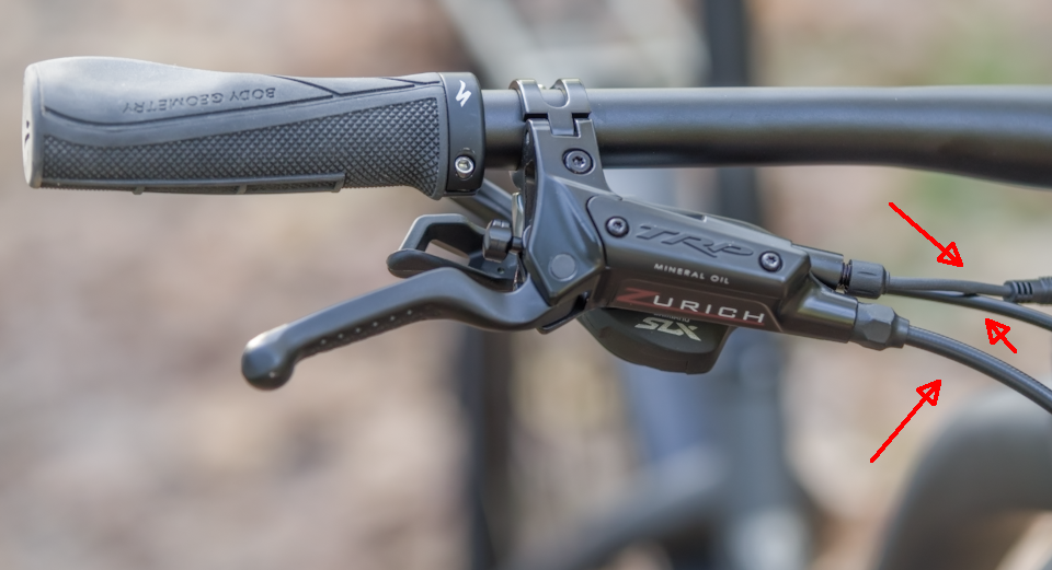

Excerpt from Vado/Como User Manual:
I'm pretty sure it doesn't have 'brake cutoffs'.
How many cables go out from your brake lever?
(The thin cable here is for the motor cut-off)
P.S. I mistakenly marked 3 cables. Wrong. The third cable is from the shifter. The brake cable #1 goes to the rear brake and the thin cable is for the braking sensor.
No wires man, just a hydraulic line. AFAIK the yammer mid-drive relies on the torque sensor for power signal. When you quit pedaling it quits assisting. ;)
