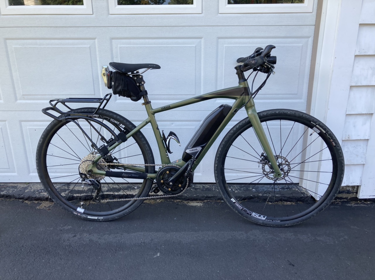

This being an ebike review forum, I thought that this would be a good place to display our modifications and provide our opinions.
I have upgraded almost everything on my Cross Core. The bike is fine stock, but it is also a good place to start to make the bike that you want, but can’t find.
The first things that I changed were the tires, (Maxxis Receptor 40mm), and the saddle, (Fizik Aliante). The Maxxis tires are more compliant and much lighter. These were the most important and probably the most common changes.
I replaced the wheels with DT Swiss CR 1600, (the stock wheels are fine, but I ruined one during transport). The CR 1600 is a rugged gravel wheel and it also provides a nice ride.
I also replaced the stem with a Red Shift suspension stem, the seat post with a Cane Creek Carbon eeSilk Gravel, Salsa Deluxe Bend bars, Spank Oozy pedals, TRP Spyre brakes and SQLabs 710 grips with Specialized Carbon bar ends repurposed as inner bar ends. The drivetrain is now a Shimano SLX 1x11, 46t chainring and 11-42 cassette.
The Garmin 830 and Varia are shared with my conventional road bike.
It went from nice hybrid to capable flat bar gravel bike. It’s not too fancy, but just a very enjoyable bike and a blessing when the grade approaches 20%. It’s a bike that wasn’t available off the rack and with all of the changes, I still have less than $4,000.00 invested.
It’s a shame that they don’t offer a frame and Yamaha motor, battery and electronics. I built some of my road bikes up from a bare frame and for me, it makes more sense because over time, I will probably change everything to something that I want rather than what the manufacturer chose.
Please share your upgrades and advice. Thanks

I understood going in that I would be making many changes to my bike. This being an ebike review forum, I had expected to see more emphasis on reviewing bikes, accessories and components, and there is a fair amount of that within the forum, but it is not always easy to find, so here is a mini review of my bike and components.
Yamaha Cross Core: Reasonable weight, very good warranty, long established company. The price wasn’t low, but seemed to be very competitive considering what you got. The bike was a good platform to customize. I wanted a class 1 that handled well, had a reasonable weight, had a fairly powerful mid drive and natural feel. The Cross Core ticked off all of the boxes and is still the bike that I would choose today, so no regrets.
Cane Creek Carbon eeSilk gravel seat post: Expensive, but after two spinal surgeries last year, the cost seemed worth while. The change in comfort was immediately noticeable. The post takes the shock out of big hits and smooths out the smaller irregularities without bobbing. The only thing that you notice is that the ride is much smoother. The Carbon version doesn’t add much weight and is visually pleasing, (to me anyway). Also, no regrets.
Red Shift Stem: Pretty much the same as the Cane Creek seat post. It does what it claims and there are no real negatives.
Salsa Bend Deluxe handlebar: I find this bar to be a worthwhile upgrade from the generic bar that came on the Cross Core. Mine has the 17 degree sweep which I find comfortable. It is light and seems to be more compliant than the stock bar as well. My wife tried it and immediately ordered one for her Cross Core. We are very happy with this bar, but the angle may not be right for some others. They do make a 23 degree sweep as well and because the bar bends forward before sweeping rearward, the reach remains approximately the same as the stock bar.
Shimano SLX 1x11: So far, so good. I lost some redundancy and so far, I like it very much. I went with a 46t SRAM chainring and an 11-42 Shimano cassette. The stock Sora had failed to shift down to the small chainring a few times, and the 1x11 provides a better range and so far, it is very reliable. I haven’t had it long enough to determine longevity, but so far, I see it as an improvement.
Maxxis Receptor tires: They are wearing well. They have approximately 1,100 miles on them right now. It looks like the rear will need to be replaced in another 500 miles or so. The front will probably be good for at least 3,000 miles. They are a “dry” gravel tire. They roll well and are quiet on the road. They grip well on dry dirt roads and gravel. They are more compliant and much lighter than the stock tires, but not as puncture resistant, (I have not had a puncture yet). When the time comes, they will be replaced with the same.
DT Swiss CR 1600 Spline wheels: I would not have upgraded the wheels if I hadn’t wrecked the original rear. The DT Swiss set are noticeably lighter and they are also wider, which helps to smooth out the ride. I like them, but it is a relatively expensive upgrade and if I hadn’t had to replace my stock rim, I wouldn’t have upgraded. I do like these wheels and I don’t regret the choice. They are also a gravel wheel and rated to 130 Kg.
Spank Oozy pedals: Nice quality, good grip and a nice size for me, (my shoe size ranges from 10 to 10.5 US). They are fairly light and rebuildable. They look nice enough. I have never slipped off of them. They simply work and I never notice them, so I consider that a good thing.
Fizik Aliante saddle with Ti rails: This was a takeoff and not in current production. I would buy another if I could find one. I rode Selle Italia Flite saddles for many rears. Then I rode the Gel Flite, until they changed the design. The Fizik Aliante is the best shape for me, (Fizik calls me a bull because I am not very flexible). It is difficult to review a saddle because it is a very personal choice. The Aliante works for me. It is light and compliant. The build quality is in my opinion, exceptional. My all time favorite.
TRP Spyre brake calipers: If I had it to do over, I would have just gone with Shimano XT hydraulic calipers and levers. The Spyres work well and I have no real complaint, but they are not noticeably more effective than the stock calipers. The real advantage is that I can just adjust them by the barrel adjuster because they simulate a two piston caliper. The real drawback with cable actuated brakes on the Cross Core is the cable routing around the mid drive, (I went with Jag Wire Pro brake cables and after carefully routing them, they work smoothly). There is a good chance that I will eventually replace the brakes with good hydraulics, (poor quality hydraulic brakes can be less effective and much less reliable than decent cable actuated brakes).
I hope that this thread will be helpful to others that are looking to refine their bike a bit. I do tend to go overboard and be a bit obsessive, so take what I did with a grain of salt.
