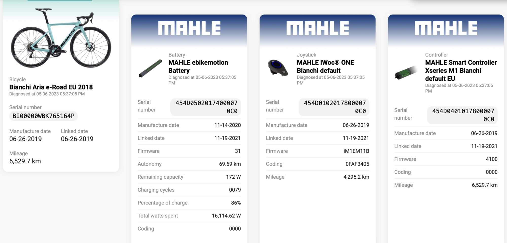

You should be able to replace the motor without needing to visit a Mahle dealer to code the device. If you log into your Mahle account you will see the 3 components that are all coded together by the dealer. The motor isn't part of these, looks like it's the battery and controller that are the important parts. I had to replace the iWOC controller about 18 months ago and just did a swap with no issues, the old one broke on me (LEDs stopped working and it very intermittent to turn the bike on or off).
