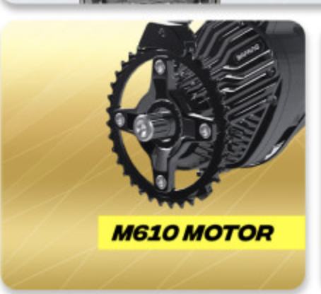

I also saw that some companies offer M610, is this the new version of m600? Doe anybody know major differences?
No Bafang M610 motor.
See list of Bafang Motors
Not yet available but due in the spring. The FLX Weapon is being advertised as having it. A bit lighter and hopefully better access to tuning for individual preference.
Not listed on Bafang’s site as of yet, and as mentioned, only seen the FLX Weapon advertised with it.
Considering the recent M510 variant of the M500, am guessing it will be similar, perhaps slightly lighter and slightly more claimed power/torque output.
Like @JRA mentioned, we’re all hoping for more access to configuration/‘programming’ access, but I’m not hopeful there myself.
Unless something truly surprising happens with the M610, I don’t see any way it matters to those considering or owning an X2 with Ludi controller, although it will be interesting to see how it compares to the OE M600 for both replacement motors and new bikes with Bafang firmware and controllers..
