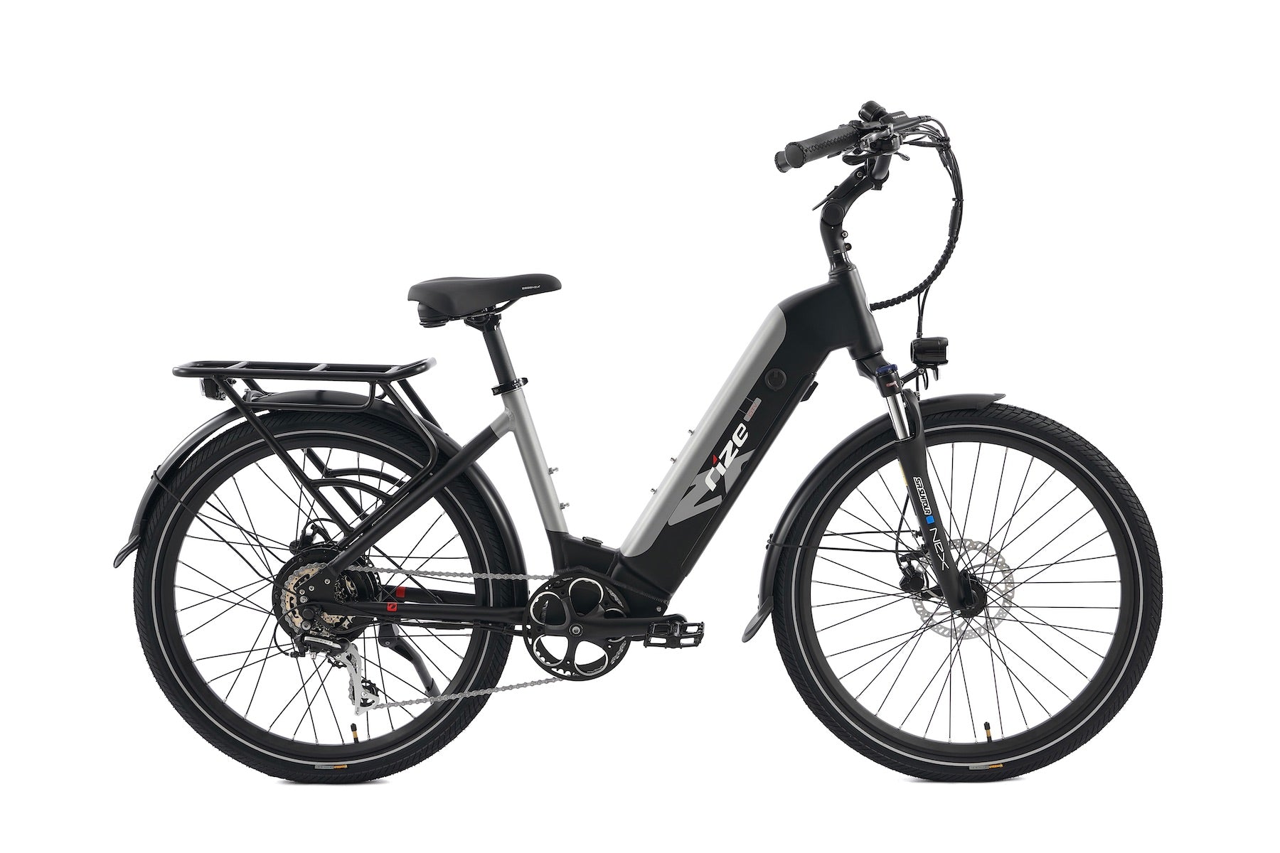

Both the Blix and Rize are nice hub-drive city bikes... I would recommend spending the extra $400 to get the 17Ah Battery + Hydraulic Brakes + Torque Sensor.
Have you considered for the same price, you could upgrade to a mid-drive with the benefit of the geared mechanical advantage to climb hills.

Thanks, Flat Six, but I'm more inclined to choose a hybrid upright seating position with swept back handlebars. I'm 66 years old, lol.
