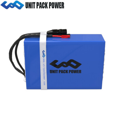

Any thouggts about a battery pack like this that I could put in a bag?

Big lie. that is not 58 AH.
You can put any generic battery with XT90 or Andersn connector in a bag, if you tape over the end to keep it from shorting on your tire tools or pump. Mount to be arranged before you need to use it. I wrap battery in 3/4"x1/8" aluminum angle cage with hangers or clamps to frame or bike basket mounts. 10-32 SS screws with elastic stop nuts to hold it all together. Use safety glasses using power tools. Saw yesterday lowes was selling SS machine screws $2.28 for four. Mcmaster.com sells them $5.50 for 100, +$8 freight.
It's a crap shoot to buy cheap batteries. There's not much financial risk because they're cheap, but there's the safety risk if they catch fire. Luckily, that's still a rare event. You do have to be more careful with these soft sided packs, One bad drop.
I've bought hard case packs from U.P.P.
