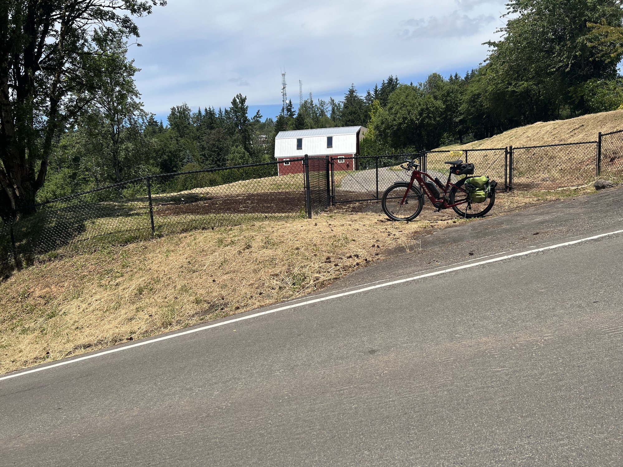

I should explain how I tested the motor. first find a really steep hill around 18% worked. before I updated my motor going up the steep hill and putting out 450 watts (I have a nyon) and peddling from 70 to 80 rpms. I changed assist levels and could nto find any difference between them. when I got my motor updated. so far I only maxed out on there 22% hill I do a short 18% hill every day and I will see if I can get 540 watts out and go faster. but I cant always manage 540 watts. I ahve done a few 600 to 700 watt packs when starting out but that only lasts for a very short time. here is my test hill.
View attachment 128514View attachment 128515
Well, it's nice that there's a little pull out at the top...Looks like there is a stop sign about 80% of the way up too. Funny place for it. My dad taught me to drive on a VW bug standard. He would have driven me up to a stop like that, put it in neutral with the parking brake on, traded places, and told me to drive.

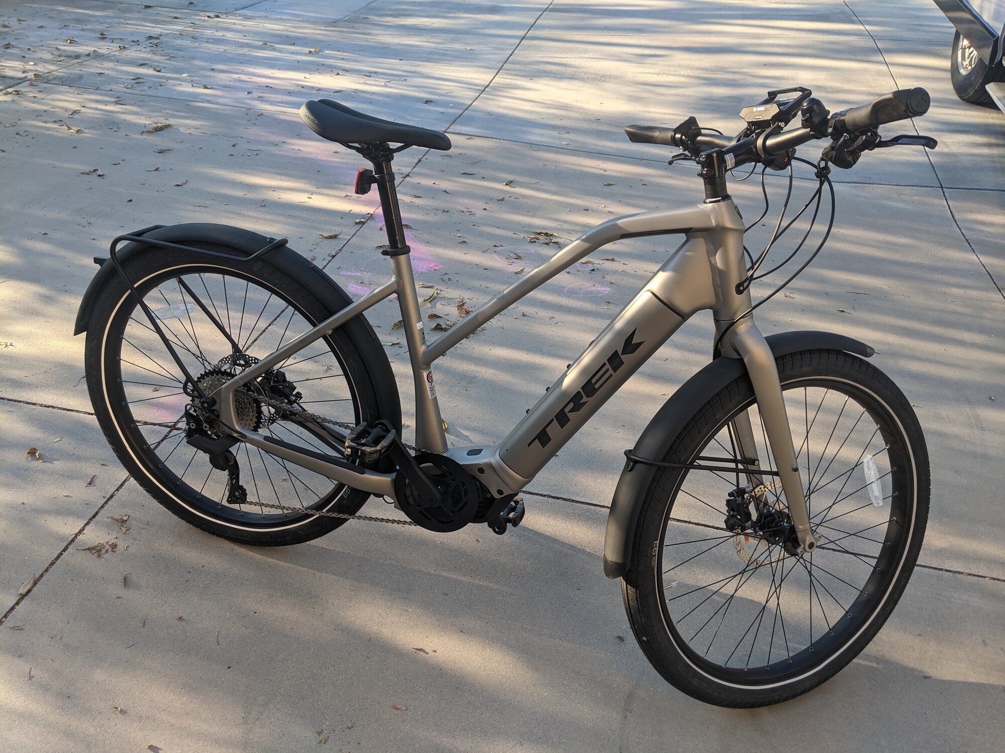

Well, well. I spent some money. :)
I'll post back more once I have the bike dialed in. First impressions: when you first see the bike in person it looks big, cool, but big. I was a bit worried it might feel cumbersome or clunky. But it doesn't at all. Quite the opposite actually. Driving around the block at the dealers it felt well balanced and put together. That was my strongest first impression actually-not the ride assist stuff but that the bike had a very comfortable ride position, solid feel, reasonably responsive, great brakes. Derailleur felt a bit thunky during the test ride but they tuned that up and is now smooth. I have a short inseam and a long torso so the L frame with the stagger is a good fit for me; can stand over the bike comfortably. My wife dropped me and the bike off at the base of the hill on the way home. The seat height was adjusted for her since she demoed it after me and i didn't bring an allen set but I thought let's give it a go anyway, since that was the whole point. It/we went right up, no problem. I kept putting it back down to no assist just to make sure I wasn't sort of imagining things. Even with the first two assist settings there was a big difference. I'd look at the display and go, "really?" and then look at the side of the road and go "yes, I guess so". But like I said once I get it dialed in and adjusted properly I'll post some more.
