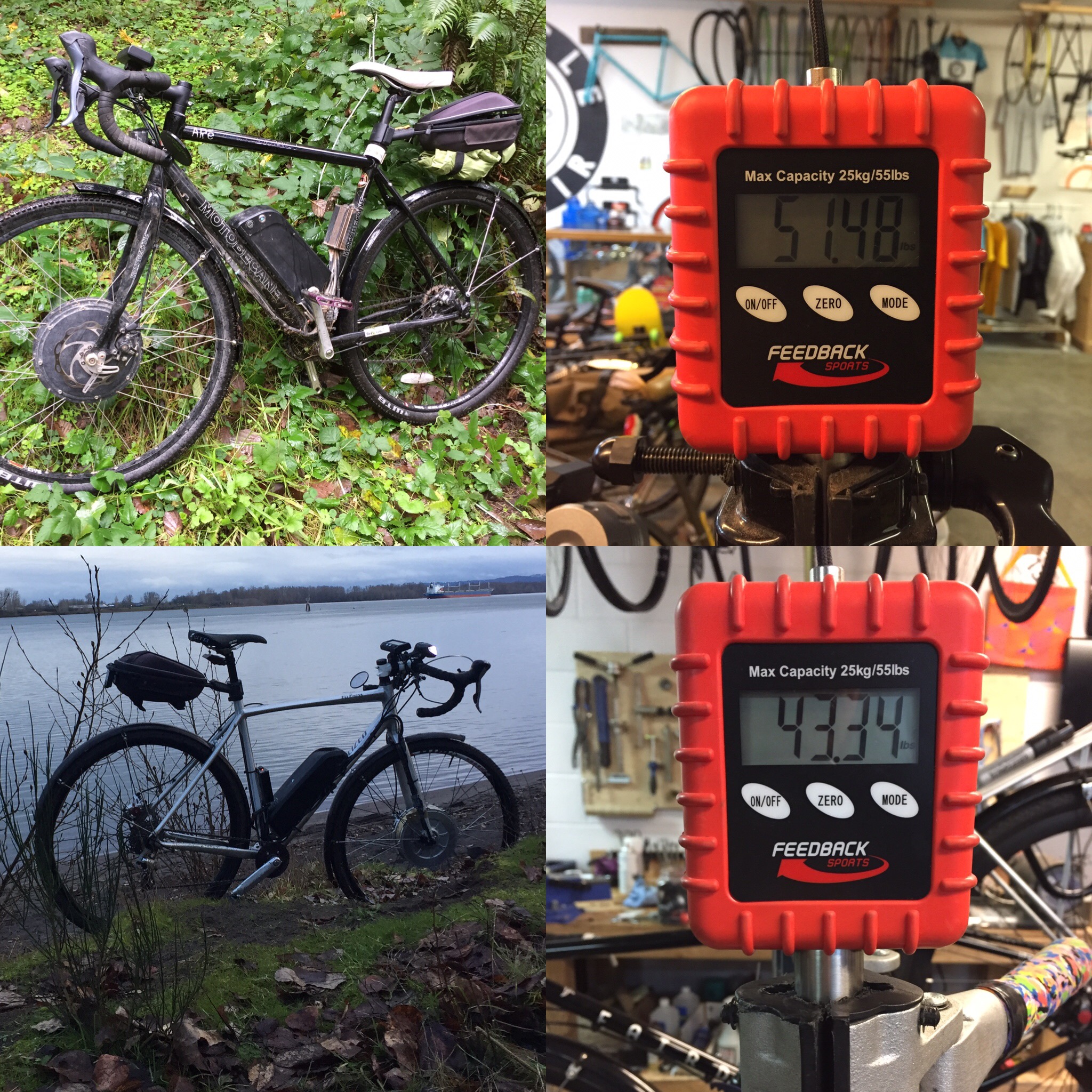

While there are no big manufacturer bike brands that have bigger motors there are ways to get it done in a similar fashion to the bikes you are looking at with either a hub motor or a mid drive. I choose to use a 1000w front hub because that is what I have found to work the best for my needs. There is a good option in the Bafang BBSHD series motor for mid-drive conversion also. Putting together a custom build is not as hard as you would think and the best thing is that you get to choose the bike that suits you the best and work from there.
Here are the two I have built up, the black one was my v 1.0 and v 2.0 got the dietary treatment but they both perform pretty close to the same actually:
I see it said a lot that direct drive hubs won't climb well but I have not found that to be the case with these bikes. But there is a lot to be said for a mid drive being able to take advantage of the drive train also. I just like a hub motor for its all around attributes and the fact that it doesn't interfere with my pedaling style.
