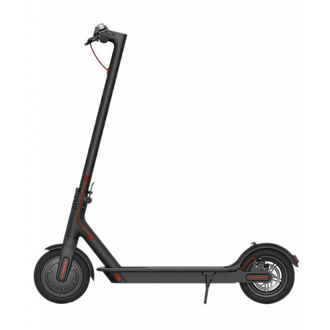

The Netherlands is a flat country full of bike paths. Many thousand of people mount their "omafiets" (traditional "granny e-bikes") and steadily pedal them to work/school and back at steady and moderate speed. All of them. E-bike in the Netherlands might be a choice for an elderly, ailing person bur not for a student.
Yes, I understand you are not used to be pedalling as the Dutch people are. Consider an electric scooter.
Xiaomi M365 costs about EUR399.
Mark my words: A 600-900 US$ e-bike in Europe is just a junk. Spend your money wisely, please.

This was actually what I wanted to get and an ideal means of transportation for these short distances in my opinion. However, the government of the Netherlands does not have the same opinion and considers these illegal. If you are caught with one you get a fine of around 400 euros and they even confiscate the scooter, so unfortunately I cannot use one.

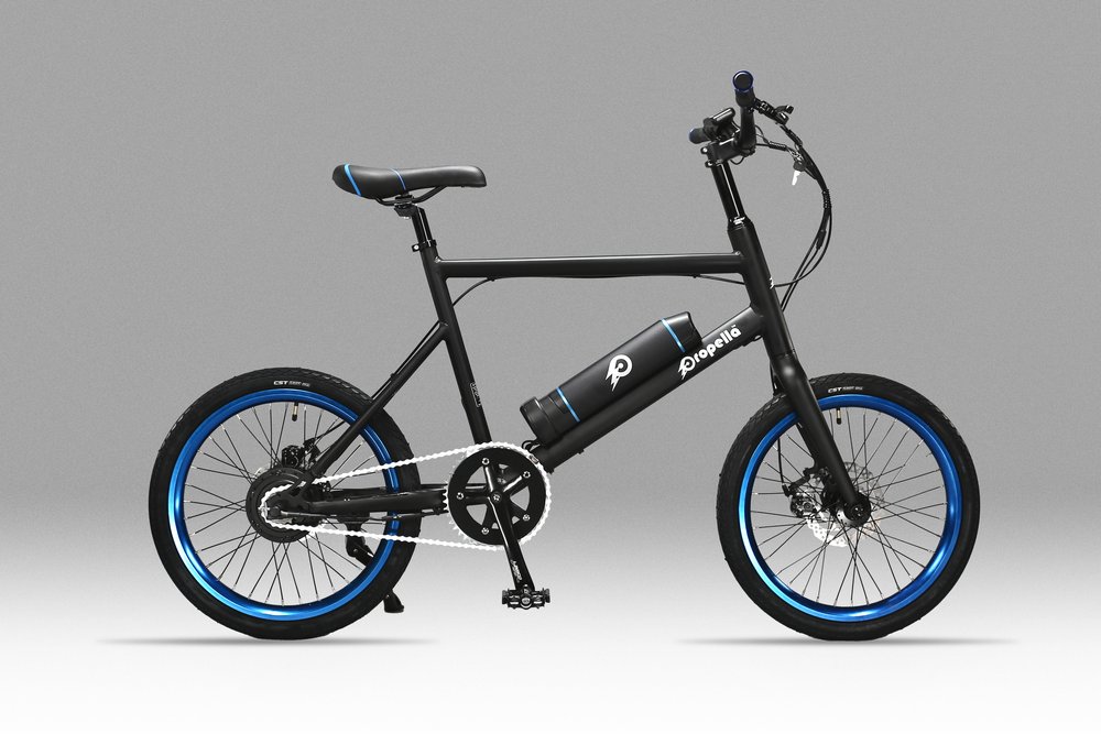

Tough challenge Bleta. Low budget and getting a folding ebike up some stairs. Many of the budget folders are over 60 lbs (27 kg). Not so easy to wrestle up stairs.
While surfing around online the other day I saw this little ebike. Propellant Mini. Not a folder but it weighs 33 lbs (15 kg) and starts at $950. It might not be available in your area.

Marci: is this available in the Netherlands?
Darn, looks like just US & Canada. From the Propella site:
WE CURRENTLY SHIP TO US AND CANADA ONLY.
I just happened to catch this little bike while surfing around. I was thinking it might fit inside my Acura suv. Most of the folders are just too heavy for my wimpy arms.
