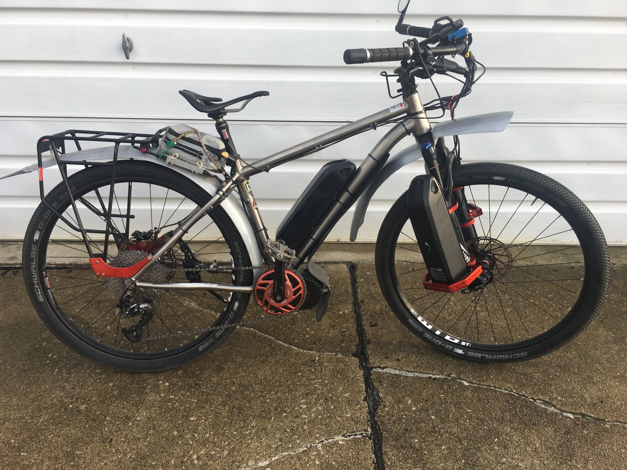

My experience into the heavy side is that you have to pull all the stops out to still have a true bicycle in feel, looks and good handling. That means attention to rolling resistance, aerodynamics and weight. All are all important and nothing can be assumed. If it does not feel like a bicycle to me, then I am not done with the job, simple as that. I am getting close but I am still not really there. My bike is pretty nimble and handles well on pavement, but not so much on technical single track. Its a pig on tough single track but that is a compromise I am presently willing to live with for long range. I will continue to look for solutions.
On my present bike, I have played around with many options and explored the ranges with those configurations. My bike is a titanium fat bike frame with 150mm/197mm spacing, Bafang BBSHD 120mm mid drive. I have four 52 volt batteries in parallel for a total of 49 Ah or 2,538 Wh. Jones high rise loop bars, Lev dropper post, Infinity saddle, Sram GX 11 speed, 11X46 cassette, Liekie 42 tooth chainring and Guide brakes with 203mm rotors. Total weight with Axiom rear rack is 81.5 lbs 37 Kg. I have 15 amp fast charging.
I am finding that I can realistically pull about 2080 Wh out of the batteries with 29" tires and speeds of 16-20 mph (26-32 kph) on pavement or 1,980 Wh out at the same speed with fat tires on dirt.
Me and the bike with a day pack weight pretty close to 300 lb (136 Kg).
Speed of 20 mph (32kph) Flat pavement no wind room temperature is a range of about 175 miles (280 Km) with 29X2.25" G One tires.
Same with 10 mph headwind and range drops to 125 miles (200 Km)
Add in the head wind and 4,000 feet (1,212m) of climbing plus descending and the range drops to about 100 miles (160Km)
If I want the 100 miles (160Km) range on dirt with wind plus climbing and I have to back off the speed to about 15-16 Mph (24-26 kph)

Okay guys, back from the major test of the long range e bike. A max ride showing what is possible. The ride was a major success on all levels and performed as hoped.
So now, everything is still go for a long desert remote ride.
Friday I started at 8:20 and rode to the South Side of Columbus Oh from home. 128 miles (205Km) I got there at 7:45 PM
Stats were a headwind of 10-20 mph (16-32kph), 4,931 feet of climb (1,495m). Average speed was 15.4 mph (24.6 kph)
Watt hours used 3,354 (63.1 Ah) 26.2Wh/mile (15.7 Wh/Km) Charged twice. First time was at a e bike shop while talking and the second time was at a train stop pavilion on the rail trail. Last 30 miles was very slow, stop and go with lights. I was not wasted when I got there.
