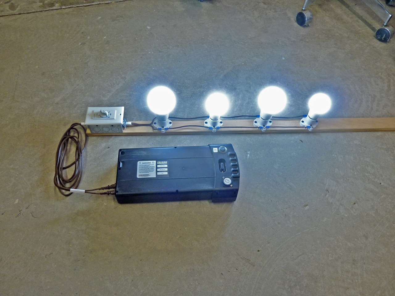

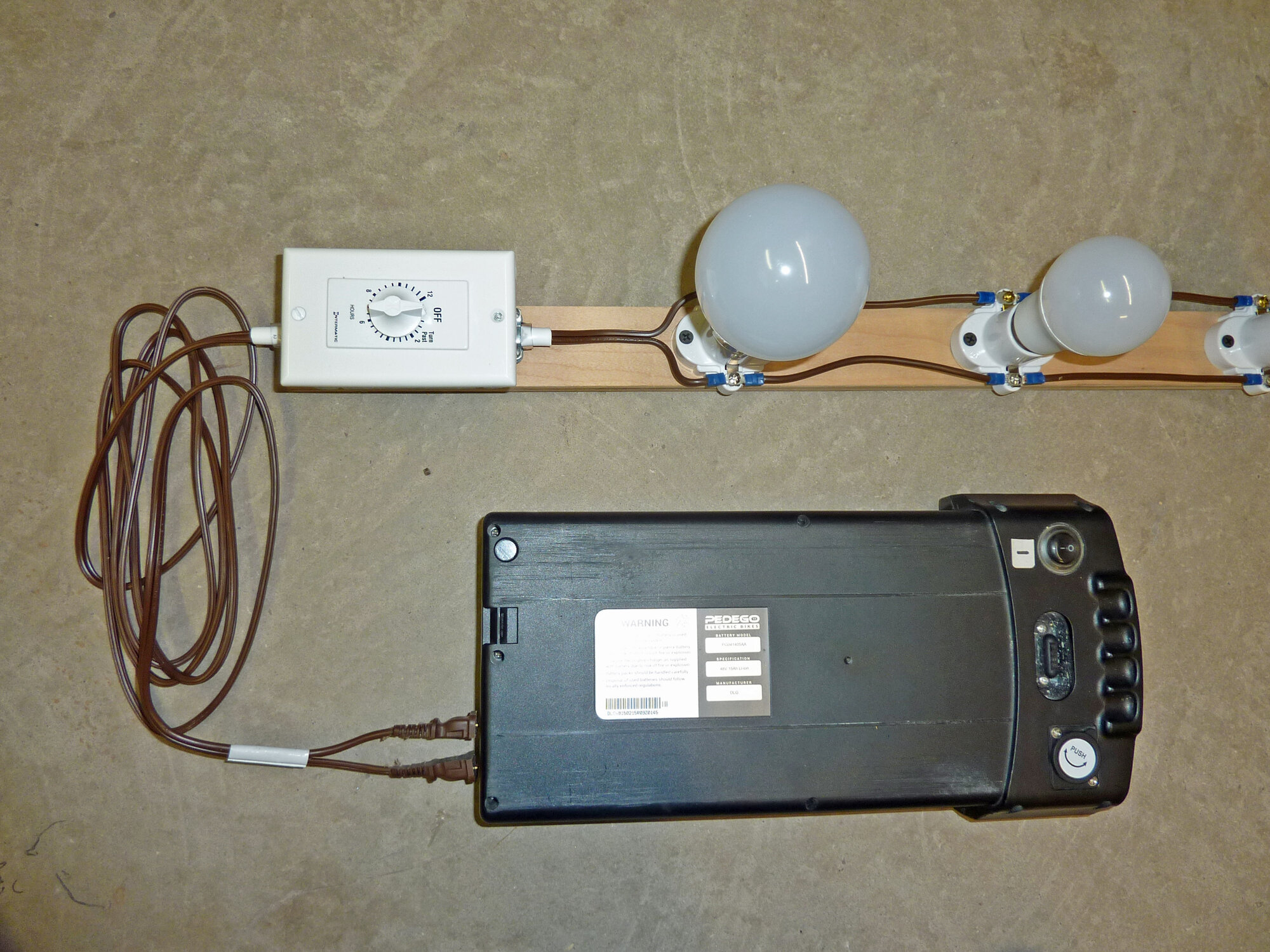

I use 60V LED bulbs for a discharge rig. That way, the setup does double duty as a light source during the frequent power outages we get.
I added a twist timer so it's set & forget

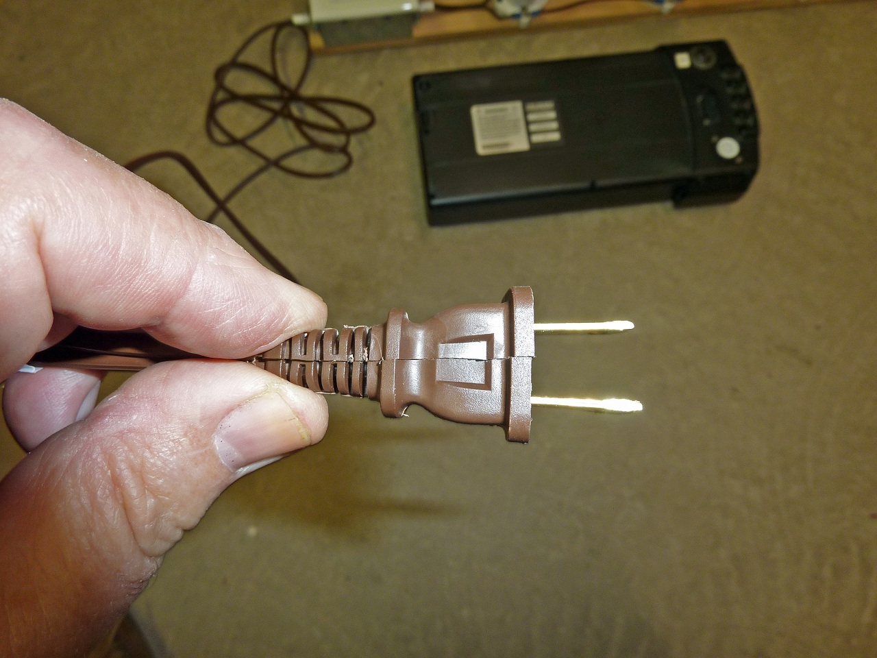

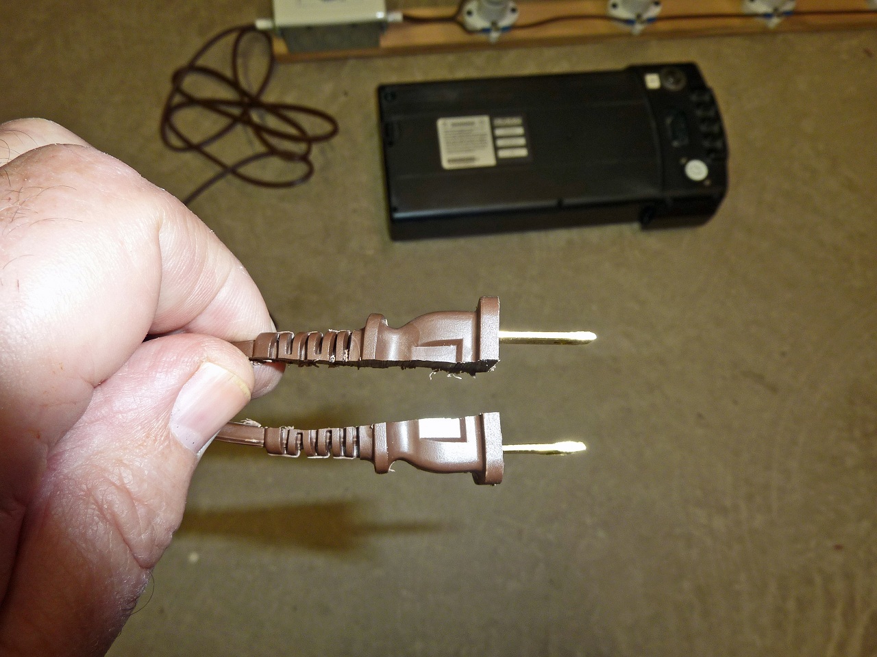

For batteries with flat spade terminals, it's easy to make a connector out of an old extension cord. Just cut the plug in half as shown:

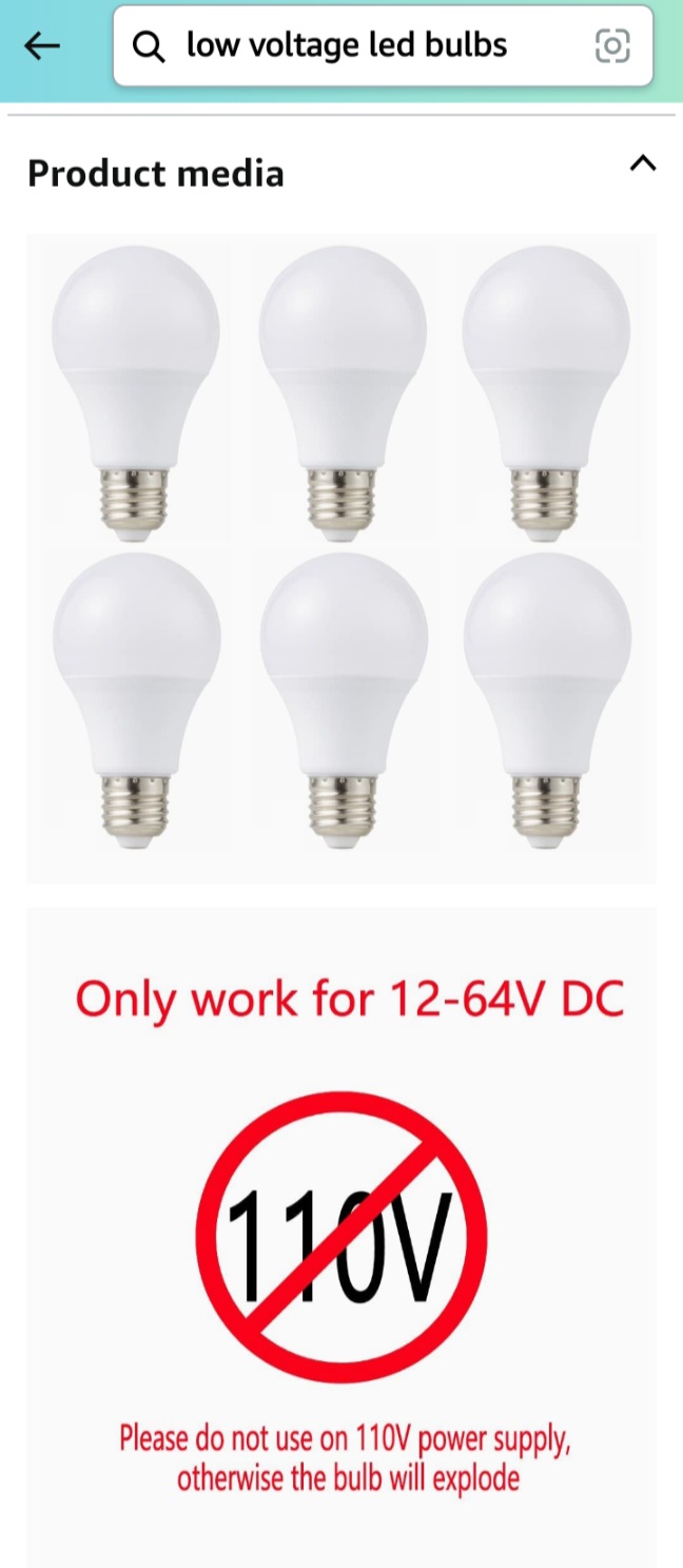

Do you mean 60 Watt LED bulbs?
All my LED bulbs are 120 Volts, most are 60 Watt equivalent and are actually 10 Watts.
Are your bulbs actually 60 Volts?
Will they operate from what I assume is 48 Volt battery?

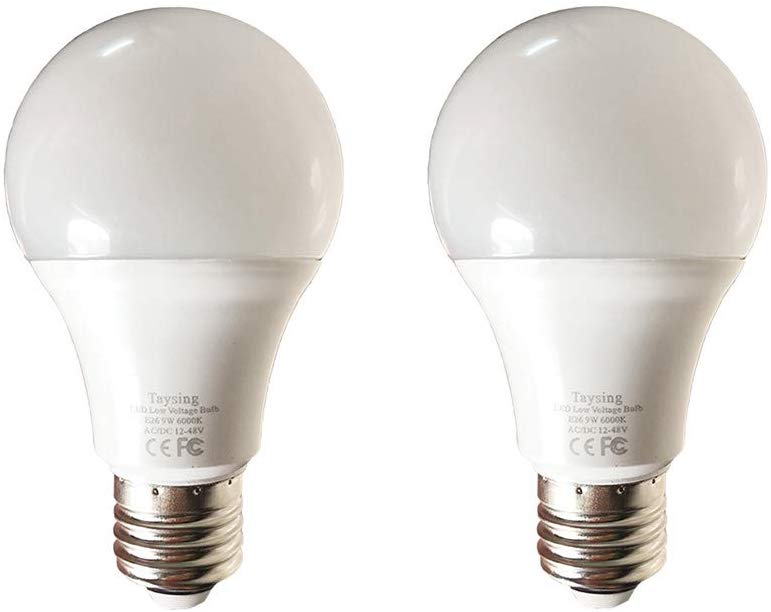

They are actually rated at 12 to 48V but will operate on 60V as well:
They are just 15 watts each but I leave them connected for several hours to get the charge level I want. It's easy to do with the twist timer. I have no need for a fast discharge rate and the lower wattage is better for the battery.

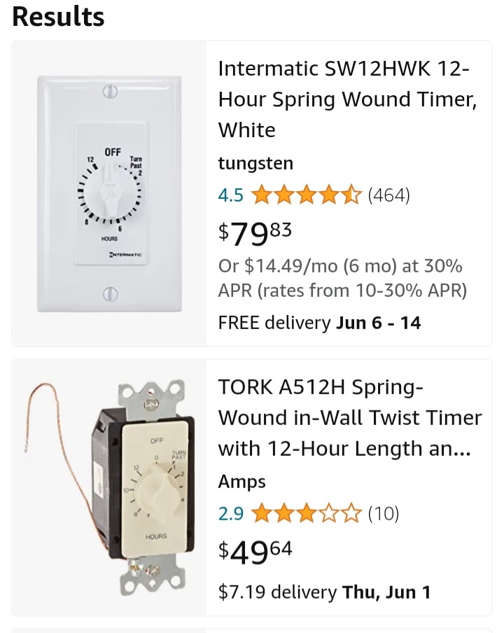

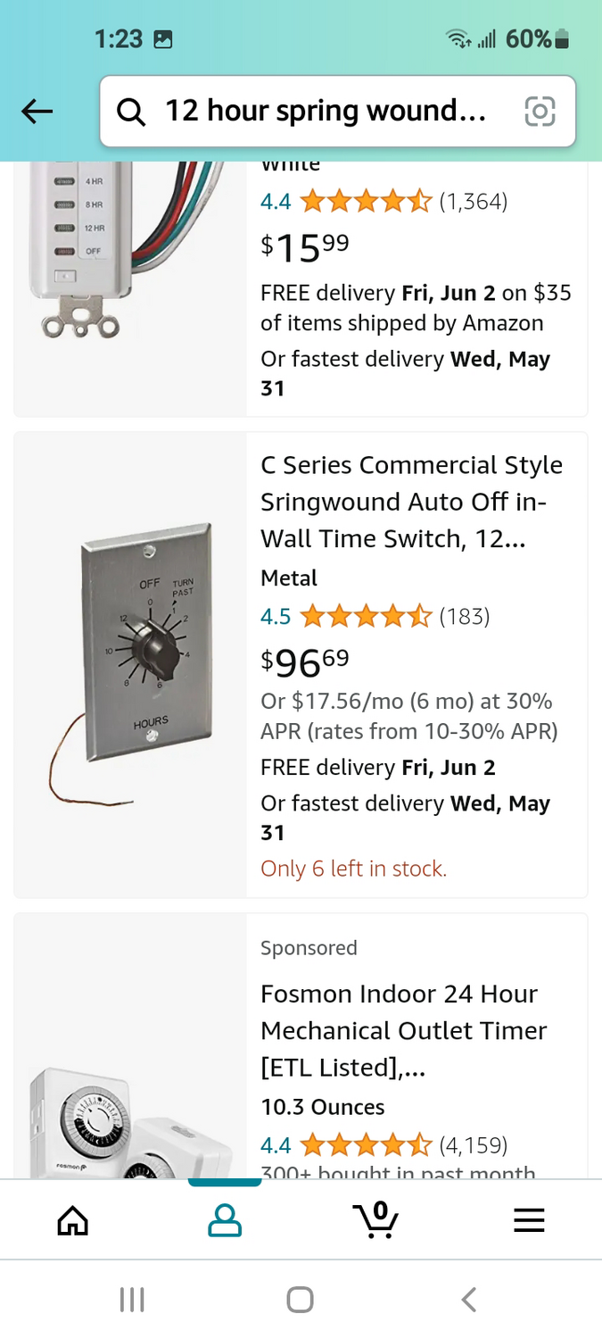

The in wall 12 hour spring wound timers can get really expensive, so you need to consider the ramifications if it fails to shut off.
This is well worth the $15 in my opinion, but you need to use an extension cord.

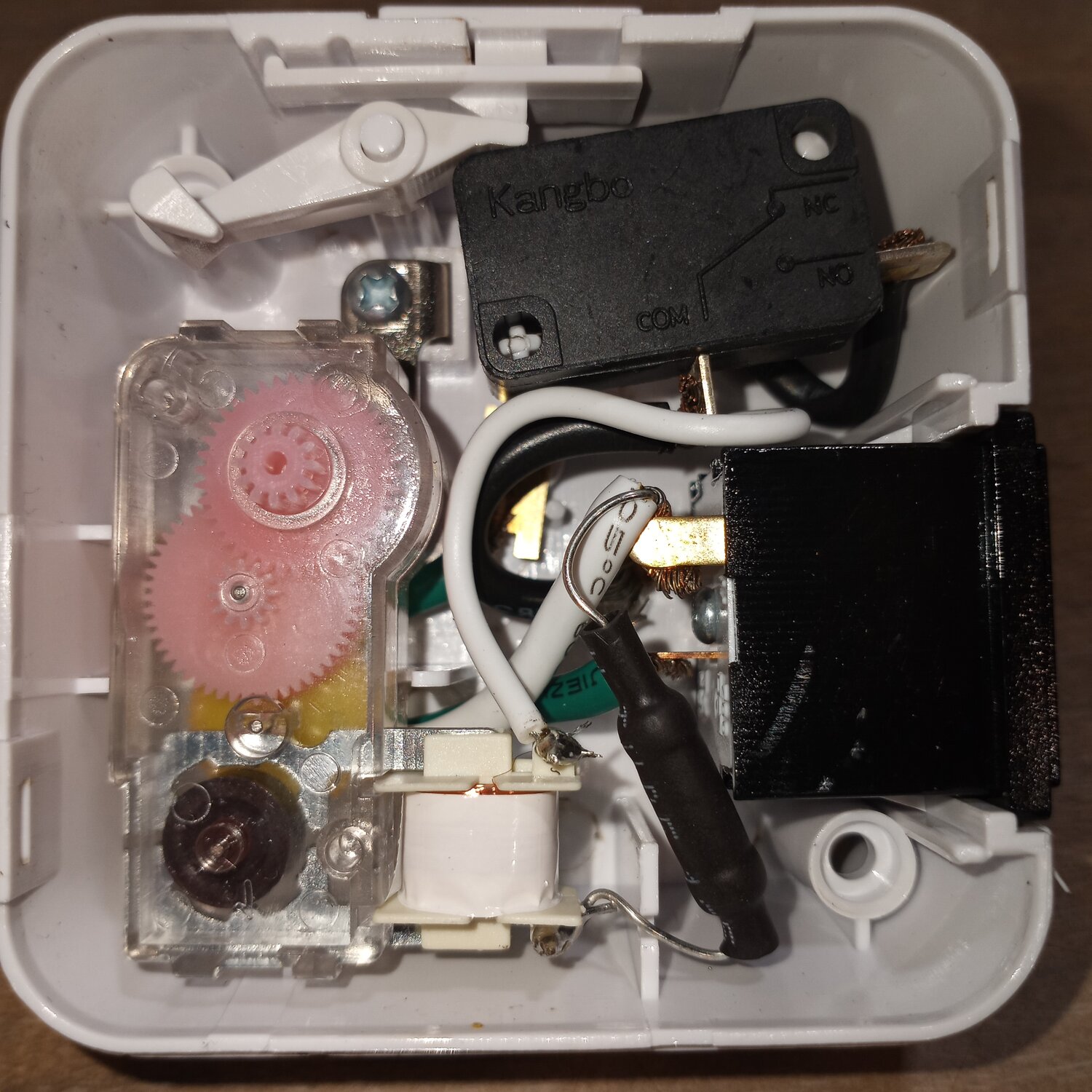

As far as I figure it, a failure could occur if the switch is switching high power and the contacts of the switch fuse/weld together.
Then it won't turn off.
The surge current of a charger can be HUGE !!

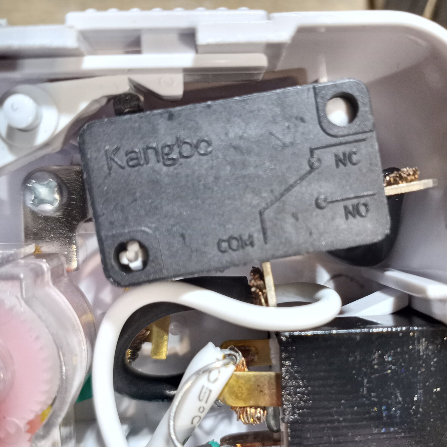

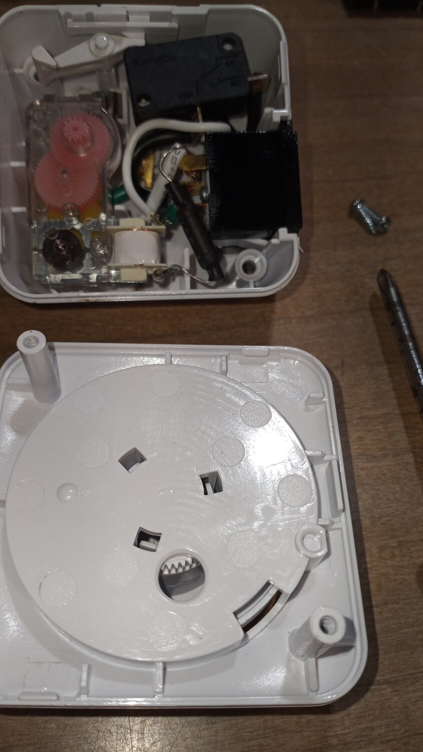

I decided to take my new timer/switch apart,..
So, all that possible arching, sparking and potential HUGE surge current is going through this tiny little micro switch.
I dunno ??
Seems a bit under rated for what a battery charger might demand?

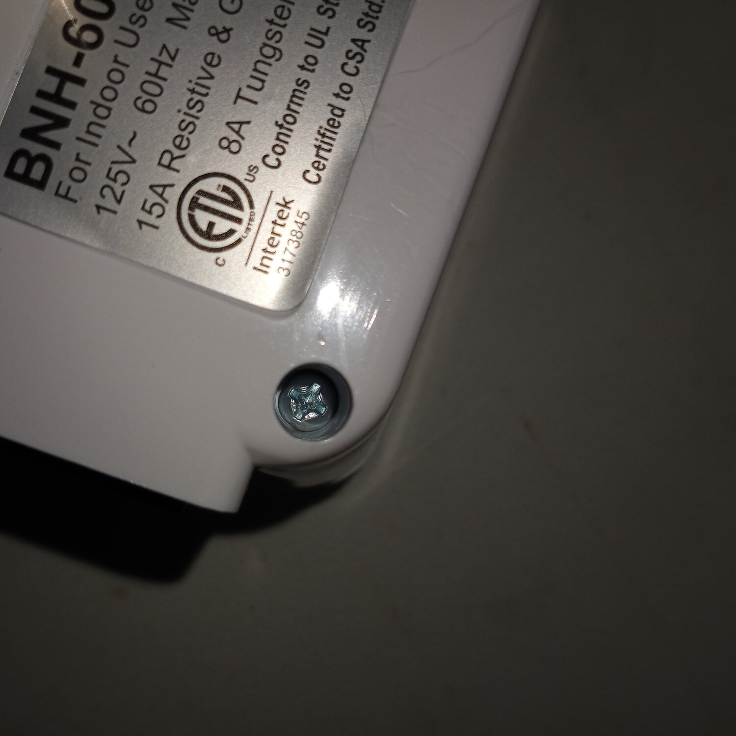

It says that it's rated 15 amps, 8 amp tungsten.
Should I trust it ??

It's welded closed that concerns me where it won't shut off.
That's hit and miss, because the contacts tend to be spring loaded.
If the spring isn't strong enough to break the weld, then it won't shut off.
That could happen at any time.
Or maybe never??
