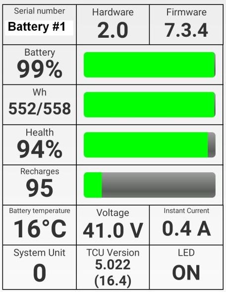

Battery #1.
The only important data here is the actual battery capacity, which is now 558 Wh. (Neither the number of recharges or "Health" figure can be totally trusted because of historical reasons).

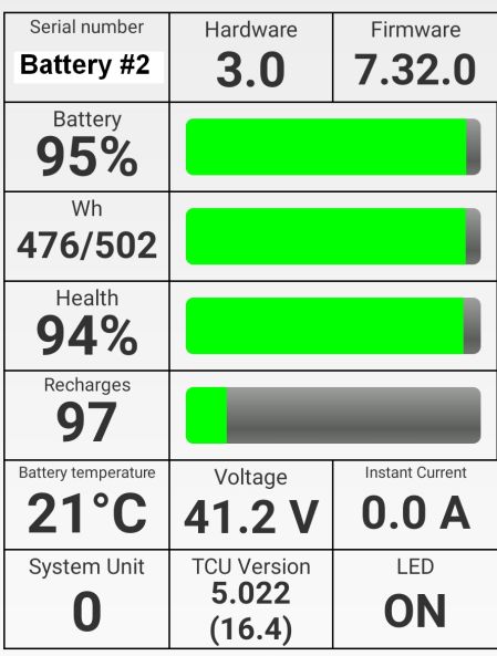

Battery #2. Although that battery was bought later, its full charge is only 502 Wh now!
Note: Mission Control will never tell you the truth: It seems that the Battery Health is always at 100% there!

Why do I say at least one of the chargers behaves strangely? It is because it never starts balancing of the cells, even if the battery is not at 100%! The charger #1 always helps re-charging the batteries to 100% but the #2 does not!
See the charge of both batteries above. The Battery #1 was recharged with the Charger #1. It offers 552 Wh of 558 available. However, the Battery #2 got only charged to 95%! With its low current capacity of 502 Wh, it only held 476 Wh of the charge! Now, fancy I were to set off for a very long ride with the batteries not fully charged...
As I have identified Chargers #1 and #2, now I always force the Battery #2 to be fully charged with the Charger #1.
