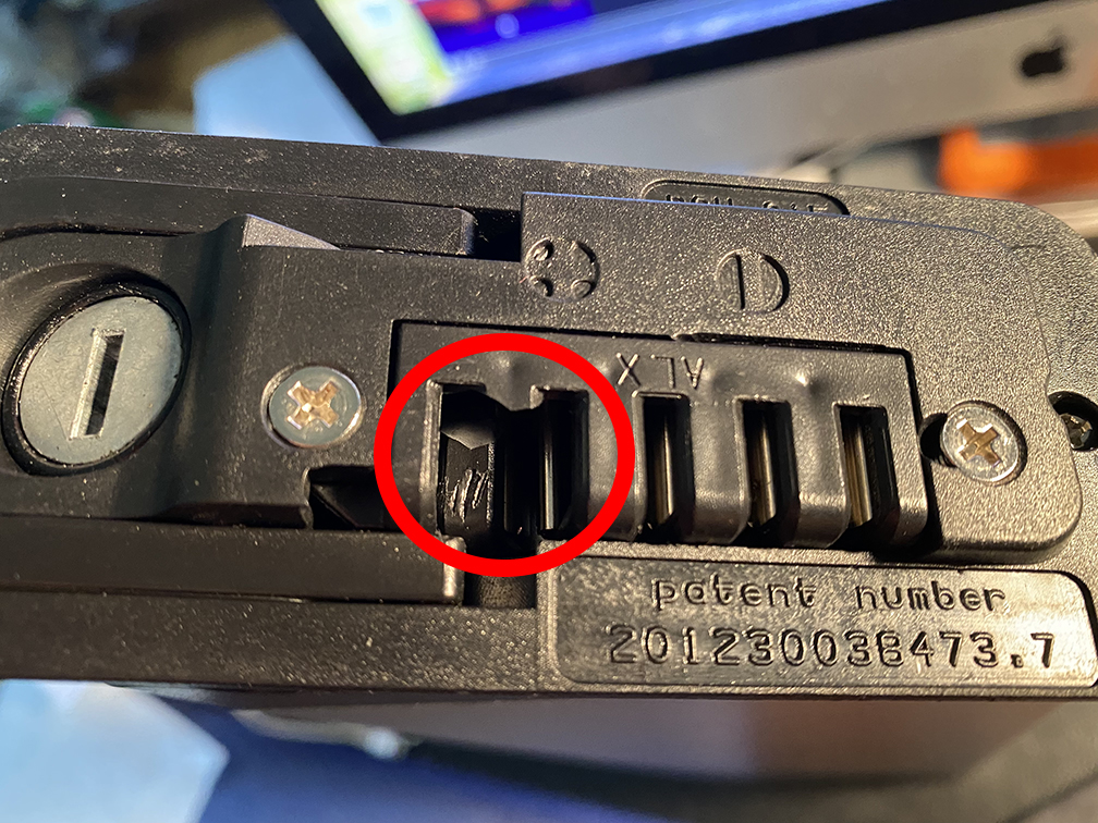

I have indeed been in contact with Wallke and they gave me instructions on what I needed to do to test the battery. In following their instructions, I found what the problem was. One of the terminals on the battery broke. With the bike folded in half, it must have shifted and hit something during transport.
The photograph should explain it…
I have ordered a new battery and will eventually buy a new Battery Head for my broken one. They have given me instructions on how to replace that battery head.
Hopefully, that will take care of everything.
