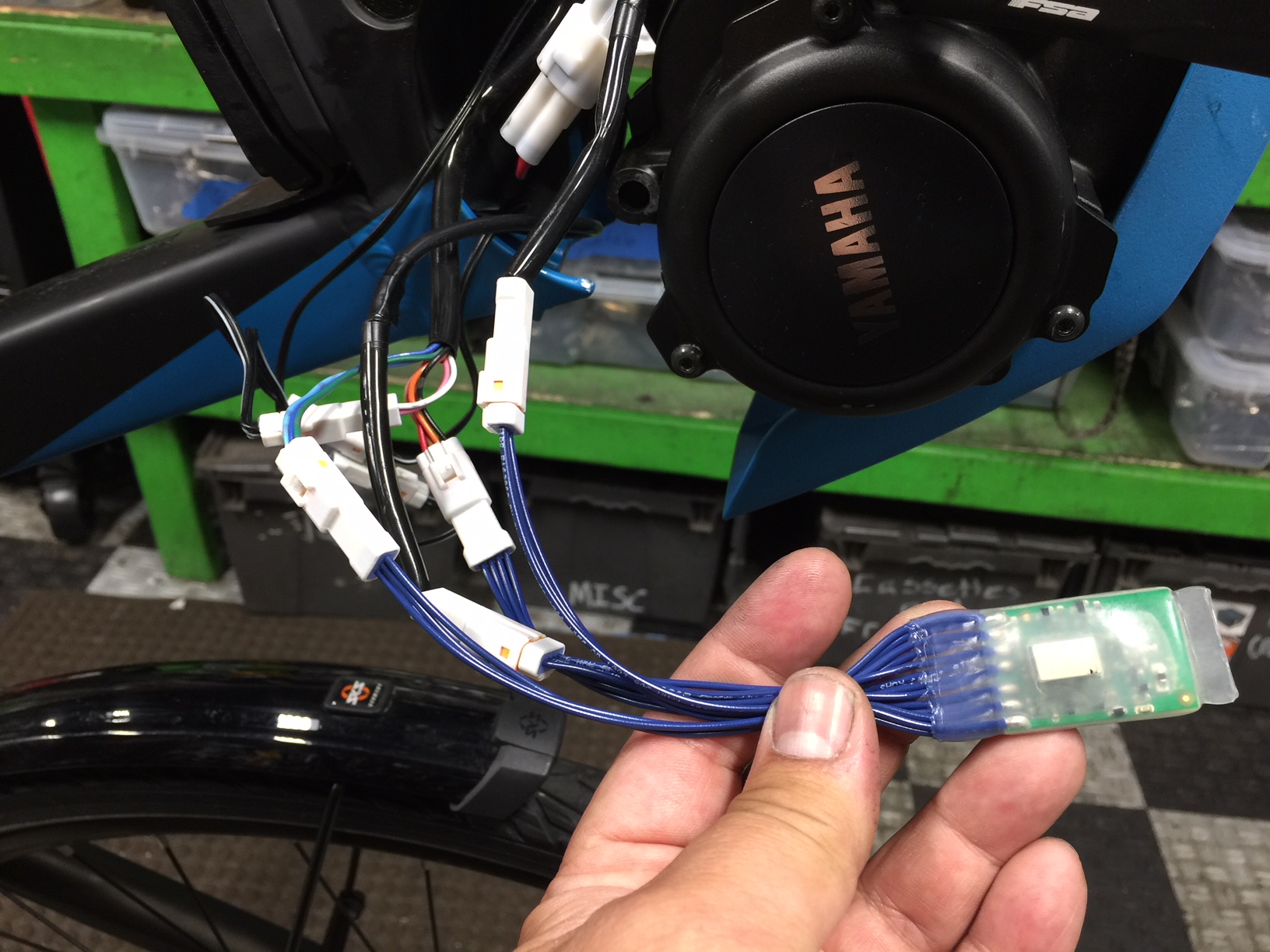

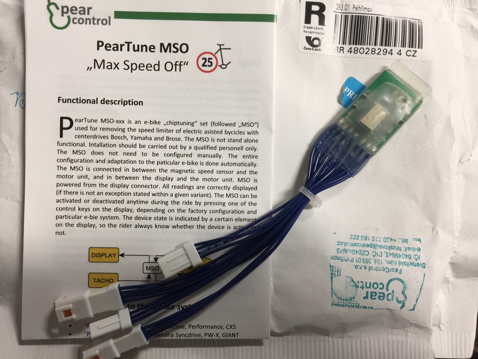

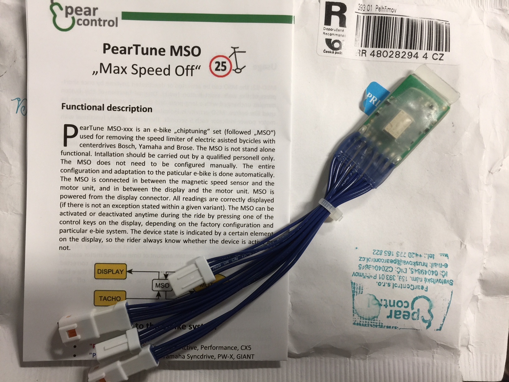

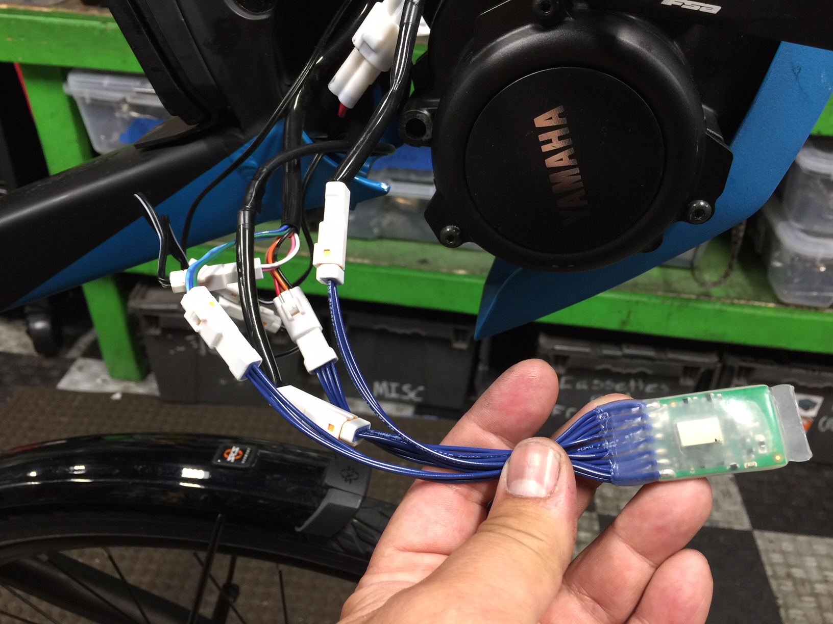

I moved the button pad from the left shifter/grip area up to the front of the bar, next to the light. So now I have room for my hands inboard of the shifters, giving me four different hand positions in total. If feels great! Especially since I received and installed a PearTune MSO module a few days ago. The verdict on the PearTune MSO? It works! It was an easy install, but the motor on my bike will not swing down after removing two of the motor mounting bolts, which is what the instructions and installations videos I have seen call for...I have to remove all three bolts. Other than that, it is relatively straightforward, although plugging it in is ever-so-slightly confusing.
The PearTune MSO activates with a short press of the walk mode button (which is normally disabled on my bike; you can also choose a version which is activated by the light button). The assist level indicator on the display flashes to let you know it is active. I don't know what the upper speed limit is; I personally run out of steam at 32 mph. Other than that, I can ride cruise at 22 mph, and 26-27 mph at a harder pace.
View attachment 22768View attachment 22769
I have one ebike that can go more than 30 mph and the other at 26 mph. However, I don't really see a difference on normal riding since I ride at about 21-22 mph on the upper limit of my cruising speed (good compromise between speed and battery consumption). I only explore the top speed if it is a slight downhill.
