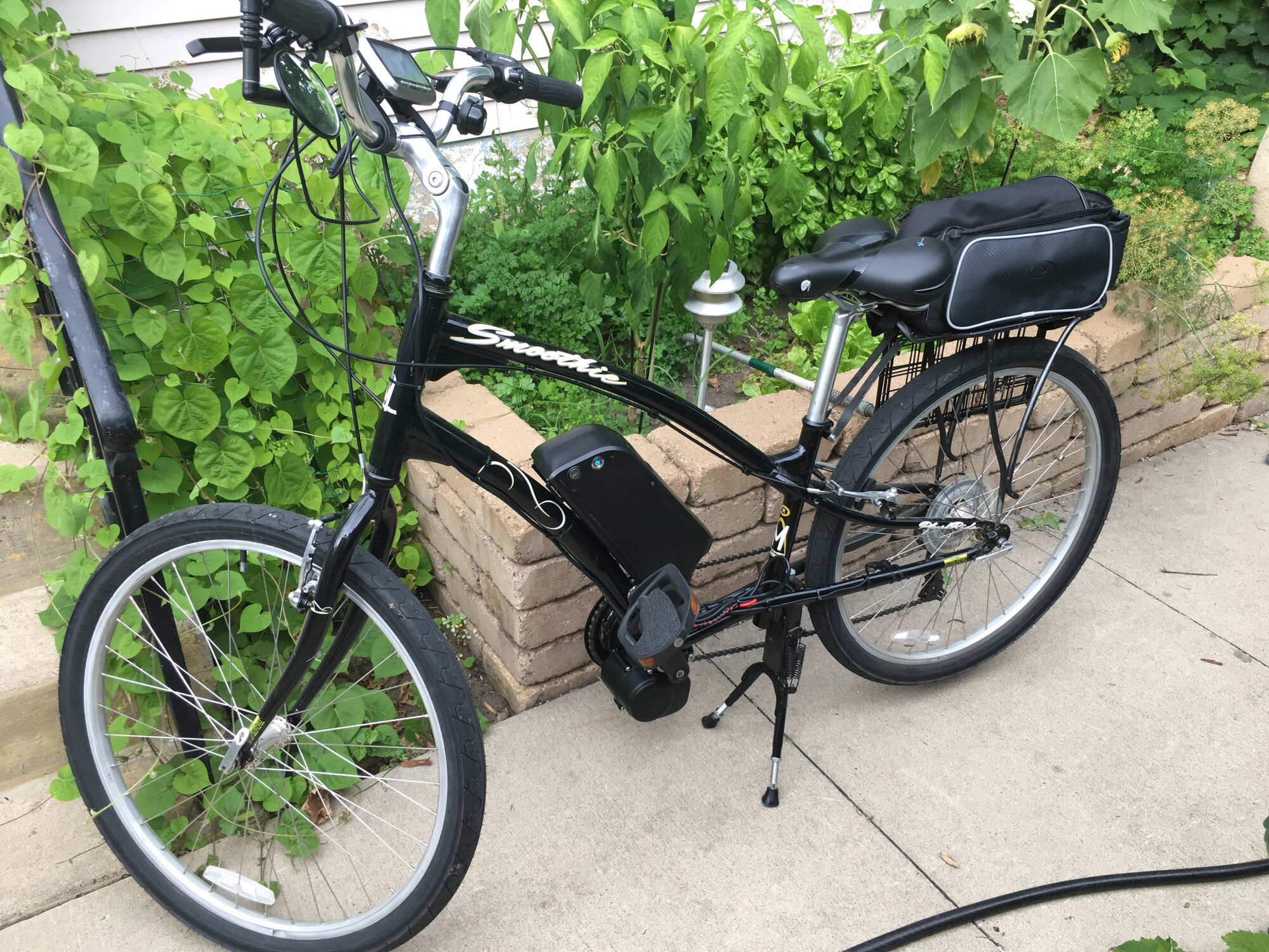

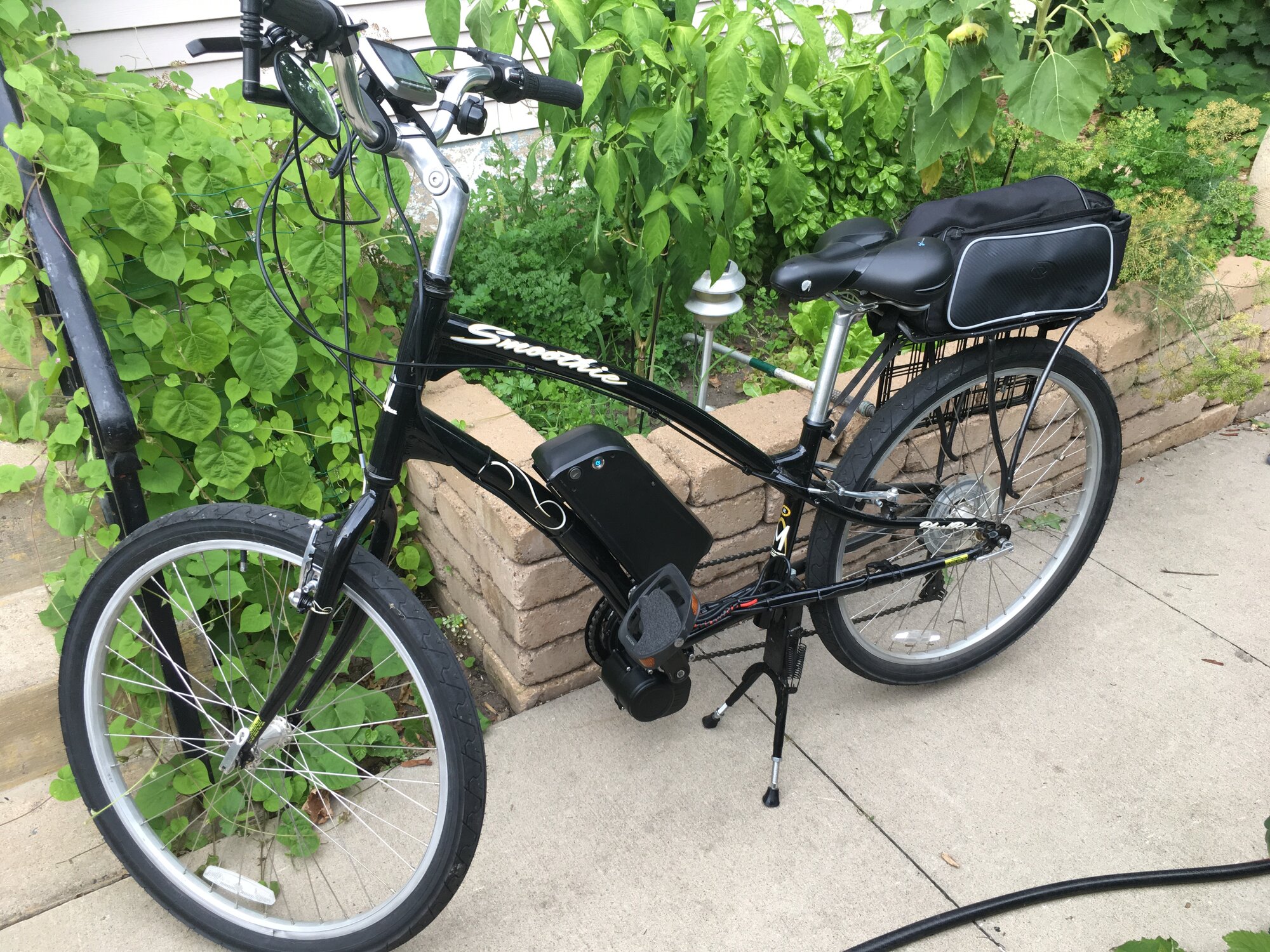

Being a gimp and unable to assume a road bike position I opted for crank forward frames like the Townie. I kitted my first flat foot frame with a 350W mid-drive and one with a TSDZ2. SUPER comfortable.
KHS Smoothie crank forward
small frame TSDZ2.
