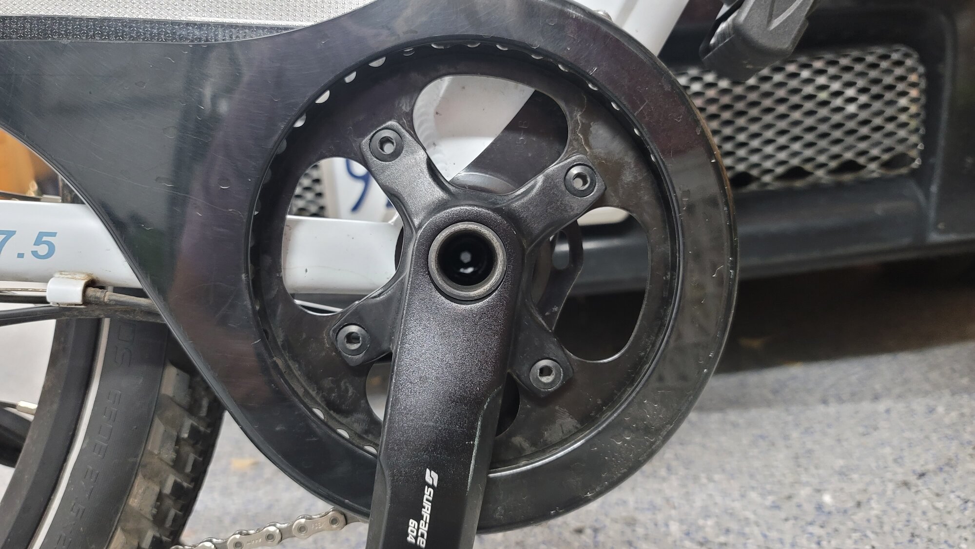

Last month, the bottom bracket (BB) on my 2023 V Rook started making noise — a rapid series of 3-4 clicks on each full turn of the crank. The bike's was only 7 months and 1,200 mi old when it started. Sounds like @bascherz may have had a similar problem.
The noise takes a mile or so to start up but then lasts the rest of the ride. It only occurs on the left pedal downstroke — nothing if I push only on the right pedal. New pedals made no difference.
The noise always syncs 1:1 with crank rotation but never with any other part of the drivetrain, so it can't be coming from the wheels, chain, derailleur, or cassette — the last 3 of which were upgraded 2 months ago.
Since the pedals have been ruled out, that timing leaves only the cranks, chainring, or BB. But chainring's in good shape, and the chainring and cranks are tight with no impingement. That pretty much leaves the BB.
LBS/dealer agreed, inspected the BB, and said they "rebuilt" it. But the noise returned the next day. Sounds like some bad bearings to me, but I'm no expert.
Q1. Time for a new BB?
Q2. Warranty item or normal wear and tear at only 1,200 miles?
Thanks!
If you have the tools replacing crankshaft and bearings on the bottom bracket is pretty easy and not too expensive. The bearings and shaft come in a cartridge. One would need to know the width of the BB. I assume that the bike is built of standard bike components.
My experience is clicking noise coming from the pedal crank arms at the crankshaft, usually on the sprocket side. . That would be on the square taper kind and everything before. Once that starts you probably need new crank arms. A retightening doesn't seem to work out long run.

Thanks! Crank spindle is round and hollow, as in photo above. The fact that the noise only occurs with a certain minimum downforce on the left peddle — and only when it's at 2-4 o'clock as seen from the drive side — certainly makes the left crank arm a prime suspect at this juncture. But LBS said the crank arms are OK.
