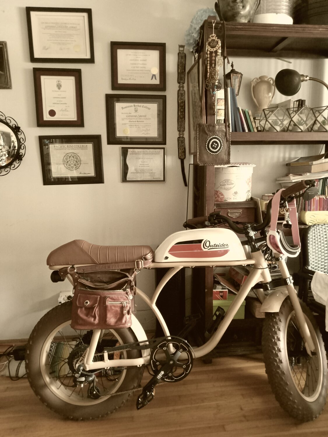

I love my Outsider although I am a little too short for it. I wear my platform boots and try not to stop on hills.
Hi, I own an Outsider. I love the way it looks (that's almost why I bought it) but it's always problems since I bought it last year. My current problem is electric motor does not start no matter what I do. Battery is full, I try every power level (1 to 5) but nothing works. This is the third or fourth time it happened so I'm not even taking to the store on warranty because they don't seem to know what they're doing. Another thing: after I turn it on a grey light starts blinking under the stoplight. I can see this problem is about a sensor / switch which powers on the engine after sensing that the pedals are turning but I don't know how to correct it. If you guys have any idea please help. Many thanks.
Have you checked that the battery under the hood has not dislodged from its cradle? If this is your issue, it was mine as well. I found that downward slopes and bumps would knock the battery out of its cradle and become unplugged. You have to go under the hood and place it back in. It should start for you.
I don't know why this happens with the Outsider battery position and not on rides such as the Super 73. I don't know if other bikes with the battery in the same position does this. However, if I were to choose having this issue on the downward slope or an upward slope, I would rather it happen on the down as you have breaks. I think it would be dangerous beyond belief to have a dislodge of the battery happen while riding upwards.
I hope that the issue is a simple fix for you. What I did was velcro a strap length wise across the battery to keep it more firmly in place. The included cloth strap across the width of the battery is not enough to keep it in place. Dollar store fix.
