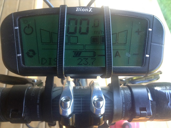

I had a recurring problem with my D-500 motor cutting off on bumpy roads. The console would go dark after a bump for just a short moment and then come back on at zero assist. Occasionally there would be an error code. I Googled the issue and found that several other riders have reported the same shut down. My dealer suspected a faulty cable connector. He replaced the battery docking station which included all new cables. That did not fix it.
I finally discovered that the G2 console was jiggling ever so slightly in its mounting dock even when clicked in completely, briefly breaking electrical contact after sharp bumps on an unsuspended touring bike. Perhaps this problem has been addressed with the newer RC3 console but the G2 works better with my drop bar bike. Here's my fix, two wire ties. Partially blocks the screen but I can see what I need to see...
I finally discovered that the G2 console was jiggling ever so slightly in its mounting dock even when clicked in completely, briefly breaking electrical contact after sharp bumps on an unsuspended touring bike. Perhaps this problem has been addressed with the newer RC3 console but the G2 works better with my drop bar bike. Here's my fix, two wire ties. Partially blocks the screen but I can see what I need to see...View attachment 18993

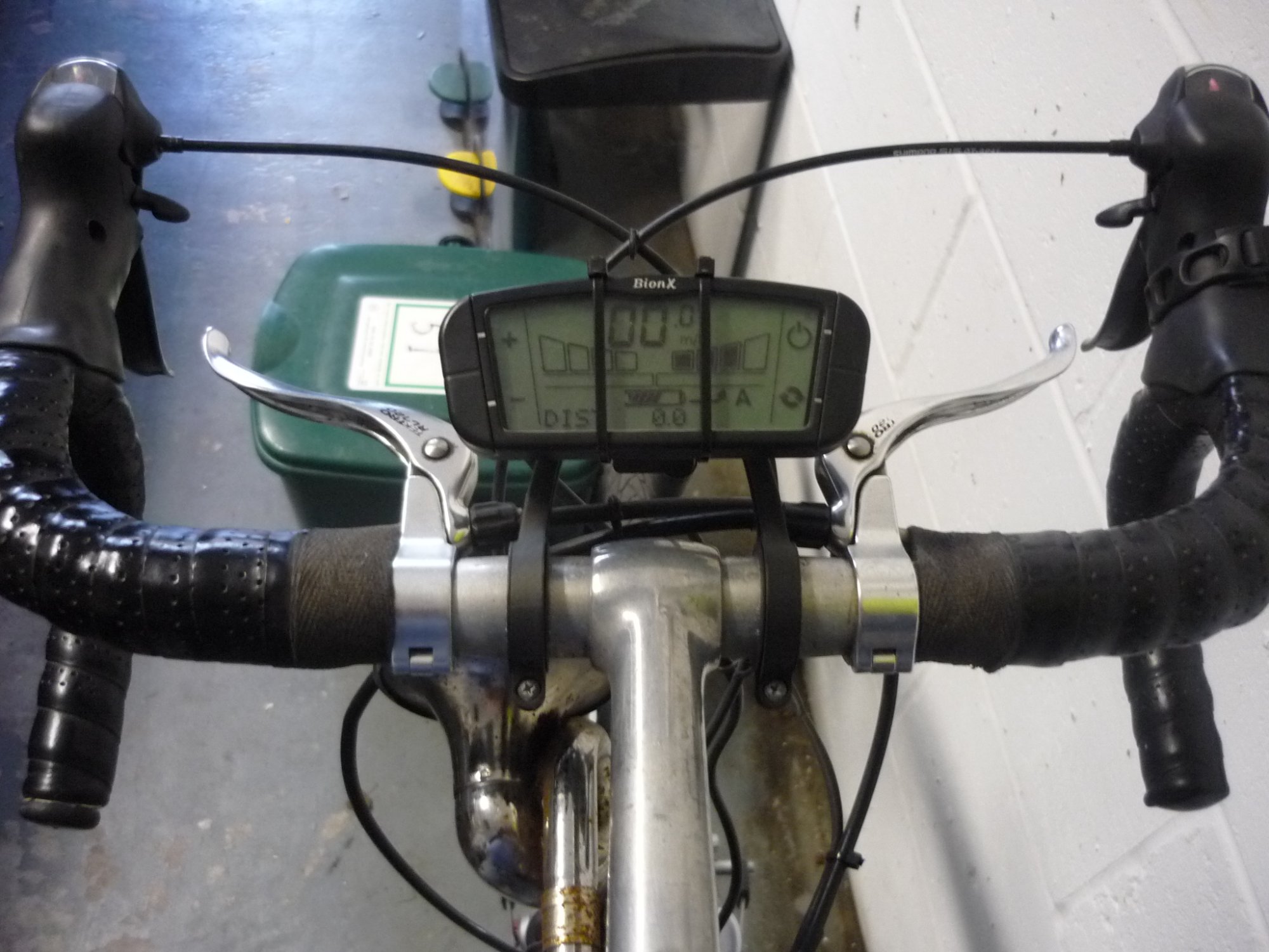

I had the same problem with my Bionx system shutting down when I ride over a very bumpy surface with my touring bike (unsuspended). This has plagued me for around a year gradually getting worse and I have already replaced the battery dock and cables from the docking station. I followed with your advice and my G2 controller is now secured with two cable ties. It has worked a treat and I have never had an unexpected shutdown since whereas before it was a twice nightly occurrence.
I see that your setup is identical to mine with the G2 controller secured in the centre of the drop bar and I see that like myself you have secondary brake levers fitted which are the same make as on my own bike. After an accident where I went over the handlebars ten years ago I consider the auxiliary or secondary brake levers to be essential on a dropped handlebar. Weinmann of Germany did a neat solution back in the 1970's which is no longer produced but proved to be a life saver on several occasions with my previous touring bike.
