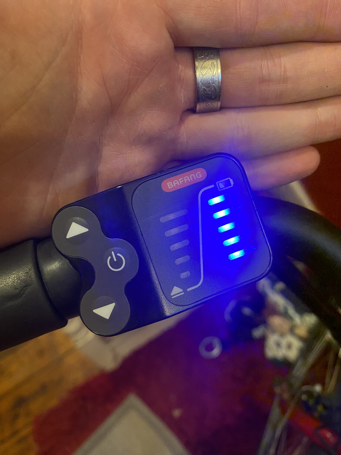

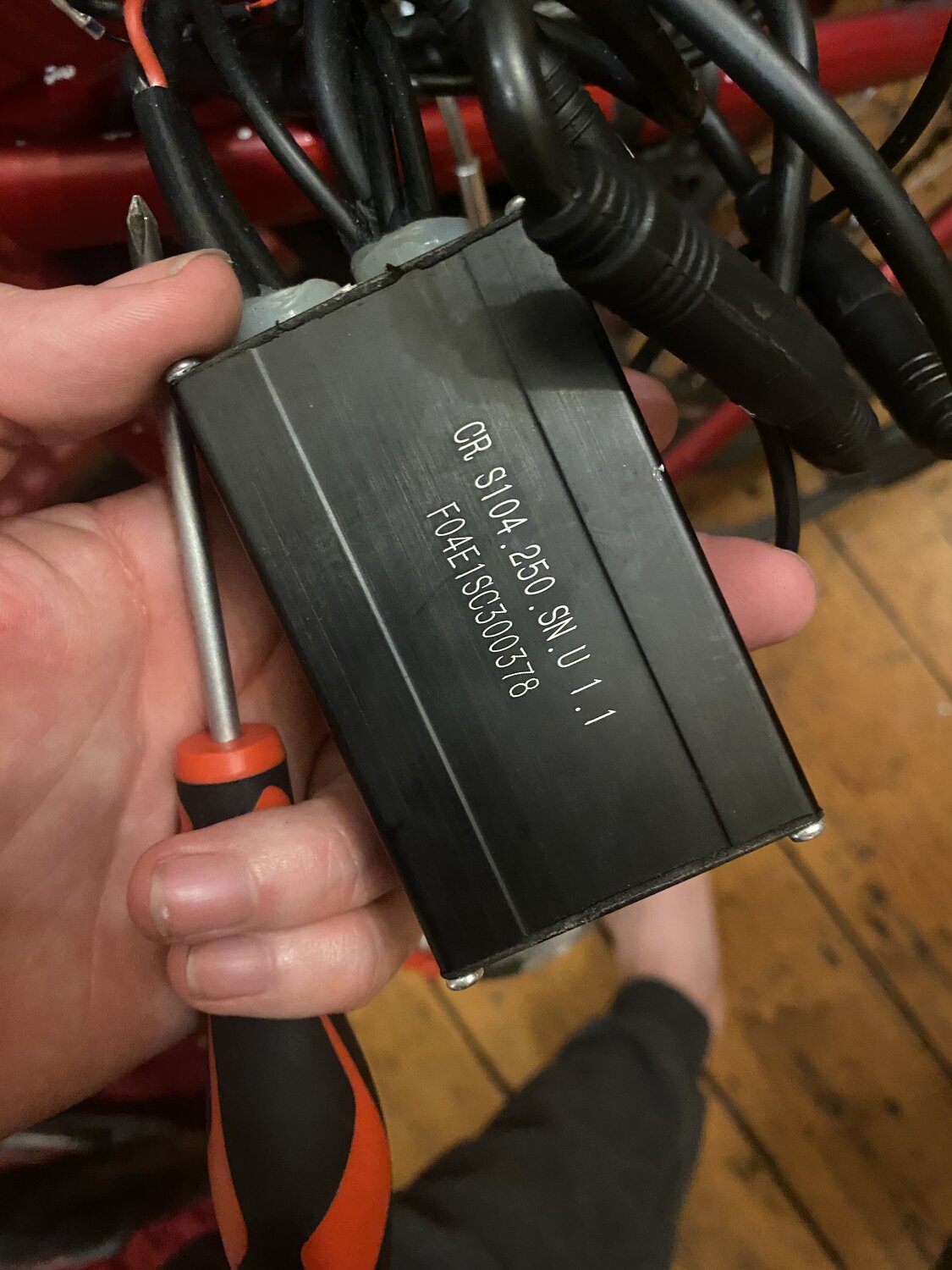

Hi guys - I have an Ebike powered by a 36V bafang cr s104.250.sn
was working great for over 2 years but has now developed an issue
when you power it on the battery and power indicators light up as normal but after 10 seconds the power indicator drops to 0 and flashes - the bike produces no power and the buttons to turn up the power don’t respond once it hits 0
I have tested the battery and it seems fine holding stable at 42V fully charged (I’ve replaced cells in previous e bikes so it doesn’t seem to me as a dead cell anyway)
anyone have any ideas what would cause this ?
I assume it’s either going to be battery/controller/motor or a sensor issue
any help would be much appreciated
regards
Ben

I have disconnected and reconnected all the connections to the controller (none look corroded or dirty)
the battery has been in and out a few times while testing the cells so I assume that connection is okay too
the issue is very consistent

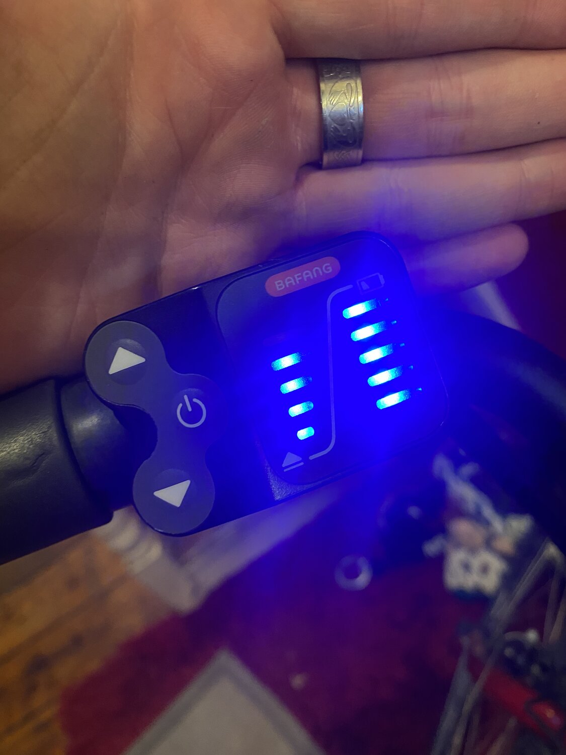

You power on the bike
Both meters light up and you can move the power meter with the buttons
after 10 seconds the power meter goes down to 0 and then flashes the bottom light 4-5 times and then goes off and the up and down buttons are then unable to raise the power
the battery status stays powered and doesn’t change

That has to be really frustrating. Ive not seen that particular display on the many bafangs i´ve
looked at; what bike have you? It looks like a very cheap display. Since your battery & connects
seem fine it may be in the display. Moisture can get into a display & reek havoc. Then too, the
cold could possibly have cracked a fragile connect either in the display or battery circuit board?
Did you see any sign of bleed or corrosion on the controller? Error codes can be searched online;
many are model specific. Pretty obvious the display can´t post an error code, but you might check
for codes & troubleshoot online, Sry I can´t be of more help.
