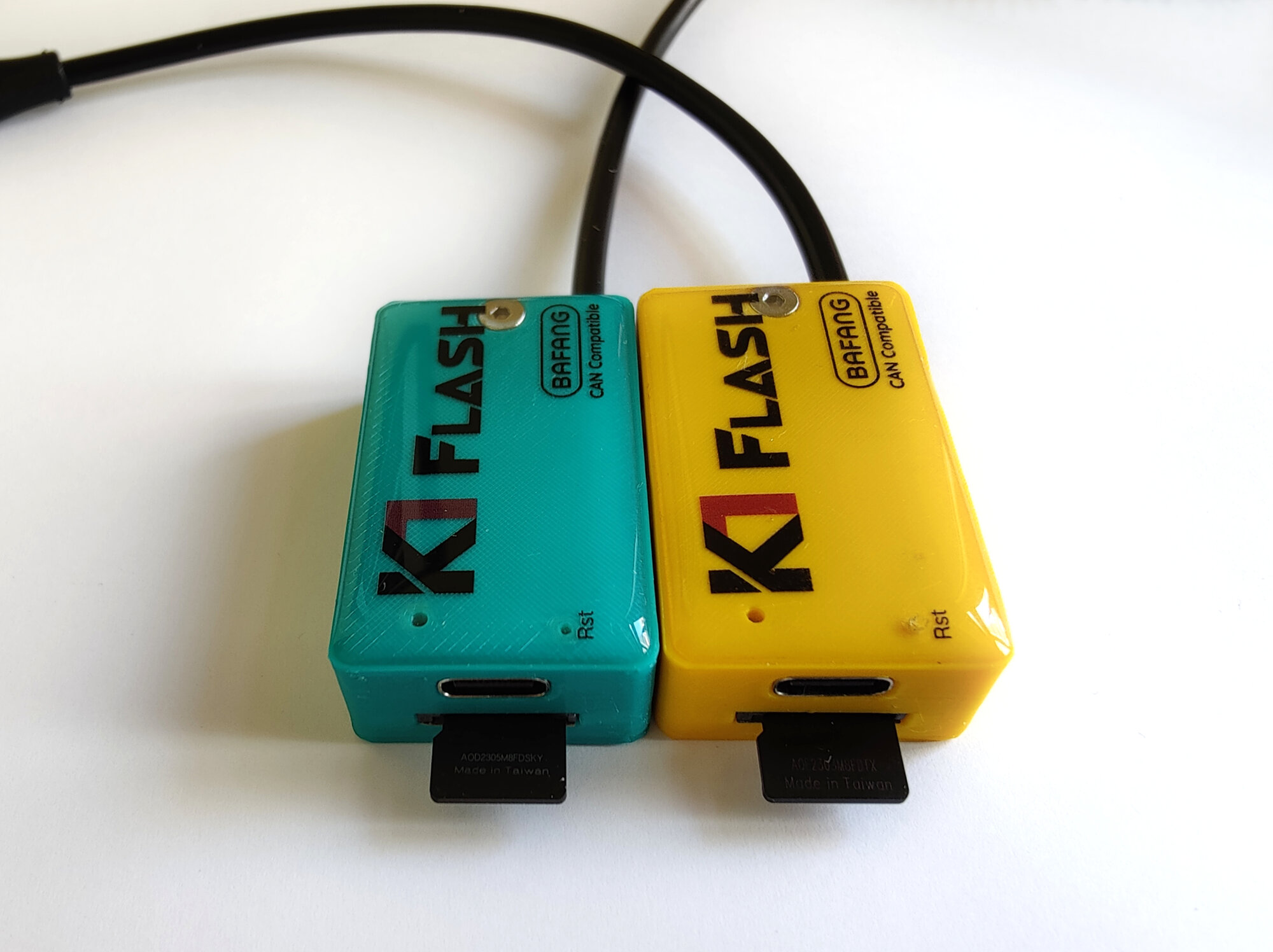

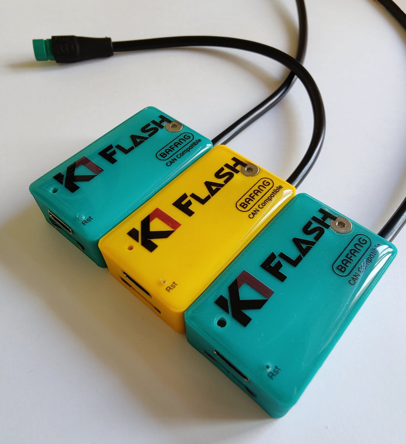

Dear Bafang fans
Would you like to set or tune motor controller parameters? K1 Flash is compatible with all Bafang CAN bus motors (5 pin connector with "house" shape).
Also can update motor firmware for M500, M510, M560, M600, M620 and M820 motors and run rotor Calibration.
Simple as 1, 2 ,3 ...

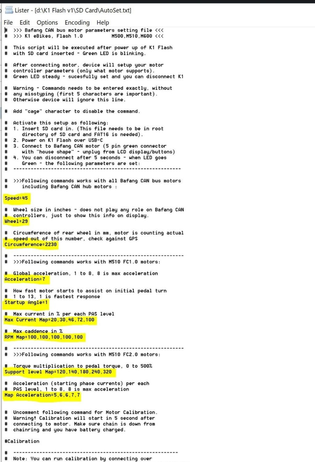

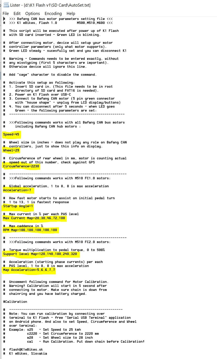

1. Insert included SD card (with set of firmwares - cca 120 firmwares)

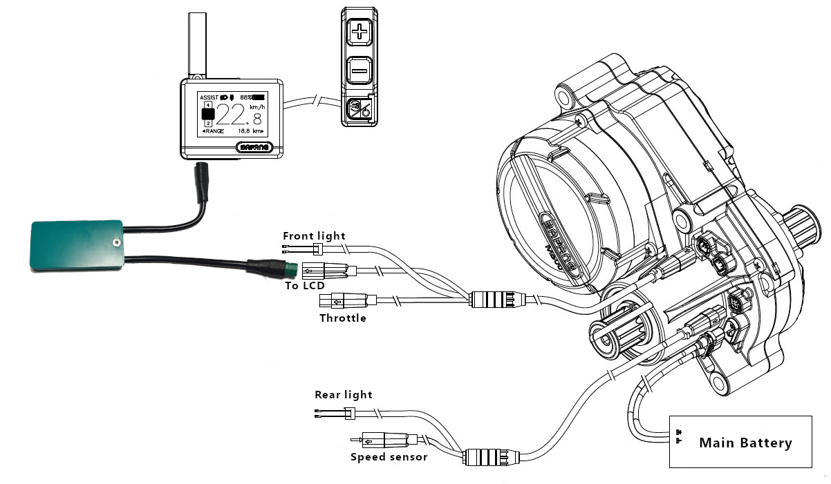

2. Power up K1 Flash (over USB-C cable from your mobile, power bank, charger ...)
3. Connect to your CAN motor - steady green LED light means all set and you can unplug device
In a minute your motor is flashed and parameters set according setup text file on SD card.
More info, pictures, videos and ordering info at page:
www.k1ebikes.com/k1flash

Tested on M500, M600 rev.A and B, M510 FC1.0 and FC2.x M560, M620, M820, M420, M400, M300
Speed unlock, Circumference, Wheel size supported by all Bafang CAN motors, including CAN Hub Bafang motors.
K1 Flash Lite (no firmware flash function) starting from 110 Eur including shipping in EU.

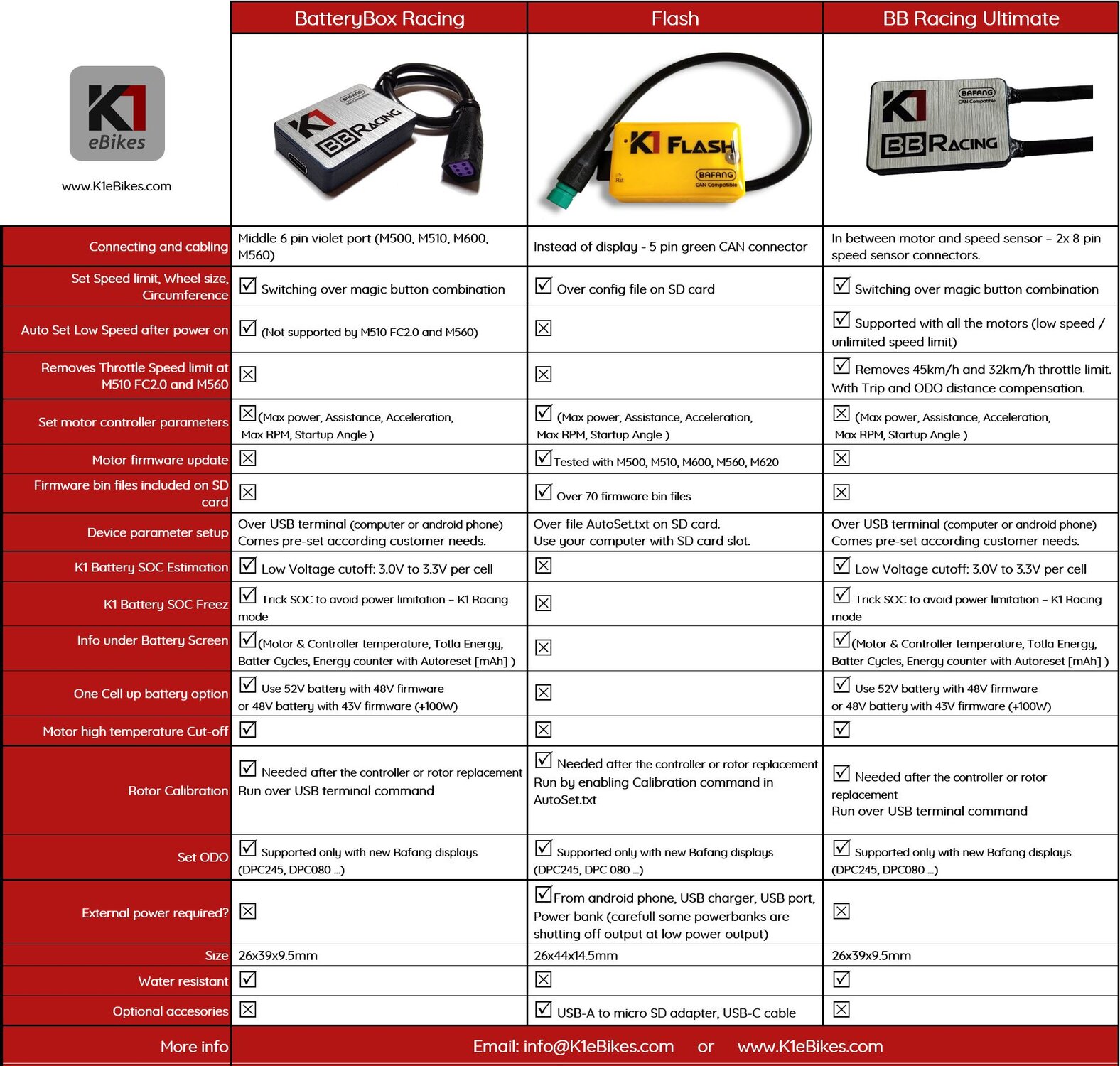

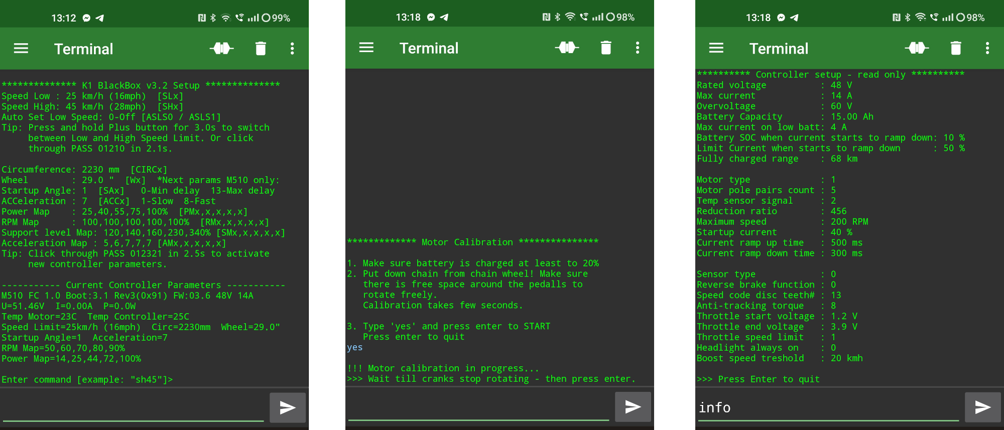

And advantages:
- No need to get BESST, passwords to Besst (which expiring), no need to connect to computer and u can flash firmware and set parameters even on a street or during ride when u searching your power setup.
- No need to search for a firmwares on forums. Time is money.
- Simple firmware flash also for non skilled people - just insert included SD card, power up K1 Flash over USB-C and connect CAN connector - device will automatically select firmware from card according the motor type.
- You can set speed limits as u want. With Besst it is now disabled - I can set only 27kmh over Besst. Also other advanced power parameters (M510, M560)
- Calibration run - when u replaced controller.
- Also great for ebike shops - you can flash firmware, set config parameters and run Calibration in one go. You are done in one minute. You can have more SD cards for different motors and setups.
Not gonna explaining you differences between firmwares. There is a lot of differences in behaviour and setup.
If you wanna criticise, and you think no big deal here, just leave it and buy BESST.

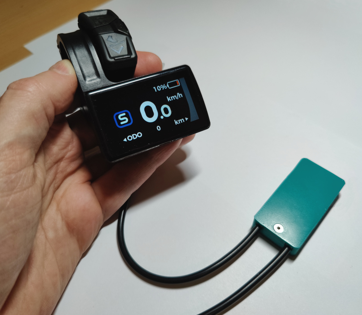

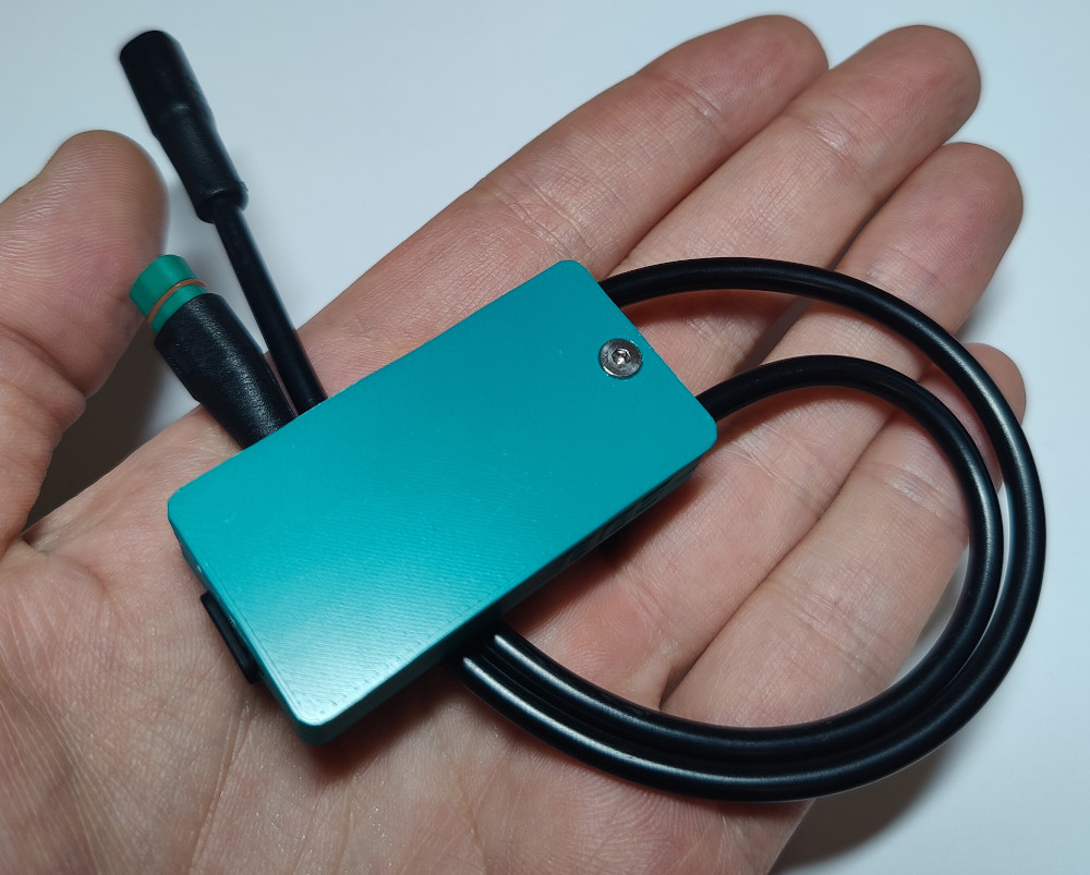

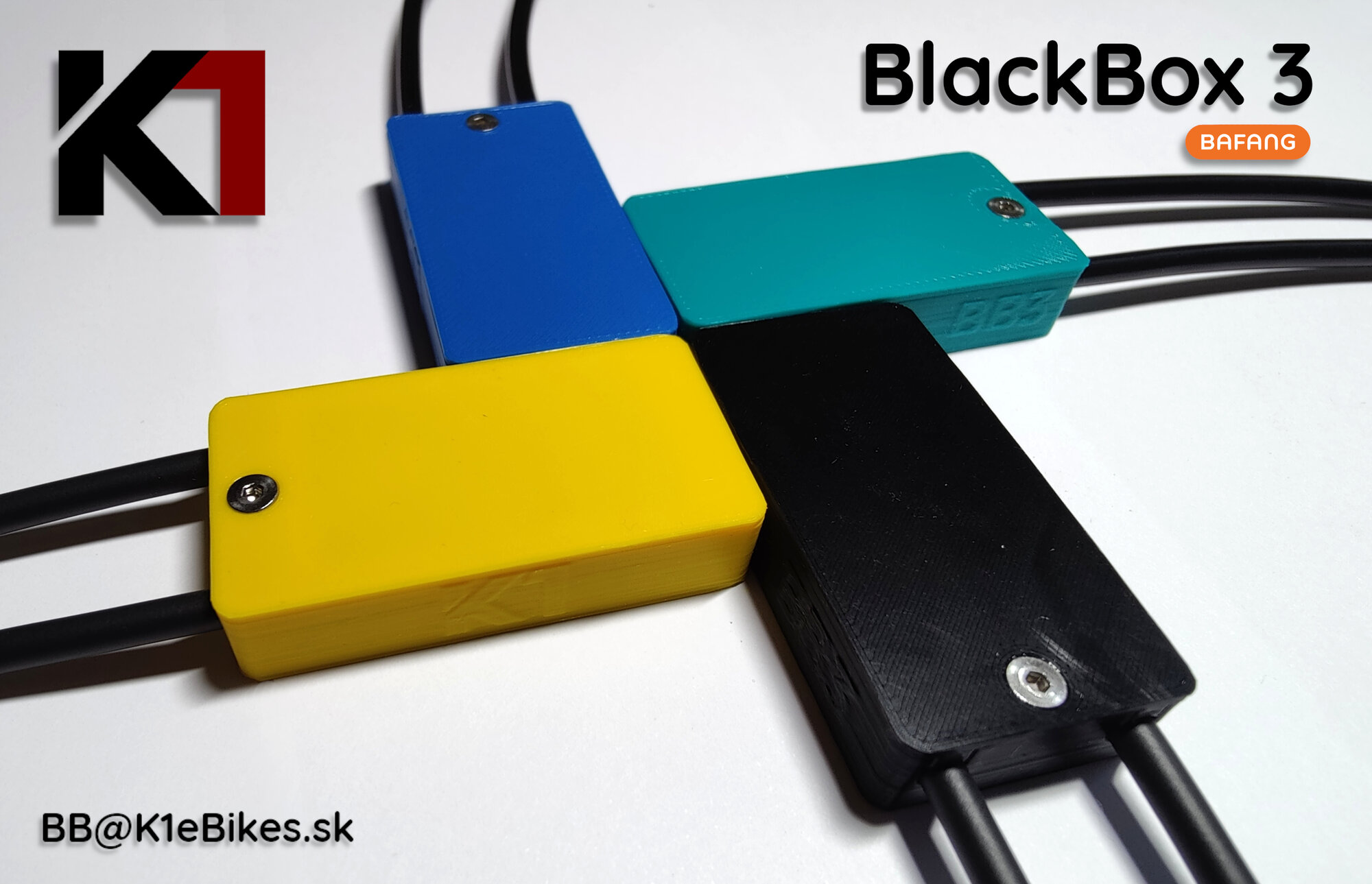

And also second device: K1 BlackBox3.
Device which can be cabled permanently on an ebike and you can switch between speed limits any time by holding Plus button. Also to set all other possible parameters.
Or you can set controller parameters and deinstall BB3 from ebike.
Waterproof and no need external power.
More info, pictures, video, tips and ordering on this google form page:

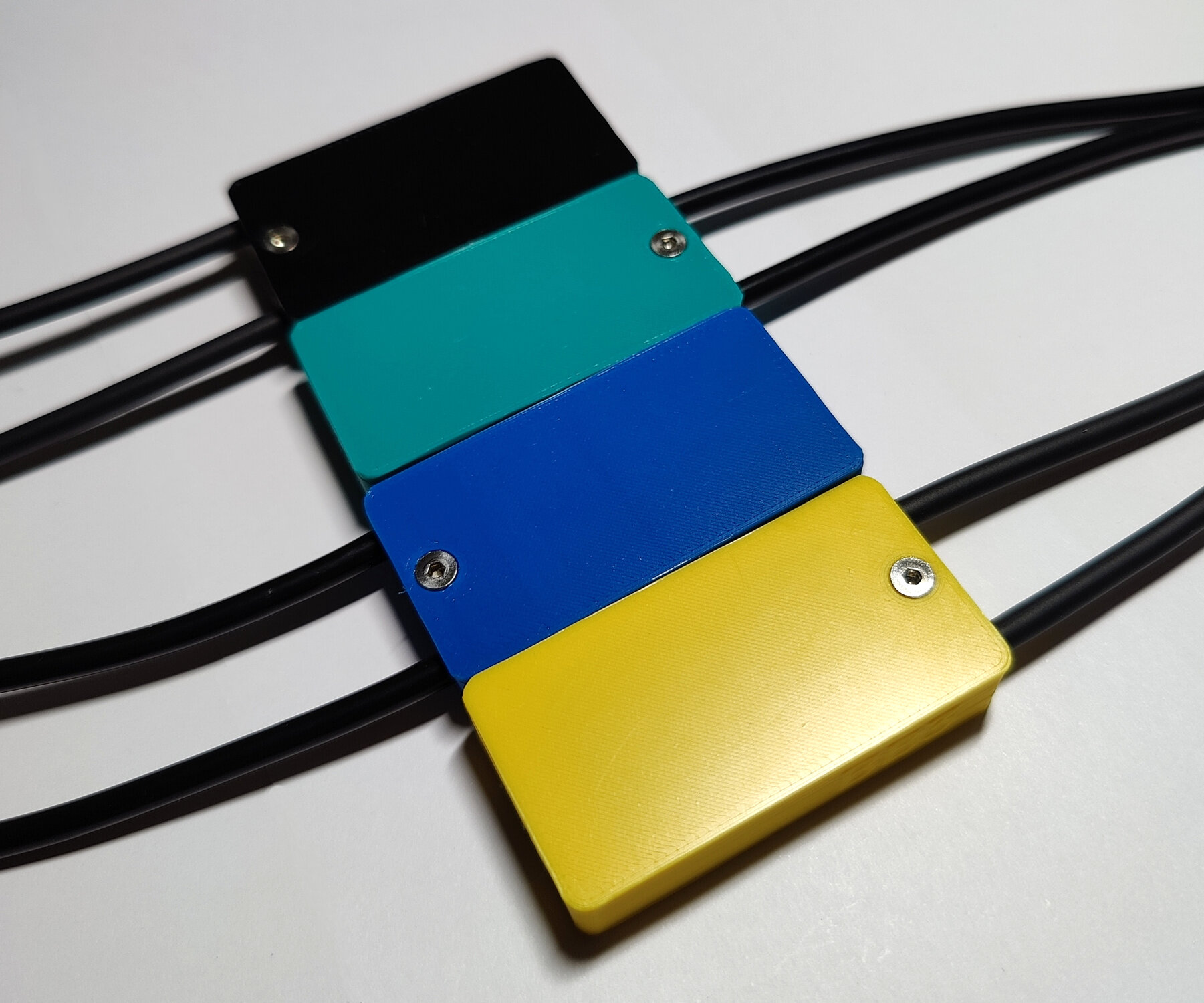

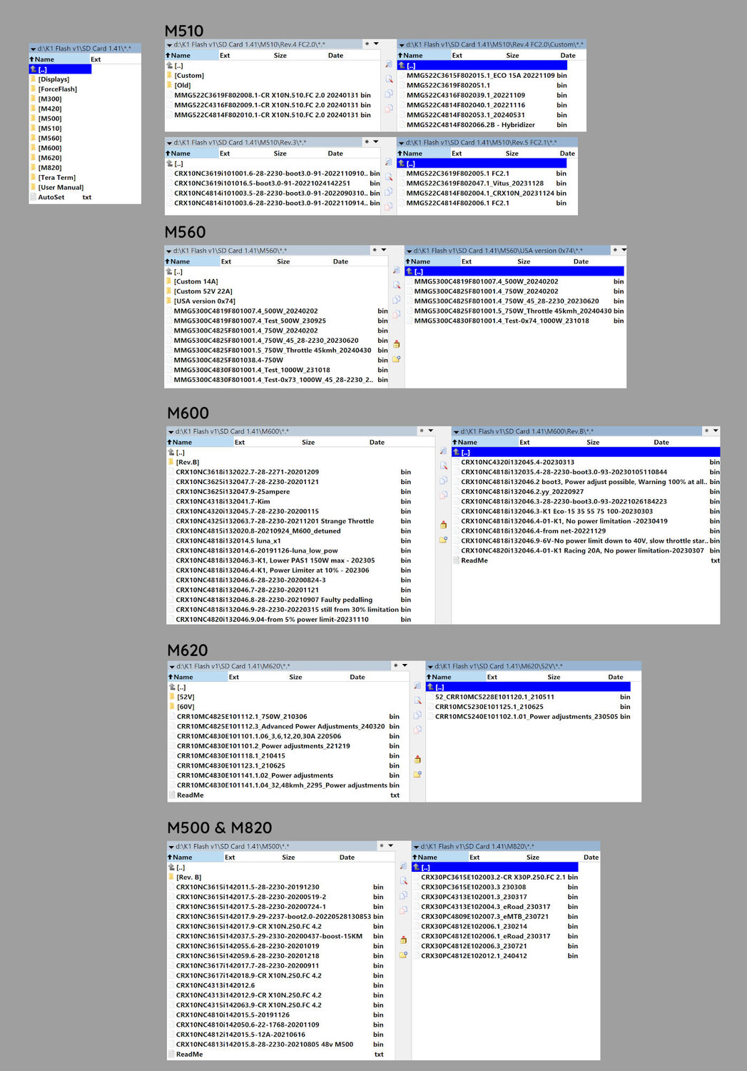

Now supported also M620 CAN firmware update. And should be working also with M300 and M420 (same bin file type).
M620 owners !!!
There is firmware v1.2 (30A) with option to adjust max power at each assistance level!
And brand new 750W (25A) firmware v 12.3 which has same options as M560! So including Assistance level % and Acceleration at each PAS. Worth to try. Check K1 Flash page.

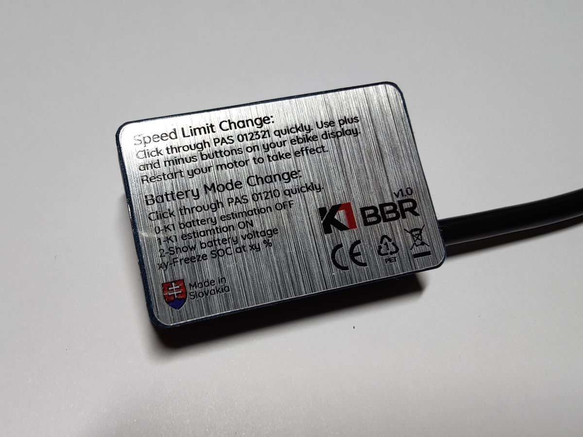

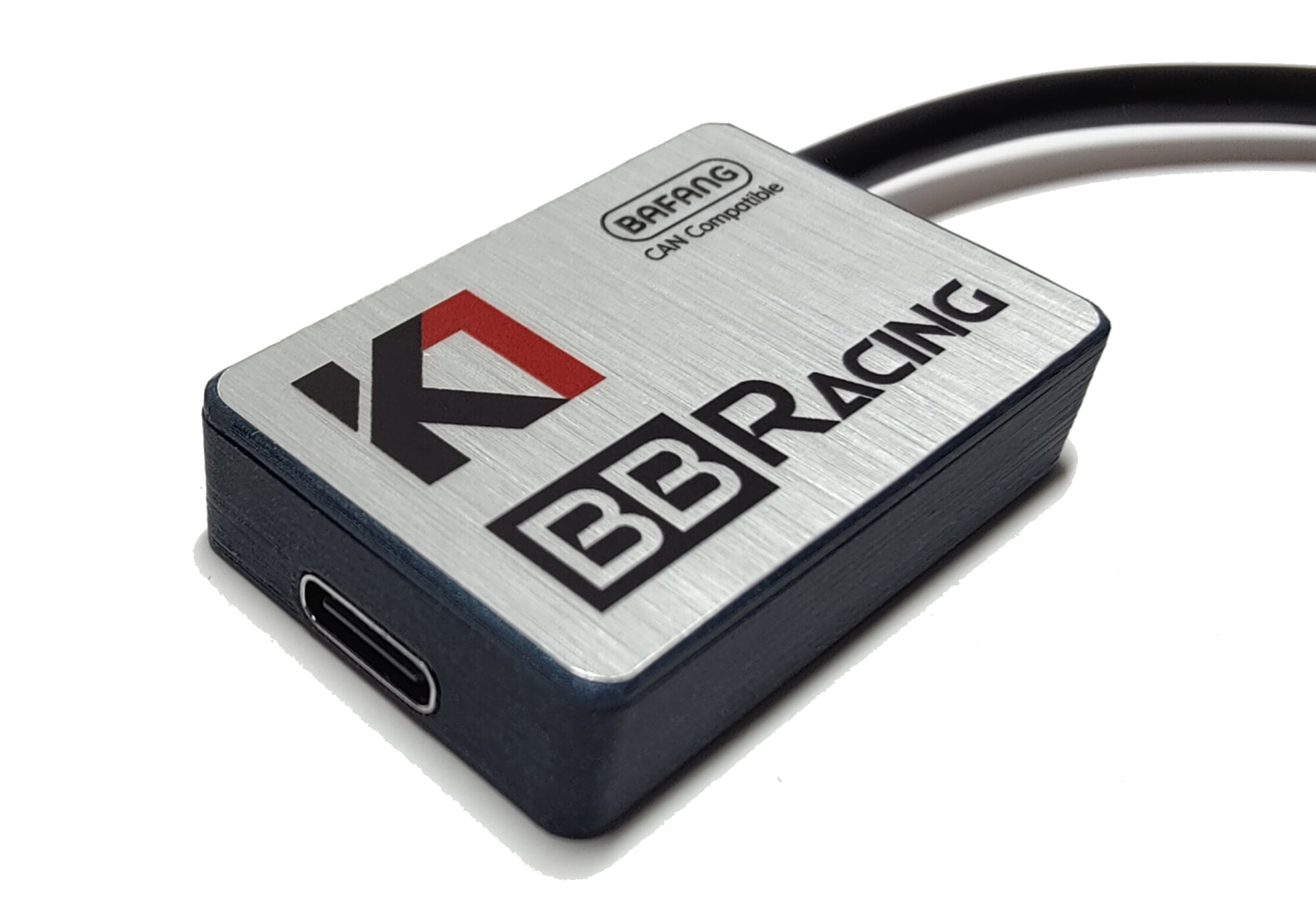

Are you not confident with power limitation at low battery SOC%?
Would you like to set lower discharge cut off voltage to get more range from your battery?
Would you like to remove throttle speed limitation?
Theres a new device BB Racing, whit many new functions. You can set Low Voltage cut-off to 3.0V per cell or even lower. You can use 52V battery with 48V firmware and have accurate SOC % reading.
