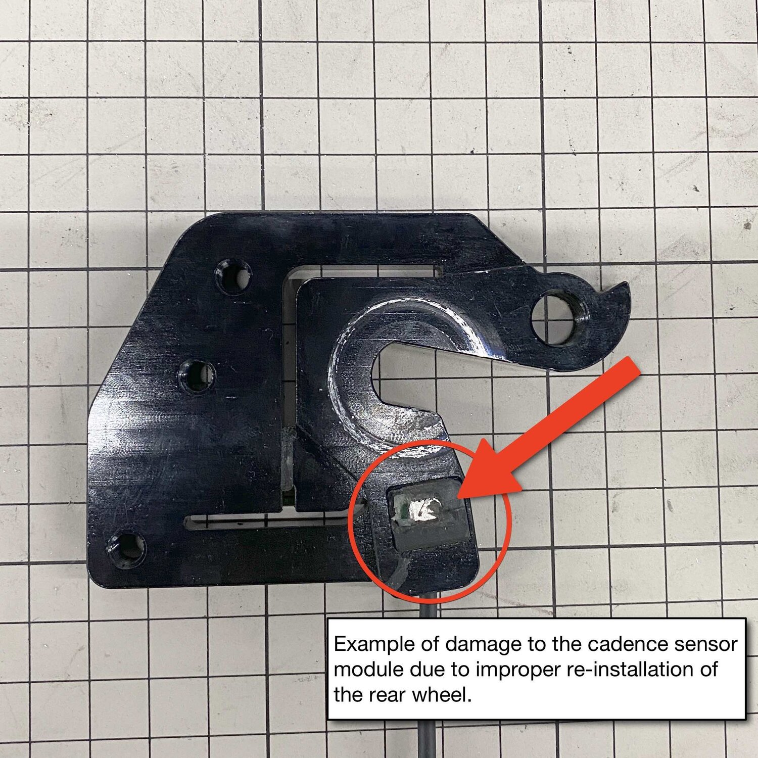

I have a 2021 Juiced Ripcurrent S with the rear hub mounted cadence/torque sensor. Fixed a flat and when replacing the rear tireI had the spacer on the wrong side of the rear frame. Checked that the tire would rotate and - bam- the damage was done. The smallest cog on the cassette rubbed the little pad.....
I damaged the "little pad" on the sensor. The pad is supposed to be the cadence sensor. My pad is scuffed just like the one in the image from the Juiced website.
See pic. The remedy from Juiced tech support is to buy a new one. (They are Out of Stock too.....)
Is there a way to repair this? Upon close inspection it just looks like the plastic cover is torn. But nontheless - the torque sensor will not work.
Any ideas? Drop some solder on the broken area?
Pappy

Maybe 2 small non-stainless sheet metal screws screwed down next to each other into pre-drilled holes? Then file/grind the heads down if needed. (ignore the squiggly blue line)
That whole block is a torque sensor, you can't drill into it, that would destroy it.

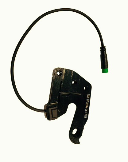

It looks like a TMM4 torque sensor.
They aren't the only brand using them. I don't know if you can buy that damaged piece, but contact the manufacturer and ask.
Just a sampling of their many offerings.
Thanks for all the replies. Not sure what I will do- just trying to understand how the "little pad" works in the overall scheme. My understanding of the cadence sensor is that it measures cycles or revolutions, etc. Little magnet that signals....
The mfr's part #. TOSS2A-11T-150mm-2106-0056. I'm thinking the "11T" must reference the gear teeth on the cassette. 150mm could be the spacing.

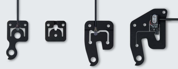

"Surface604" is an ebike company up in Canada. They have a torque sensor that appears to be nearly identical to the Juiced product. I'm going to call them and see if it might work. It has the same gearing (11teeth). I'l need to learn more about the setup parameters for a torque sensor. The 604 sensor is $129 and in stock. The Juiced sensor still shows "out of stock". C'mon Juiced - is this a supply chain issue?

Ok -new update- Spoke with "Mike" at Surface604 (ebike company in Vancouver, BC). I had left them an online message on Monday morning and, wow, they called me live phone this morning! I had included information about the Juiced sensor, with the serial number too. Mike thinks their "universal" torque sensor will work. It's on all their new bikes. Looks like the same sensor as offered from Juiced. Anyway, $129 plus $15 shipping. About $50 bucks less than what Juiced wants - (if they had stock to ship)
So I'll have another update after I CAREFULLY install the new one!

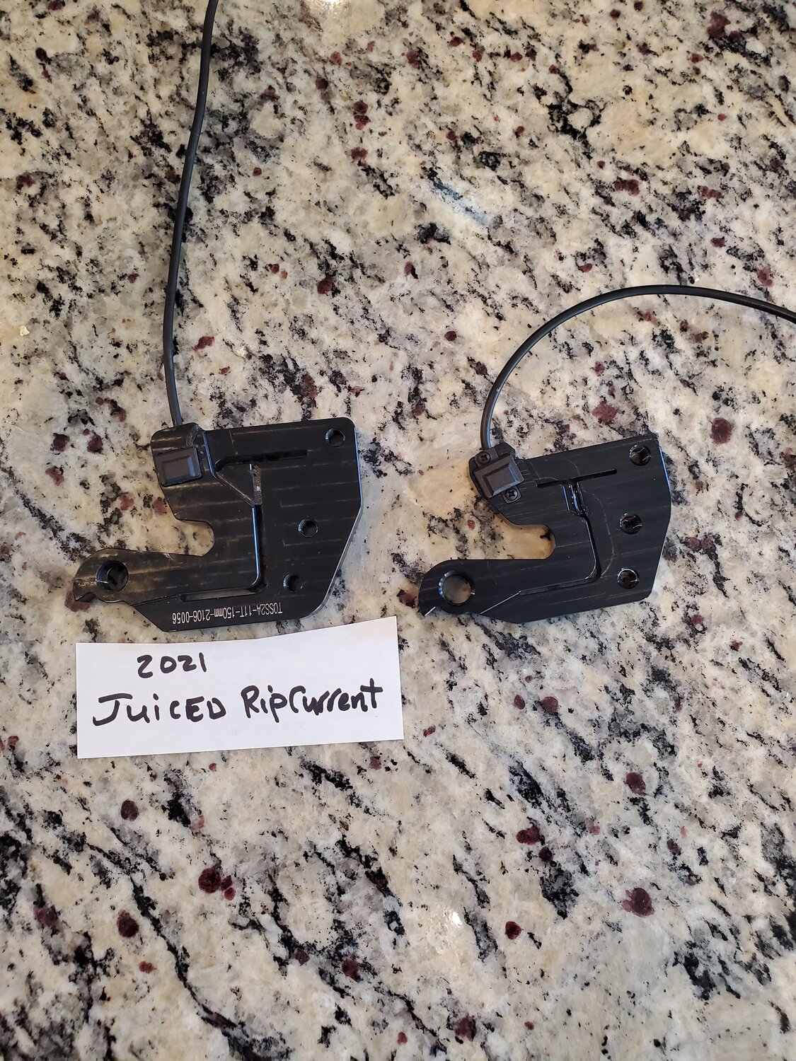

Sad to report, but the replacement torque sensor from Surface604 in BC is not a match. Their customer surface was/is great as "Mike" was very helpful.
I've attached a pic comparing the 2 sensors. The "604" sensor was smaller and the mounting holes were off by a few mm's in different directions. I might have been able to get it mounted but not without some drilling and probably damaging the part beyond repair.
Anyways - I hope this helps someone else down the road!
