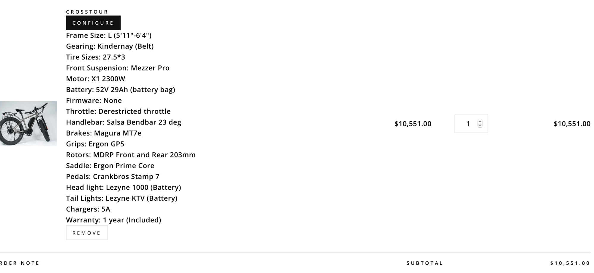

I've narrowed it down to Hydra or Crosstour, what do you guys think the main pros/cons or differences between these 2 are?
No not mine, I just love the configuration and color, if you want the highest top speed you need a 2300W version of the motor.
Pushkar tested them already he said they are scary fast, he didn't want to push them faster, he felt it might not be safe.
This Ebike isn't for 50mph it wouldn't be safe.
If you want something really fast and safe you need to move to an electric motorcycle like the Sondors Metacycle for $5K USD.
I am sure the Helios with a 2300W X1 set at the highest level on the display is going to be one of the fastest pedal Ebikes on the market.
Any faster won't be safe for the specs.

Would the default gearing of Sturmey Archer 3 speed be sufficient for the crosstour or should I get $1500 kindernay, if I want top speed of 35mph on throttle
Did you know the throttle is restricted to 750W to save the life of components, you can have it unrestricted....but no warranty.
You will bust chains among other things.
I would email Puskar and ask him, "which configuration is best for throttling at 35mph?", my guess is he is going to recommend something with a gates belt.

Actually Reed, I agree with you regarding the riding position and after talking with several people with more knowledge about my intended use they've said to head down the Kindernay path with belt drive now if possible. That said, I've changed my order to the Crosstour. In speaking with Pushkar earlier today he mentioned they are coming out with a triangular battery with 30 AH shortly, that case might look better than the Jumbo Shark lump.
