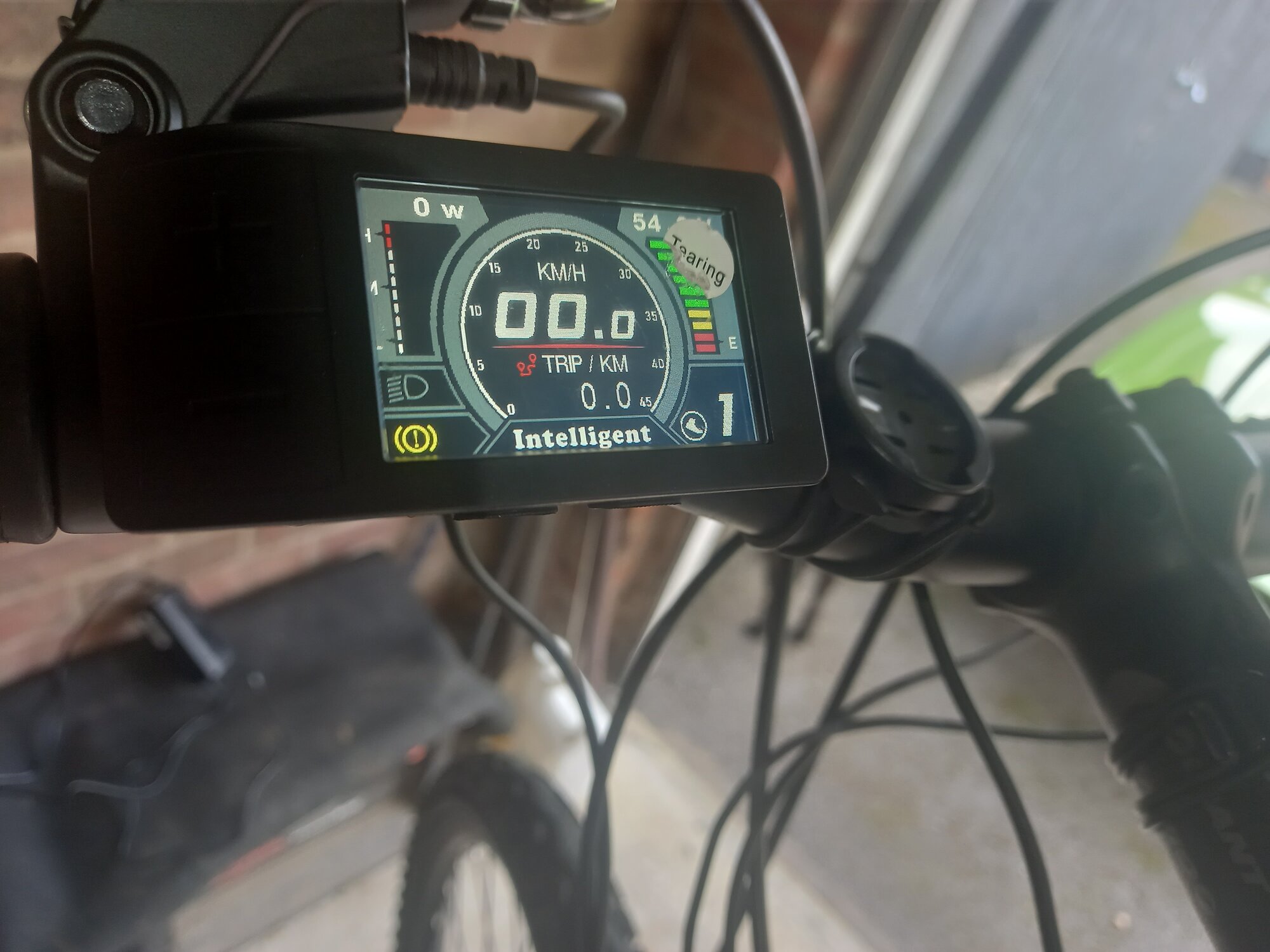

I've just installed bafang to my bike, all connections seem good, but can't get power to electric motor, please could you help

Do you have a multimeter device? For checking connections?
I am unfamiliar with your display, but the lower left hand corner yellow brake indicator may indicate your brake (motor cutoff) is engaged and therefore no power to the motor. It should not be Yellow. Somewhere your brake cutoff switch is engaged. Disconnect your bake HIGO plugs. If the light goes out, you have found the source of your problem. From there it should be an easy fix. It goes without saying, but I must say it, be careful operating your bike with brake motor cutoffs disengaged.

According to your display one of your brakes is applied or the sensor is faulty that is why your motor has no power.
