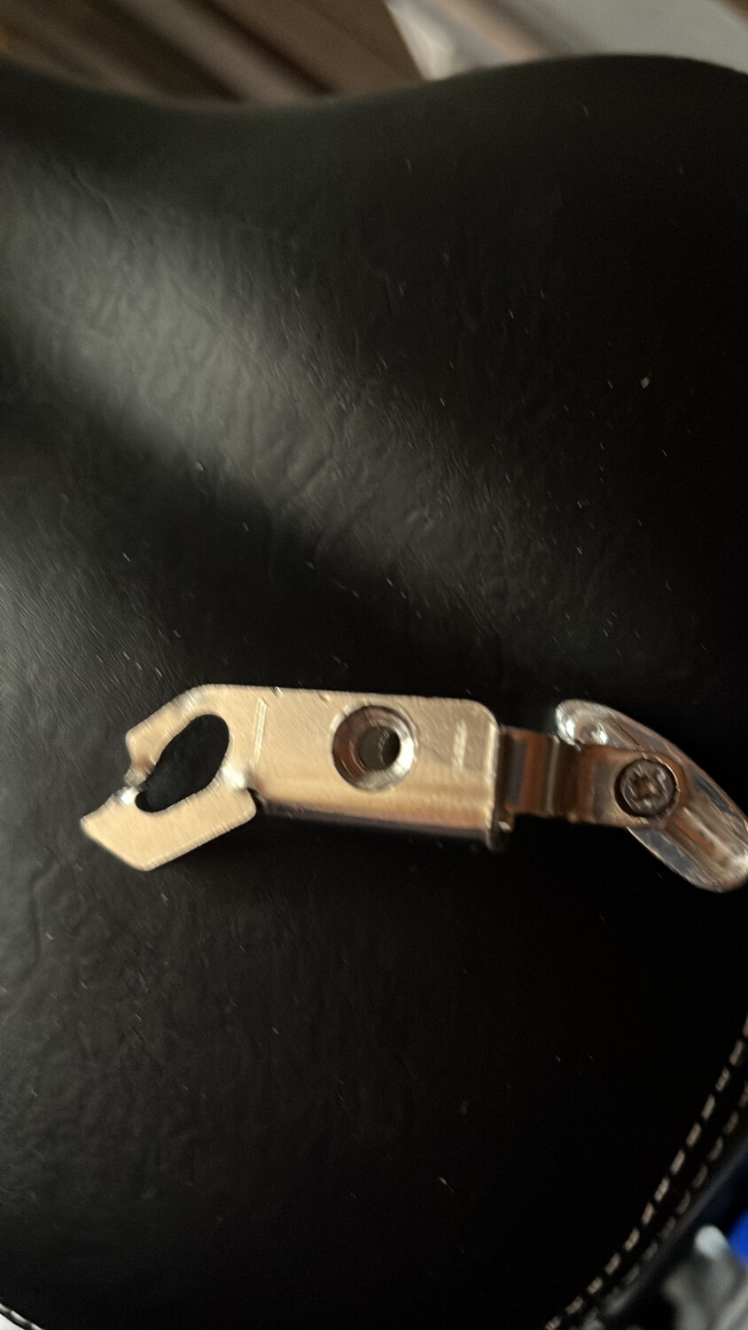

I received my new Lectric 2.0 step thru a few days ago. While unpacking I noticed a small pin in the bottom of the box (not a good sign) not knowing what it was for I set it aside. Later I found the folding frame latch also sitting in the box loose and I knew what the pin was for. The pin holds the latch onto the frame. I am able to get the latch and pin back onto the frame but I don't see how the pin is retained, and it will just fall out the bottom as soon as the latch is released. Anyone have any idea how the pin is retained to the frame? It has a small treaded hole on one end which I assume is for attaching another part (see pictures). I have sent Lectric several emails but no reply yet. Can someone look at he bottom of their frame where the latch pin is and see if they can see how the pin is retained?

Thanks for response. What you say makes sense and the threaded hole in the pin may be for extracting the pin to replace the latch, except when inserted the pin seemed to go in further than it needed to and past the point where it passed thru the bottom hole of the latch. Before I do anything i will wait to see what Lectric has to say.
It’s been a week and I have not heard back from Lectric on any of my emails or calls. But I did solve the issue on my own. I knew there had to be a way to retain the pin. So I took a closer look at the frame and found a small hole that when the pin is inserted all the way the hole lines up just below the pin. The hole is threaded (looks like an m3) so I just have to screw in a m3 allen screw which will keep the pin from falling out of the bottom of the frame. The small treaded hole in the bottom of the pin is probably for removing a stuck pin.

Red circle is the threaded hole I found where a screw should have been to keep the latch pin from falling out.

Yes I am glad I was able to figured it out and it turned out to be a simple fix. The threaded hole had paint in it that was like new so apparently the factory never put the screw in and the pin/latch fell off in transit. I just hope it was a freak occurence and not part of a large batch causing issues with many bikes.

NO store had a Set Screw that small (2mm M4-0.7) not Lowe’s, bike king, Home Depot, & Ace hardware, Ace was closest @ M4-10 but its inside the fold so no go.

I don't think I've ever seen an M4x2mm set screw. Must have like 1 turn of thread on it. Couldn't find any assortments on Amazon with smaller than M4x4mm, but found a 10-pack of M4x3mm at Horizon Hobby.
For something that small though, it might be fairly easy to cut the tip of a nylon M4 screw down to size and make a little notch in the end. Flare the end a bit and it should screw in pretty snug.
Unless Lectric advises against it, if it were me, I would put some blue or purple LocTite on it when I install it.

There was a lot of paint in the hole/treads and the fitment was very snug. Plus when the frame is closed the screw hole is covered and blocking the screw from backing out. That being said I agree with you that blue loctite should be used on most screws on this bike due to the vibration they will be exposed to.
