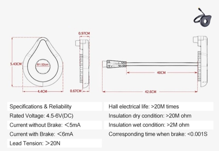

There are smaller self-contained PAS sensors available, but you still need enough space on your axle to accommodate it, and it may not be compatible with every controller/ebike,..
