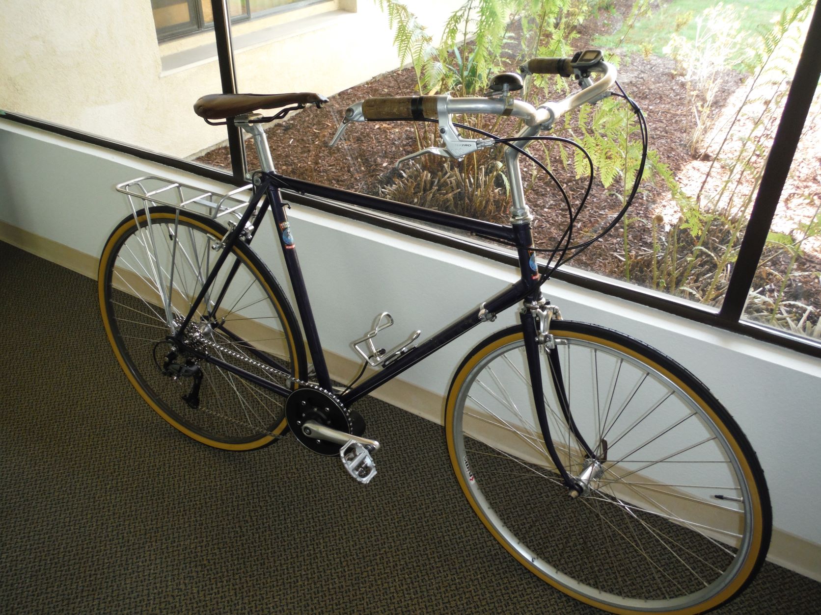

That looks like an excellent bike for a conversion. I have two TSDZ2 bikes. One 36v 500w and a 48v 750w version. Both motors cost and weigh the same. I ride both bikes on routes that have flat to hilly/mountainous sections and both motors do well but the 48v 750w version has significantly more power in the highest setting - almost too much for most regular use. Despite what a certain clueless individual "advises" (who admits that he never did a mid drive conversion, having only watched youtube videos) there are virtually no difficulties installing a tsdz2. If you have the ability to remove a bottom bracket assembly and have a few basic bike tools a conversion can be done in an hour or so, I've installed them on 5 different bikes and I've also installed front and rear geared hub motors. The mid drive is just as easy overall and a much neater installation with no separate controller, no brake cut off or throttle with the associated extra wiring needed. Torque sensor is the way to go IMO for a more natural bike riding experience. By the way I have a Yamaha PW-SE powered gravel bike that rarely gets ridden because I prefer my tongsheng converted bikes. Huge heavy batteries aren't needed for 40 mile rides with these efficient mid drives. I rode 24 miles today including 1700 ft elevation gain on a 48v 10ah battery and am still at over 51 volts.

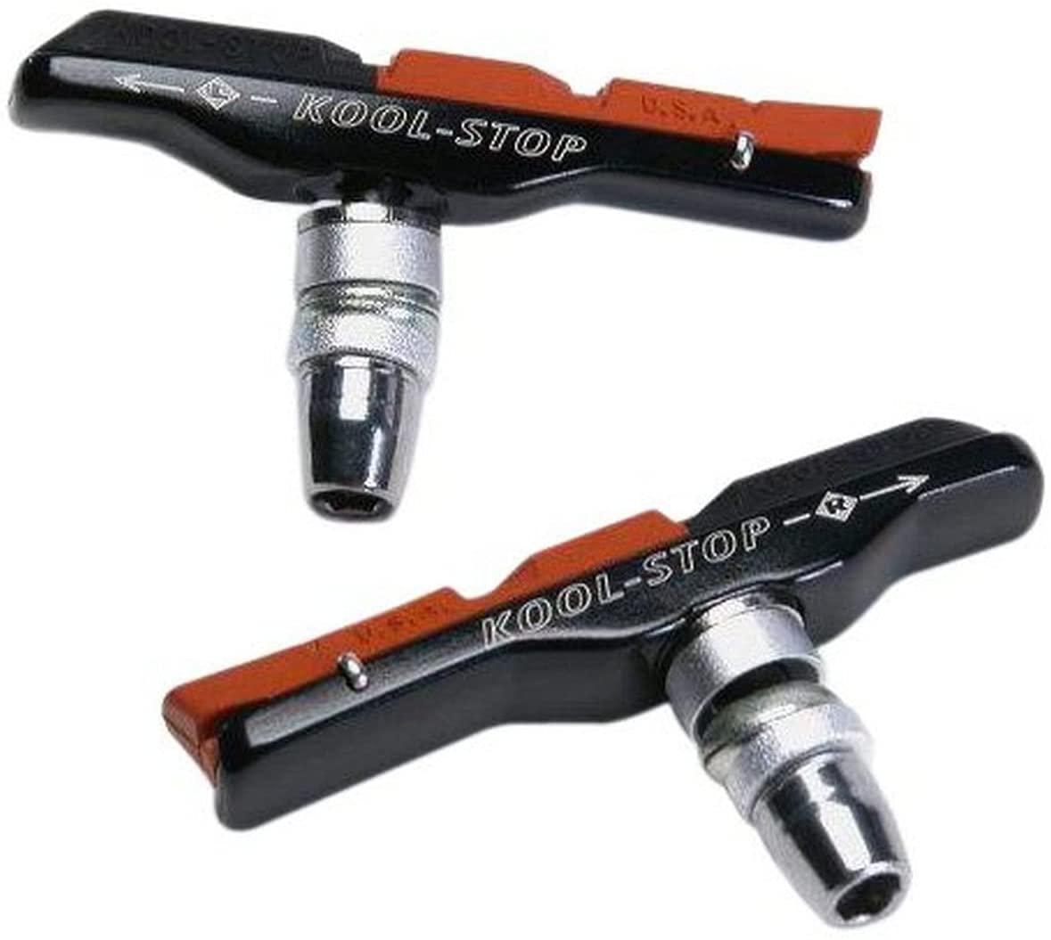

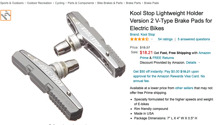

I find rim brakes fine for my use. I regularly hit mid 30s mph downhill coasting and up to low 40s and I have no issues with the rim brakes on my two conversion bikes. They have similar stopping power as the mechanical discs on my gravel bike, not as good as amazing elixr1 hydraulic discs on my son's old mountain bike but I prefer the simplicity and reliability of mechanical brakes over hydraulics.

Rim brakes work fine. I install the ex-long ones and keep the rims clean. @EMXG like to clean rims with acetone, then isopropyl. I bet gin would also work. I don't talk about my site here but in your case it sounds like you want the confidence that this is totally doable. It is. I have done builds with zero zip ties. Clean.

Upgrading the brake pads and keeping the rims clean sounds like a good idea, will keep that in mind. I appreciate the tip.

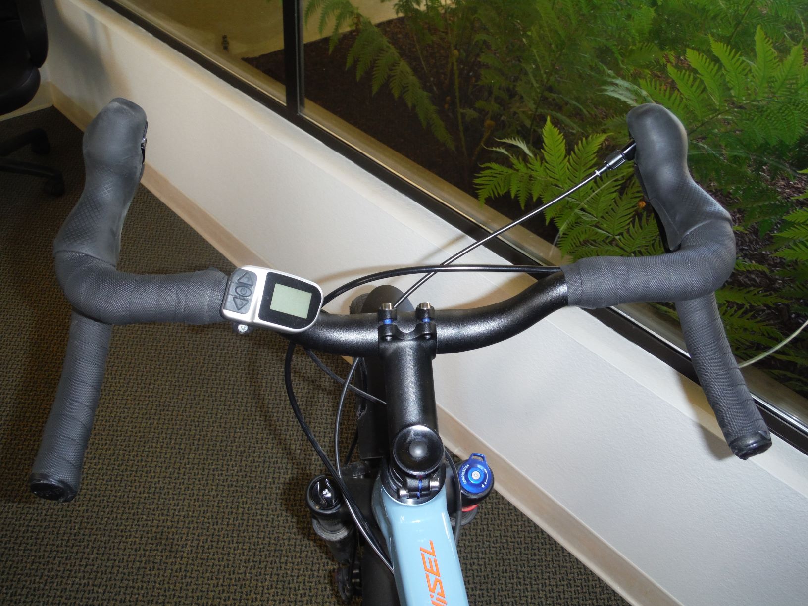

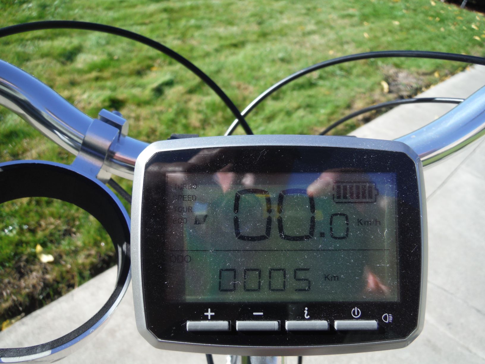

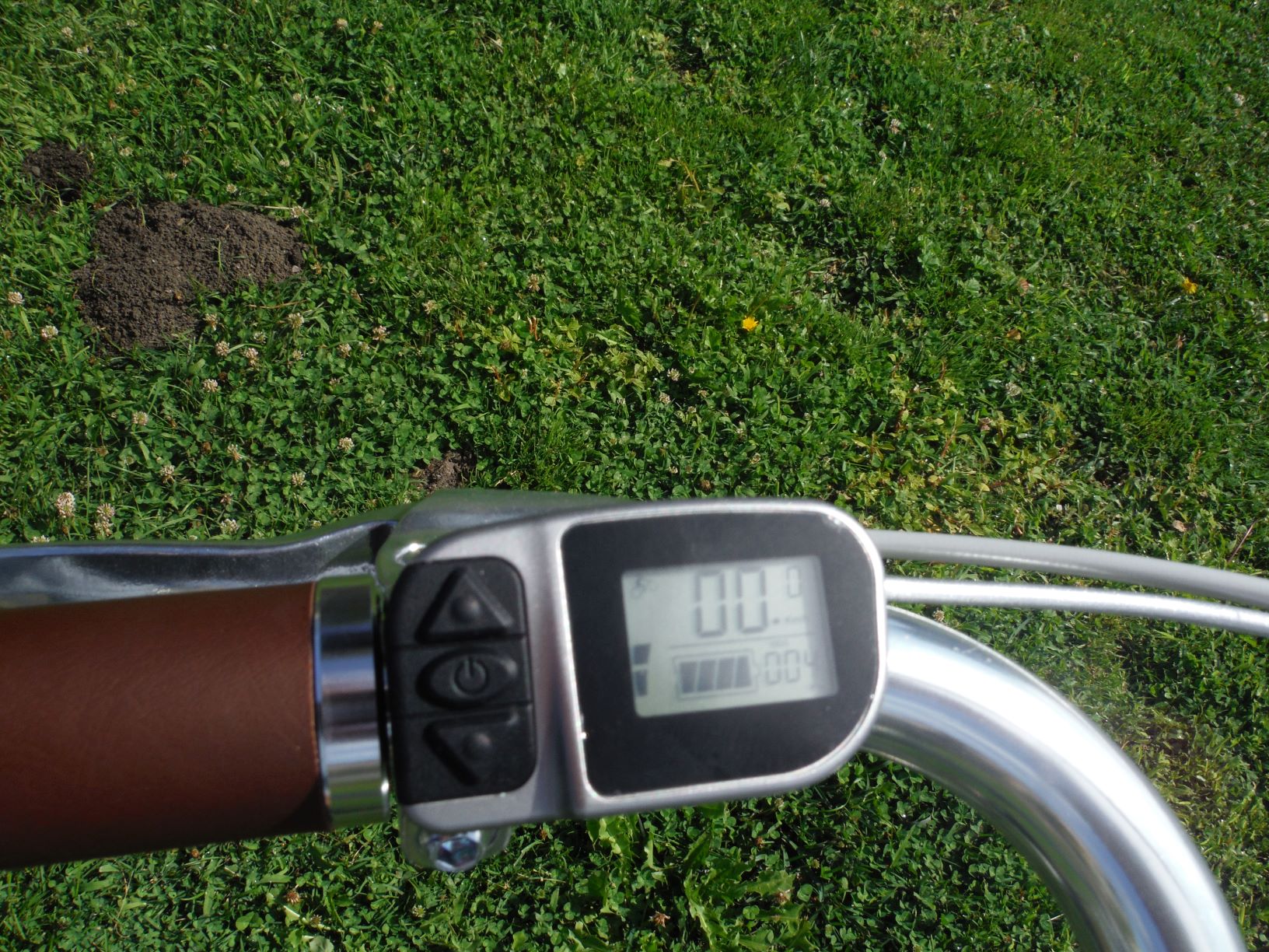

The small display will be fine. It just cannot fit on the inside of a bend. So put it on top of the bar to the left. You are not going to be looking at the display, just like you don't squint at a shifter. You will be using it by feel.
