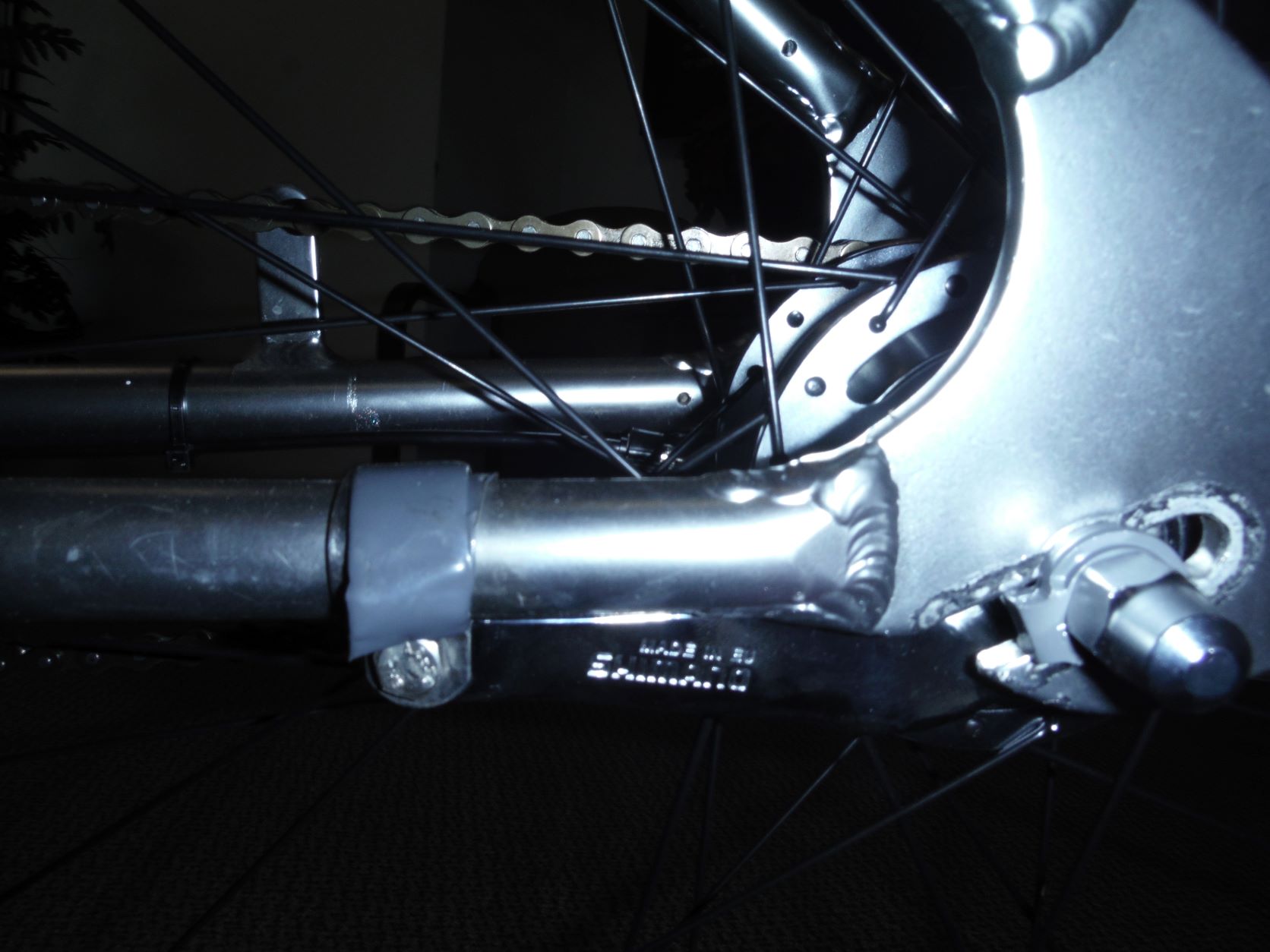

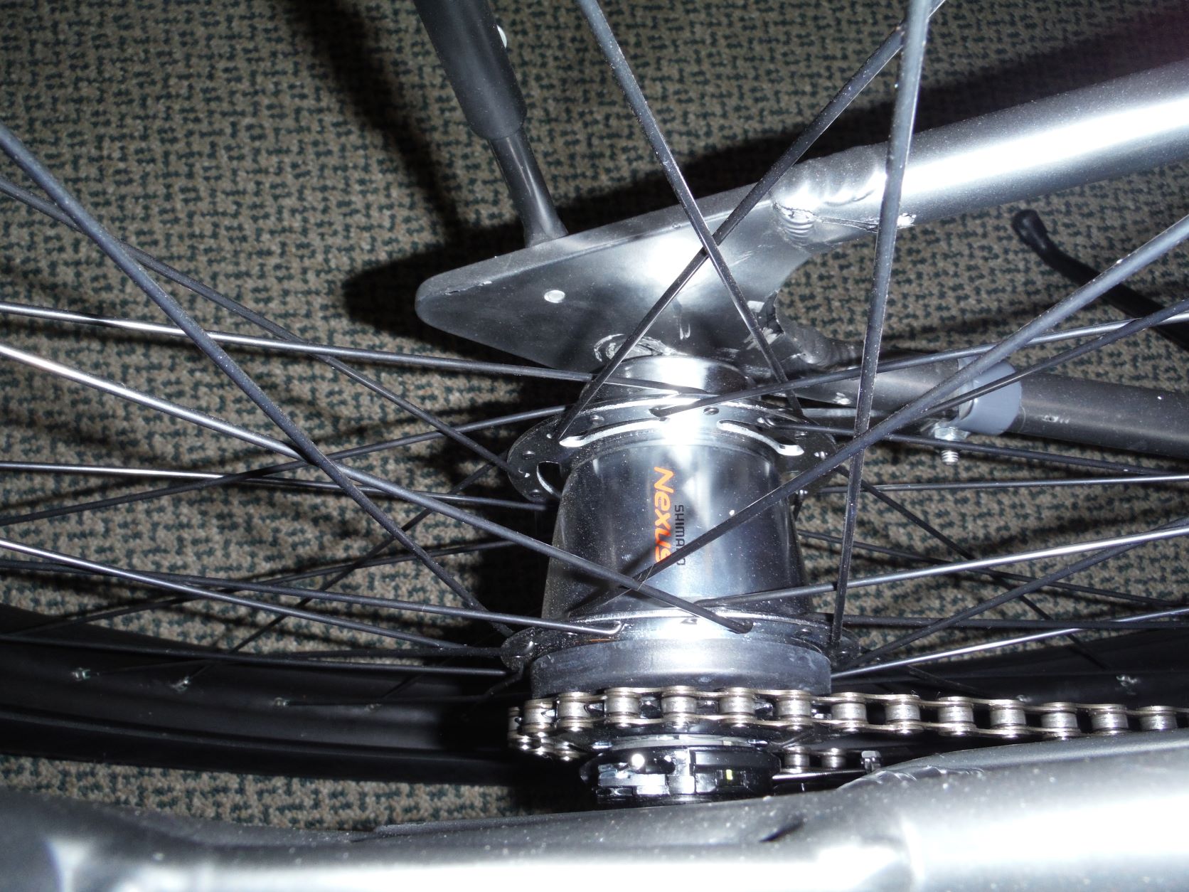

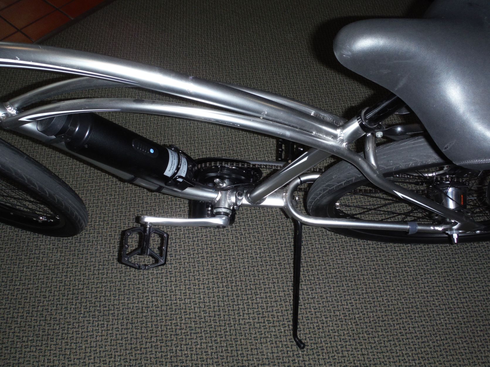

So, I take it you already have a bike that you want to convert. To the best of my knowledge, hub motors do not work with coaster brakes. The way to do it is with a coaster brake clutch mid-drive. The motor assist shuts down when you coast. Then it restarts when you pedal based on pedal pressure and pedal speed (cadence). It can be done, but it is better if you have at least 3 internal gears with the coaster brake. One way to do that is with a Nexus hub. Here is one such example. Yes, that is what a good electric bike conversion of a basic beach cruiser looks like. With a single speed you will need to launch gently because you cannot down shift and the top end will be limited, as will climbing ability.

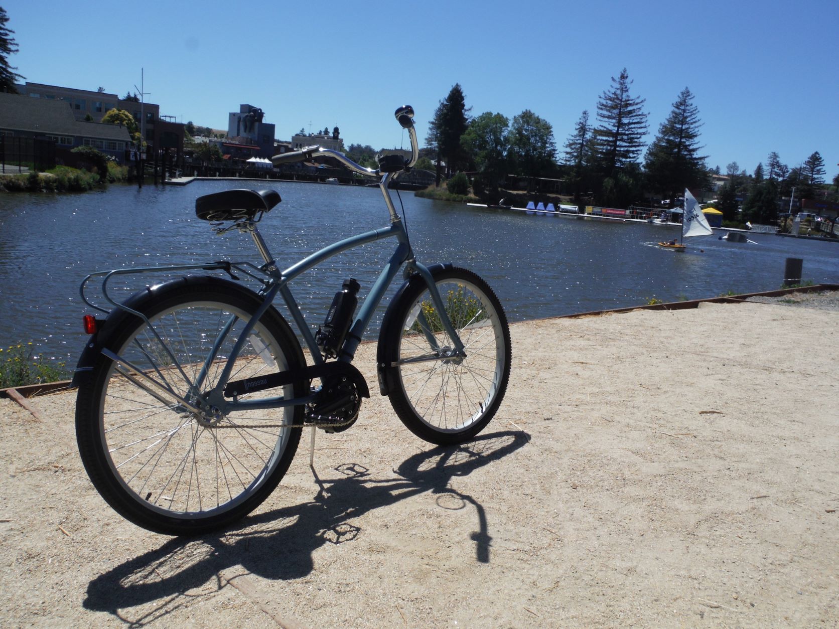

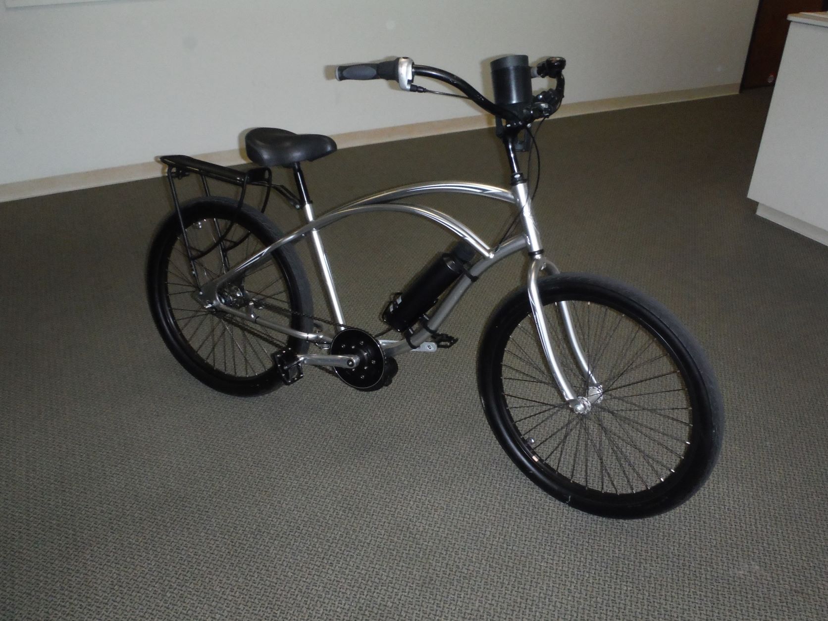

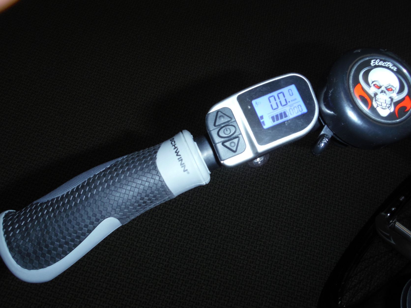

Or a coaster brake clutched mid-drive. These don't allow for a throttle for safety reasons. You want the motor to cut when coasting and before braking. I once took a single speed Townie with a coaster brake, and made it an 8-speed coaster brake mid-drive. The wires were internal. With the hub drives I know of there is about a two second lag between coasting and total power cutoff. That would not be good with a coaster. With a throttle it could be very bad if you are coasting under power and accidently hit the brake.
