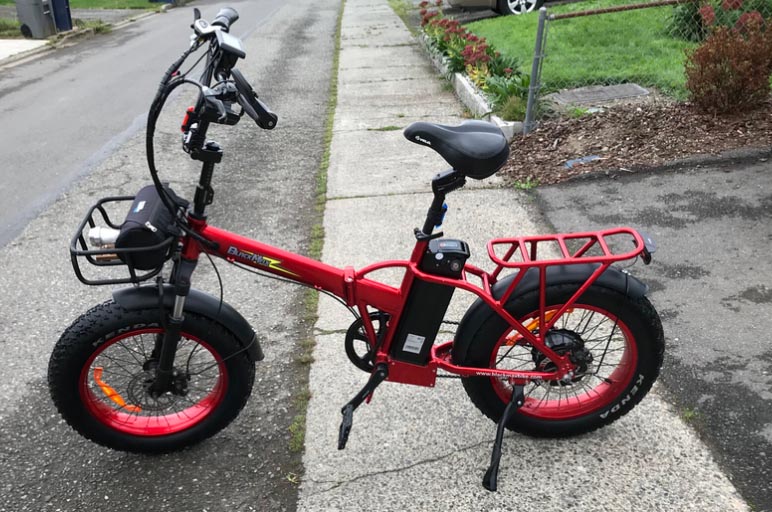

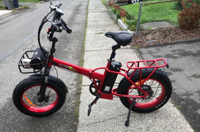

I pulled a picture from your other thread. You're just used to the bike. When new, it was scary, because it was your first bike.
Sure is a good looking bike though. You've done some nice add to it.
There are probably 100 thousand similar bikes floating around. You'rs is a Black Max Crusier. There are the Radmini's, Lectric XP's, and a whole bunch of similar chinese imports. Mine is the Ecotric folder, which uses a silverfish battery like yours.. Many claim to have 750W motors, but they're probably the same as the 500W motor in my Ecotric. There's no room in the controller compartment (behind the pedals) for anything beyond a 20A controller. These bikes are powerful, at least to me, but they're not monsters.
The battery didn't come with high current cells. amd after a year of presumable throttle whomping, its reserves are gone. Check the fuse in it. Is it a 25A fuse? I doubt that many SIlverfish packs have enough cells to push 30 or more amps reliably. You would need one custom made to handle 30A.
The controller compartment in these bikes generally is only large enough to handle a 6FET 20A controller. That's all I can fit in mine. If you don't mind mounting it somewhere on the frame, you could upgrade to a 35A or 30A controller. It will probably need a new display plus some re-wiring. Then with a bigger battery/controller, you could look at lacing a real Bafang 750W motor into the rear wheel.
I don't think the above is worth it. A light folder, with a mid drive motor, like the Luna Mosso, is more appropriate for wheelies, although I'm sure your bike on a steep hill, with half the weight behind or over the rear wheel could lift the front wheel.
