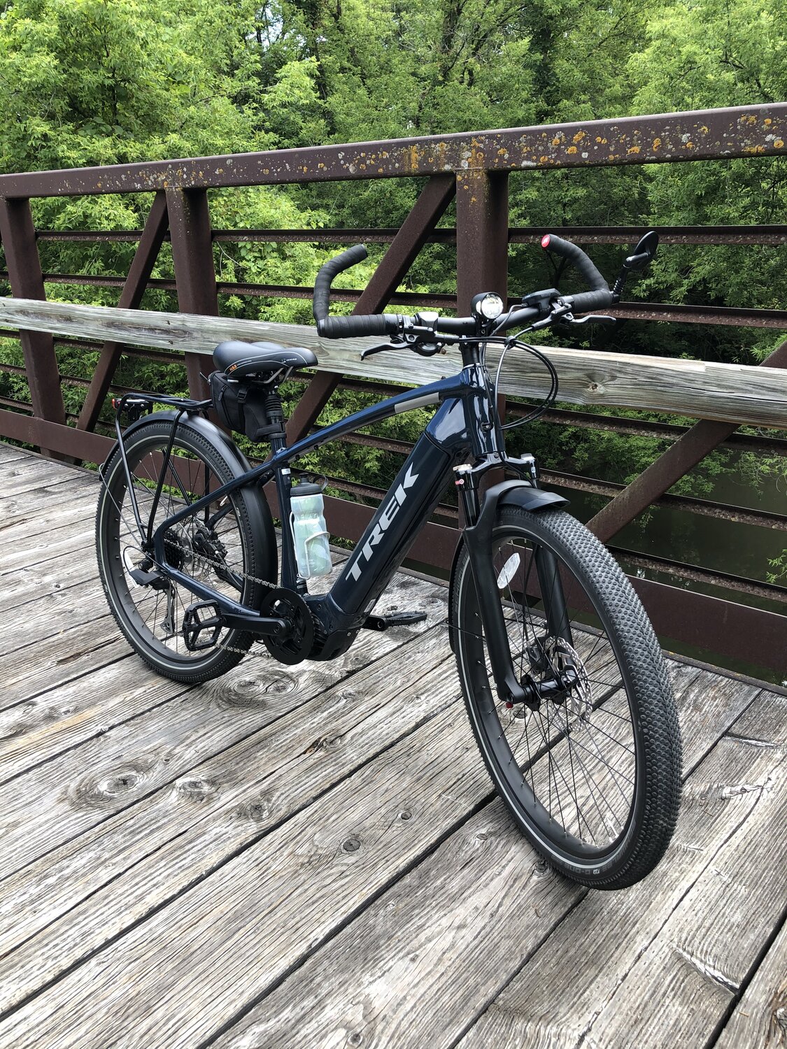

1,200 miles and no issues apart from the common rear hub failure. Bike, as customized as it is, a joy to ride. For the ability to customize my motor output and get a workout, I really like my Specialized Vado SL 5.0. For overall ride quality, comfort and speed, the Allant 9.9s is the winner. My Trek dealer is really good in terms of service so I have a high degree of confidence that if any problem does surface, they will be able to resolve it and/or will stand behind the product.

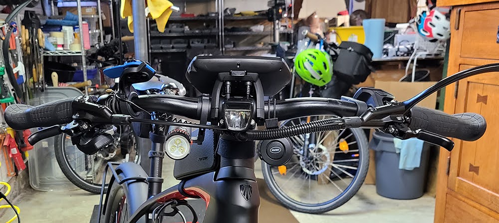

I added the Knog Trail 1000 with programable light modes and a 5,000 mAh battery designed to recharge phones or other devices. Nice easy mounting system. I have mine hanging below the handle bar.
For a tail light I got a Rayo Cliq that has an accelerometer to activate a brake light (sensitivity adjustable in a phone app) is fully controlled by the app and also has a loud motion sensor security alarm.

That knog trail head light looks very interesting. I’m going to see if they ship here where I am. Can you post a pic of how you have it mounted?

It is on the right handlebar (on the left in the photo) with the mount right next to the display mount, under the handlebar.
