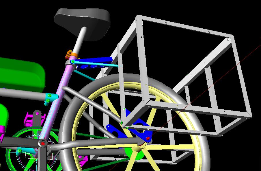

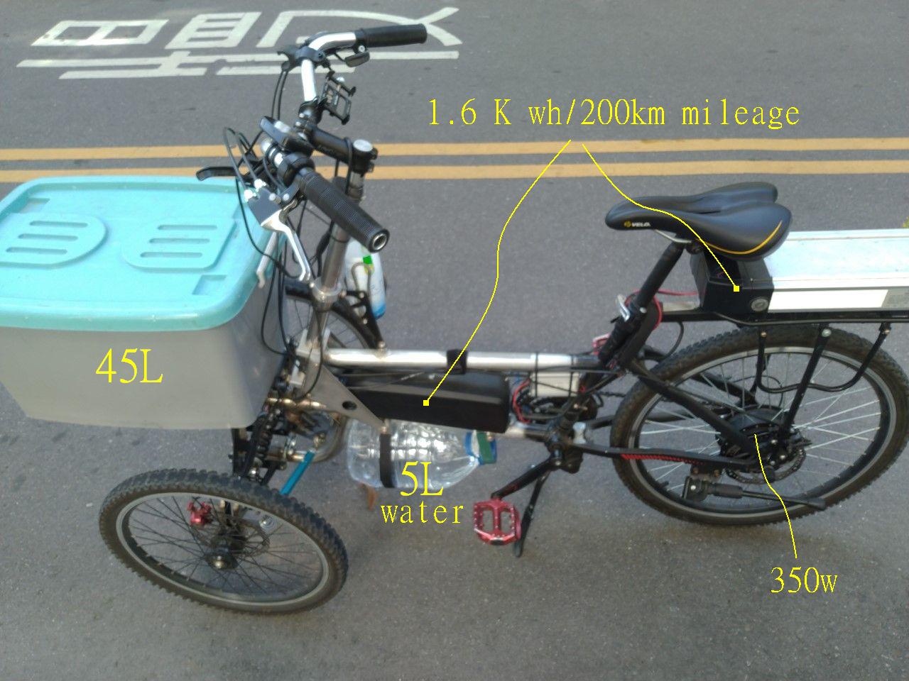

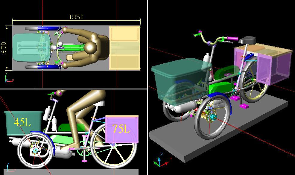

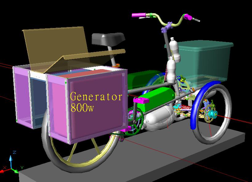

I'm going to build a 800w gas generator box after I finished a complete chassis order work
800w generator

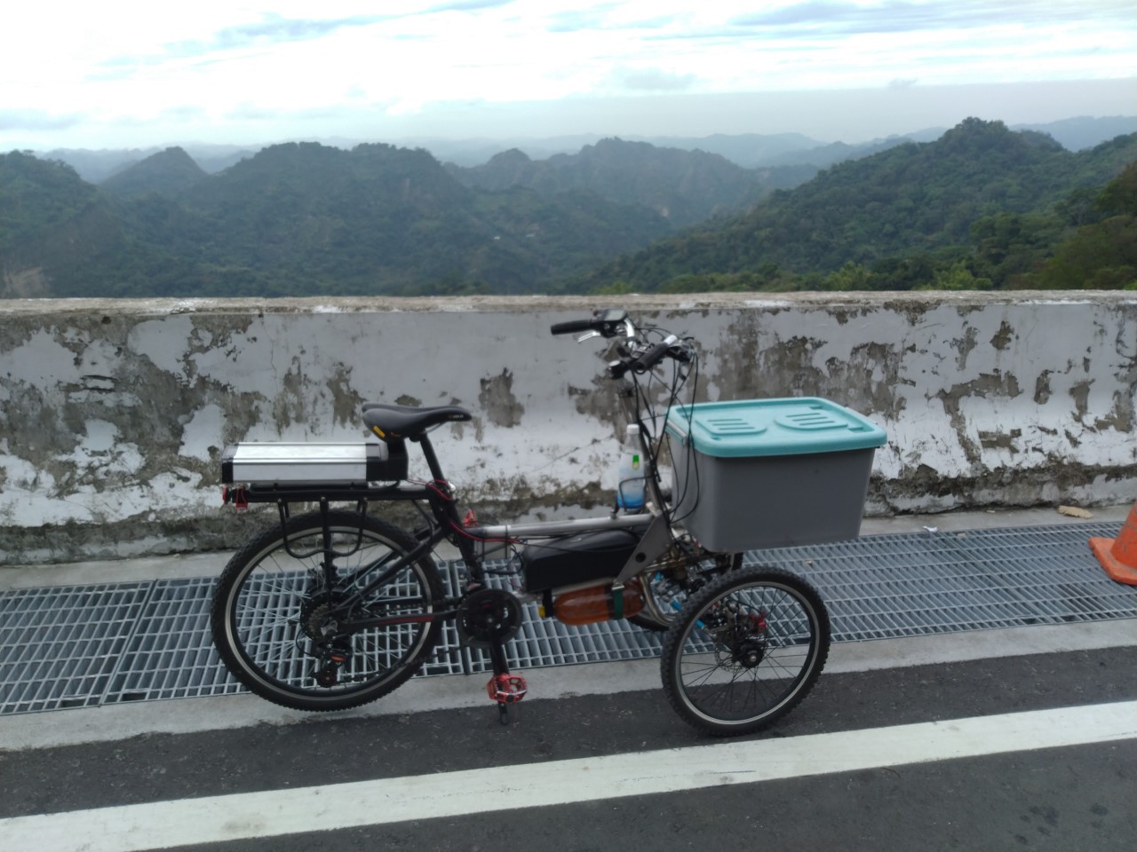

OK! I just forgot to mention: Despite its reasonable or not! its the way to travel a long distance journey in remote country side
And I develop the type for business if possible, the box is not only for a generator, the tilting trike fully equipped with Front & Rear box more balance
Even with a motor scooter, you can't ride like this- -
go over curbs

I assume you want to charge one battery while using the other and I'm not sure of the laws where you are. Here in the US, a bike rolling along with a gas generator putting away would be construed as a motor vehicle, not an e-bike. There is a subtle distinction which wouldn't be evident to a law enforcement officer.
Unless you plan to ride 24/7, you should be able to carry several batteries in your box which would last all day, or at least until you get to a place where you can recharge. The cost and weight would be slightly higher than a generator & gas can but here in the US at least, it would be legal.
I develop an e cargo bike for all purpose- shopping /touring/adventuring- -people got more choice what they need
1 day riding 200 km, then charge 2 batteries night time is legal at least
