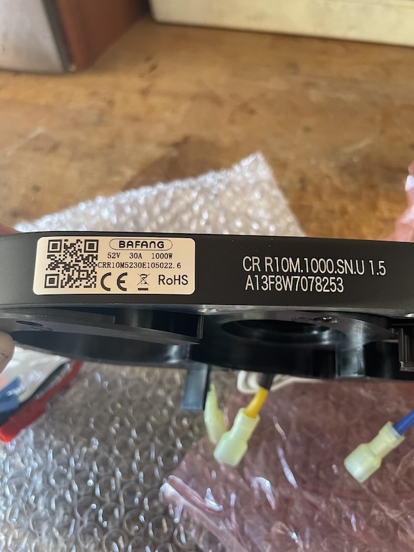

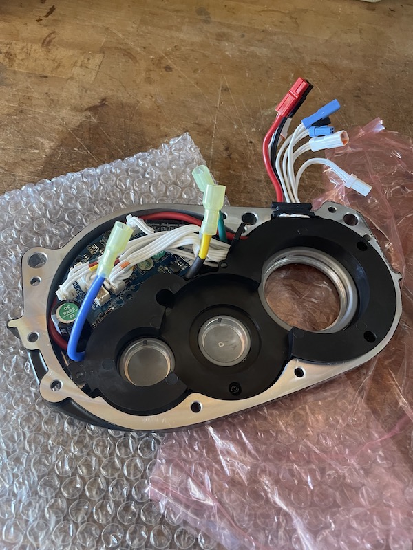

GBK has the UART style motors as a kit, bare bones or just the controller if thats all you need.
Here's the 52v, 30a, 1000w UART controller I just got from them earlier this week.
