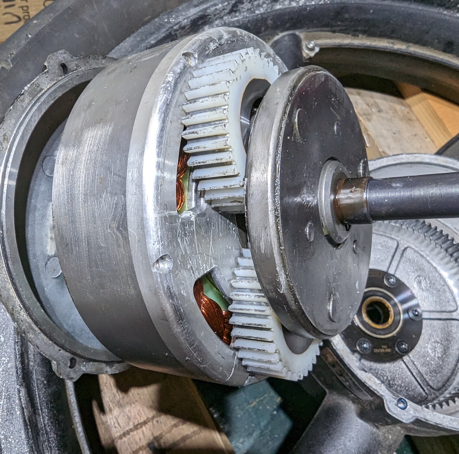

So I opened up the HyperScorpion motor and there's no visible damage to the gears or anything else. No corrosion either and still a reasonable amount of lubricant after 2,000 miles plus.
The pins on the motor connector also look good but I guess the wacky speed readings problem could still be in the hub. Suggestions on what's wrong with this bike are welcome, though I am pursuing solutions with Juiced tech support.
Incidentally, the HS gear plate can not be accessed by simply removing the motor cover on the disc brake side. The cassette and its three nuts have to come off so you can drop the motor and gear plate out of the hub.

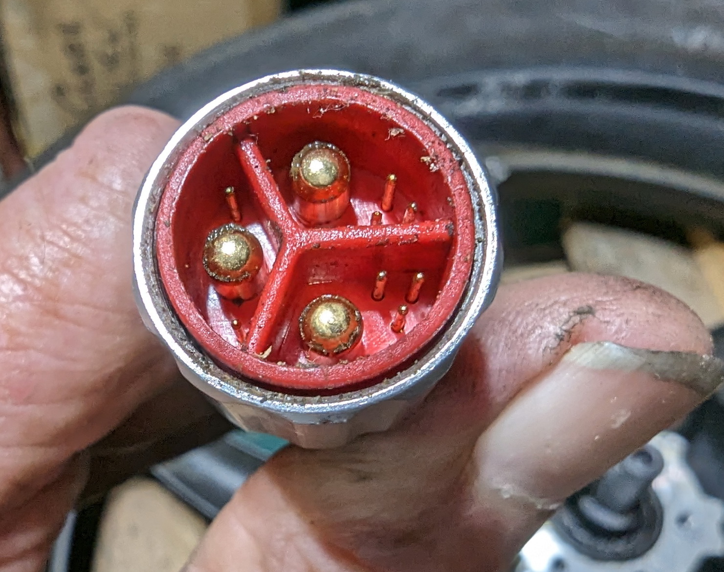

PS: The HyperScorpion motor connector has 11 pins, by my count, and I suspect that one issue with the tester is figuring out which wire is which.
That's a bit different than my motor cable and the KT controller that I installed.
My rear hub motor has 9 pins, and the only other pin I'm aware of is a motor temperature sensor pin.
Perhaps your controller is doing more communicating with the motor than I'm aware ?

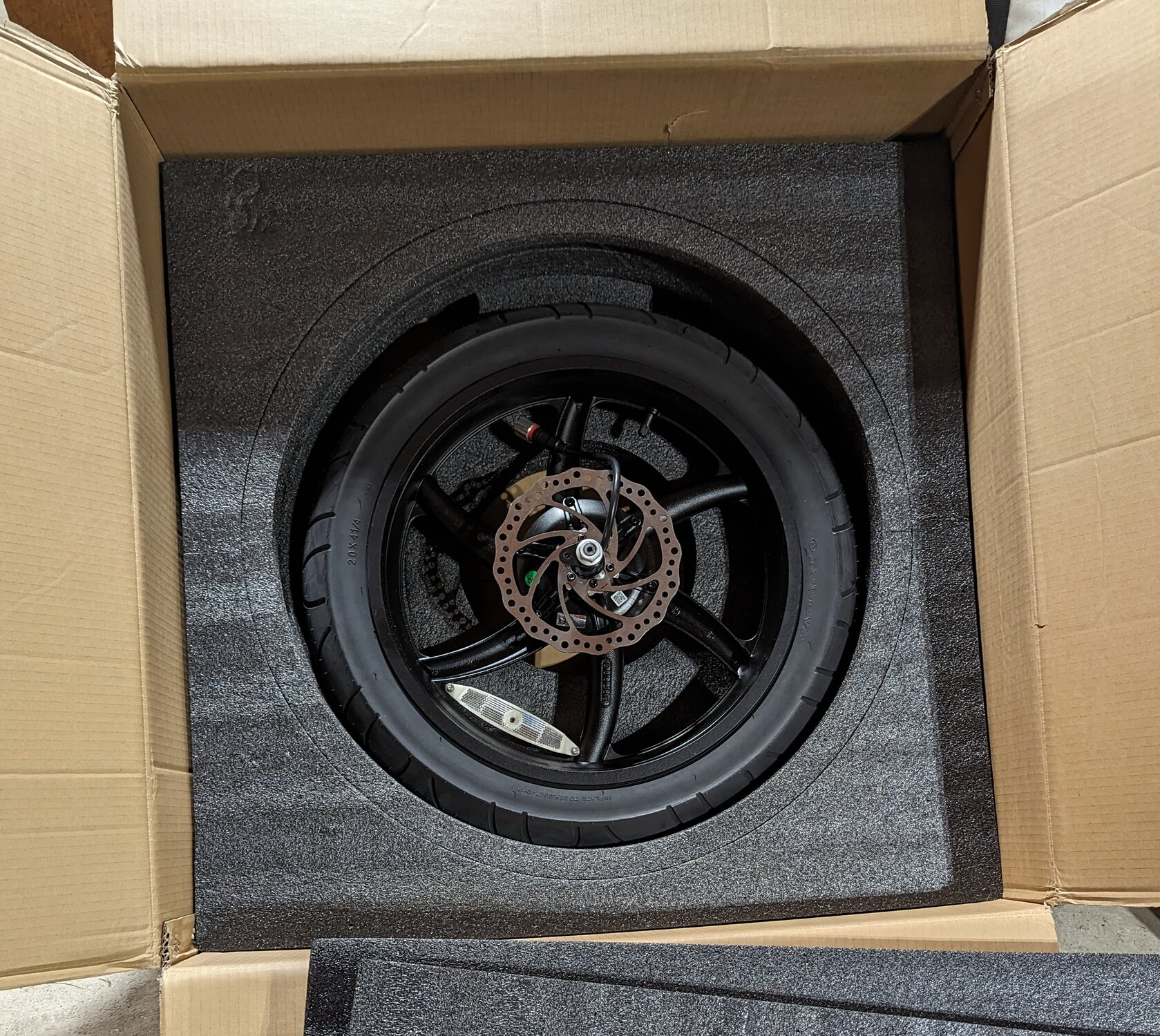

Happy to report that my HyperScorpion is running very well with the new rear wheel assembly. So it seems evident that the wacky speed readings and related issues -- even the mechanical sounding knocking with the replacement controller -- were all due to motor electrical issues, probably Hall sensors. I'll add that Juiced's rear wheel assembly is exceptionally complete -- right down to cable ties -- and seems quite reasonable at $525 total including shipping and tax.
