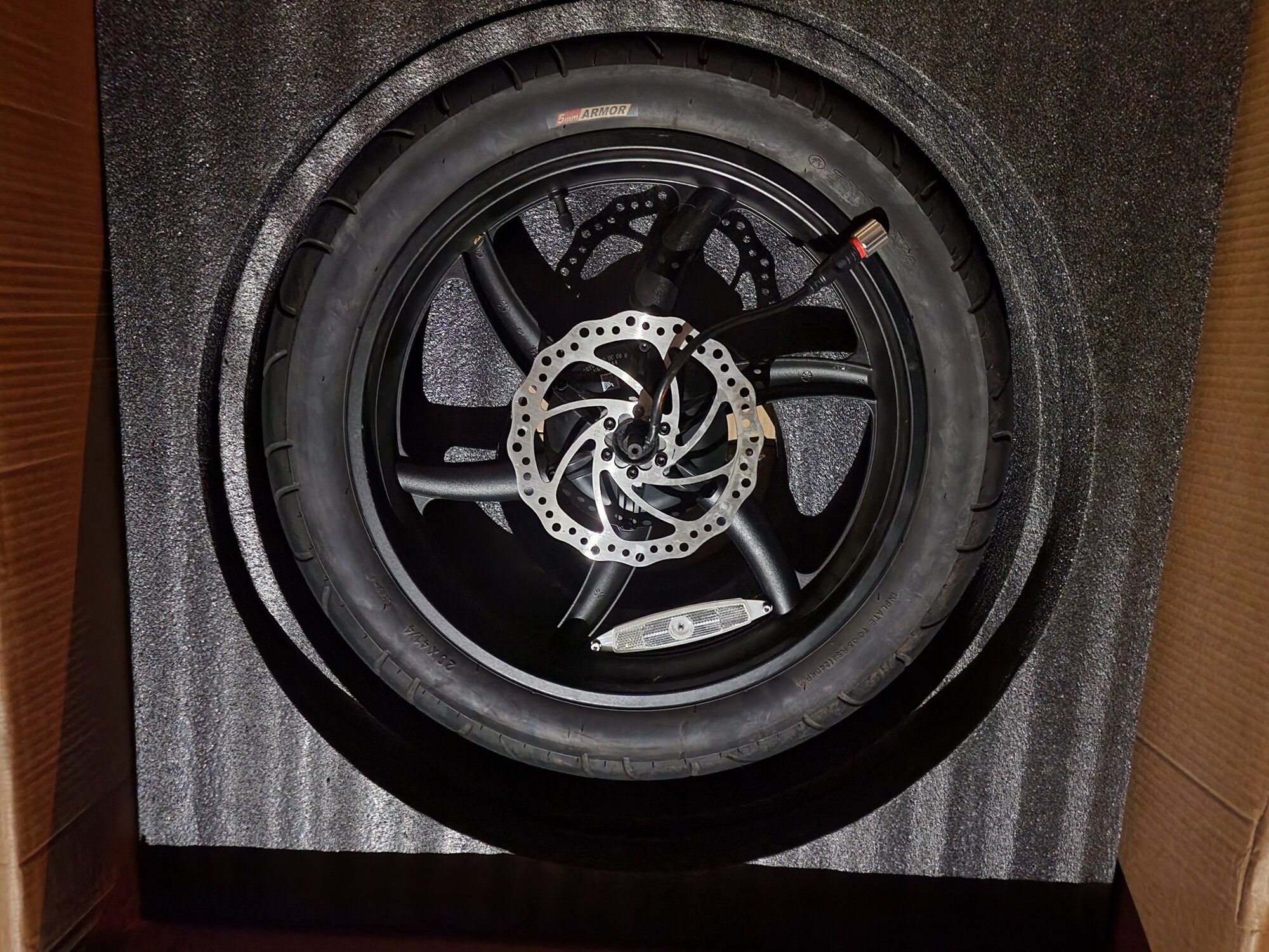

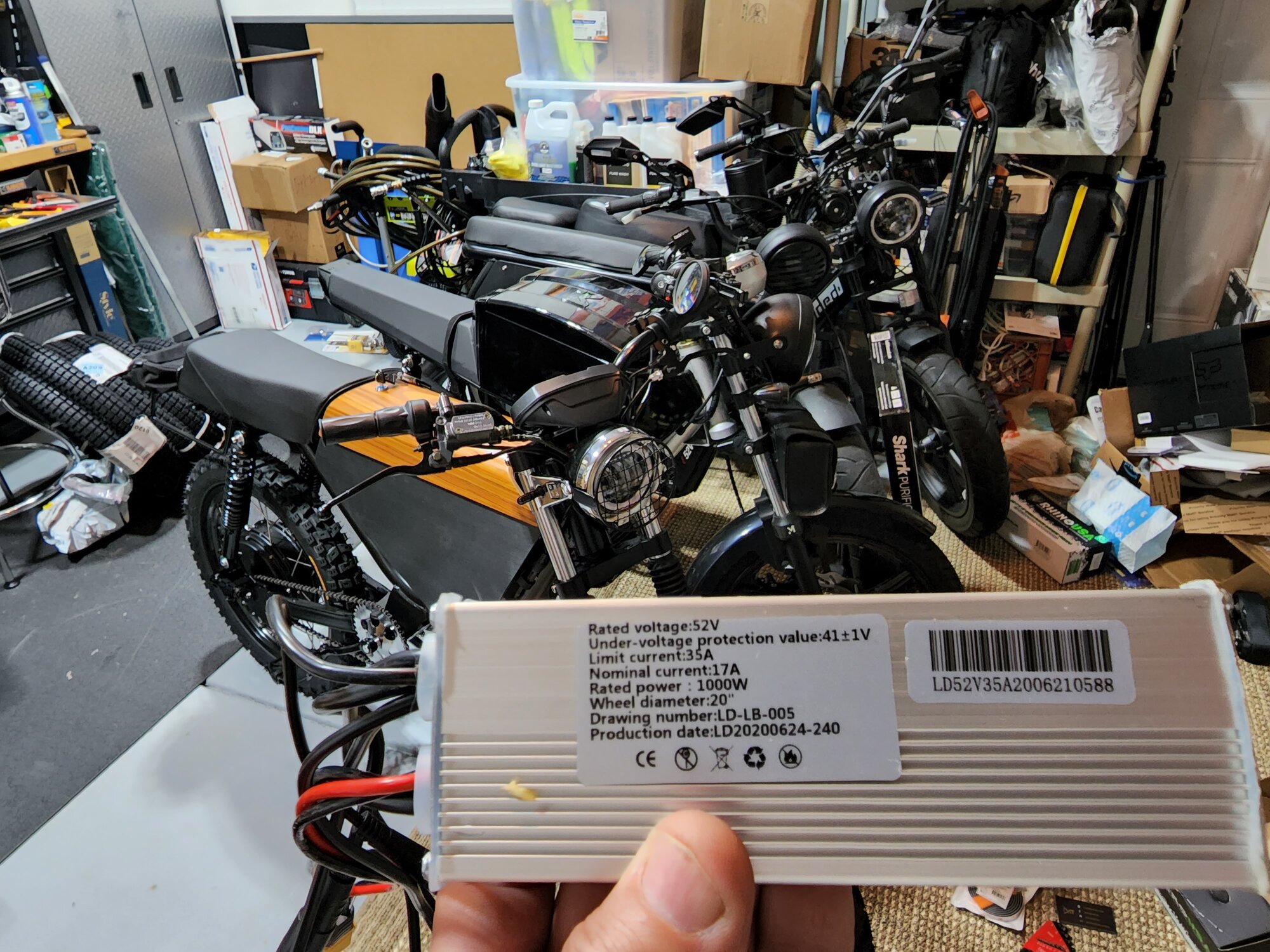

UPDATE!!! I received a replacement rear tire and motor assembly, installed it and still had the same problem, loud grinding noise coming from the motor. Frustrated, I watched some videos on YouTube and realized that people have also had motor noise caused by a bad or failing controller, so I ordered a new controller from Juiced Bikes and yes, the problem is now solved. Bike sounds like new and all is good.
