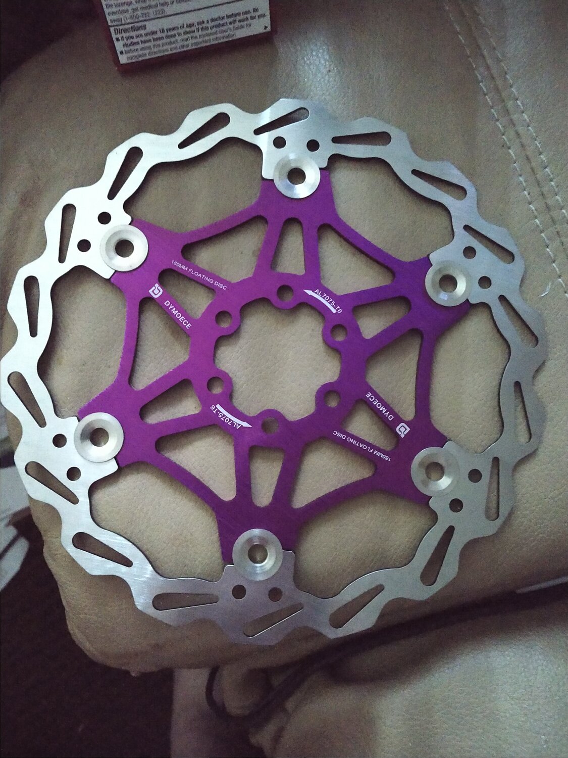

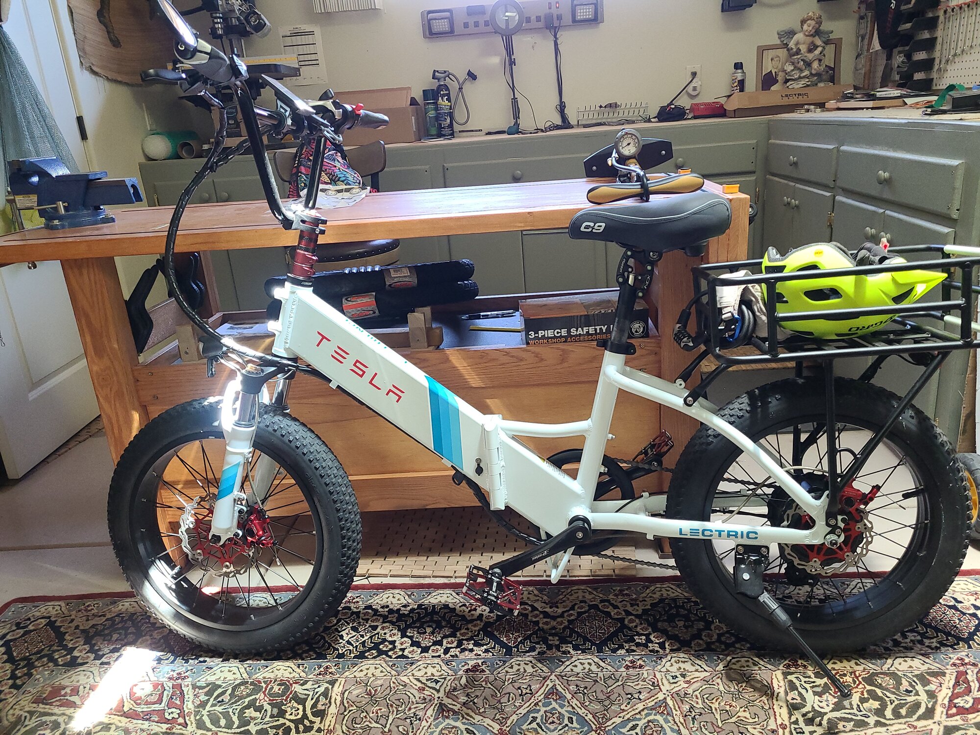

I installed the Zoom Xtech HB100 cable operated hydraulic brakes on my Lectric XP 2.0 step through. At the same time, I installed new 180mm front and 160mm rear discs and Jagwire cables and cable housings. Everything came from Amazon. Easy, inexpensive project and good results.

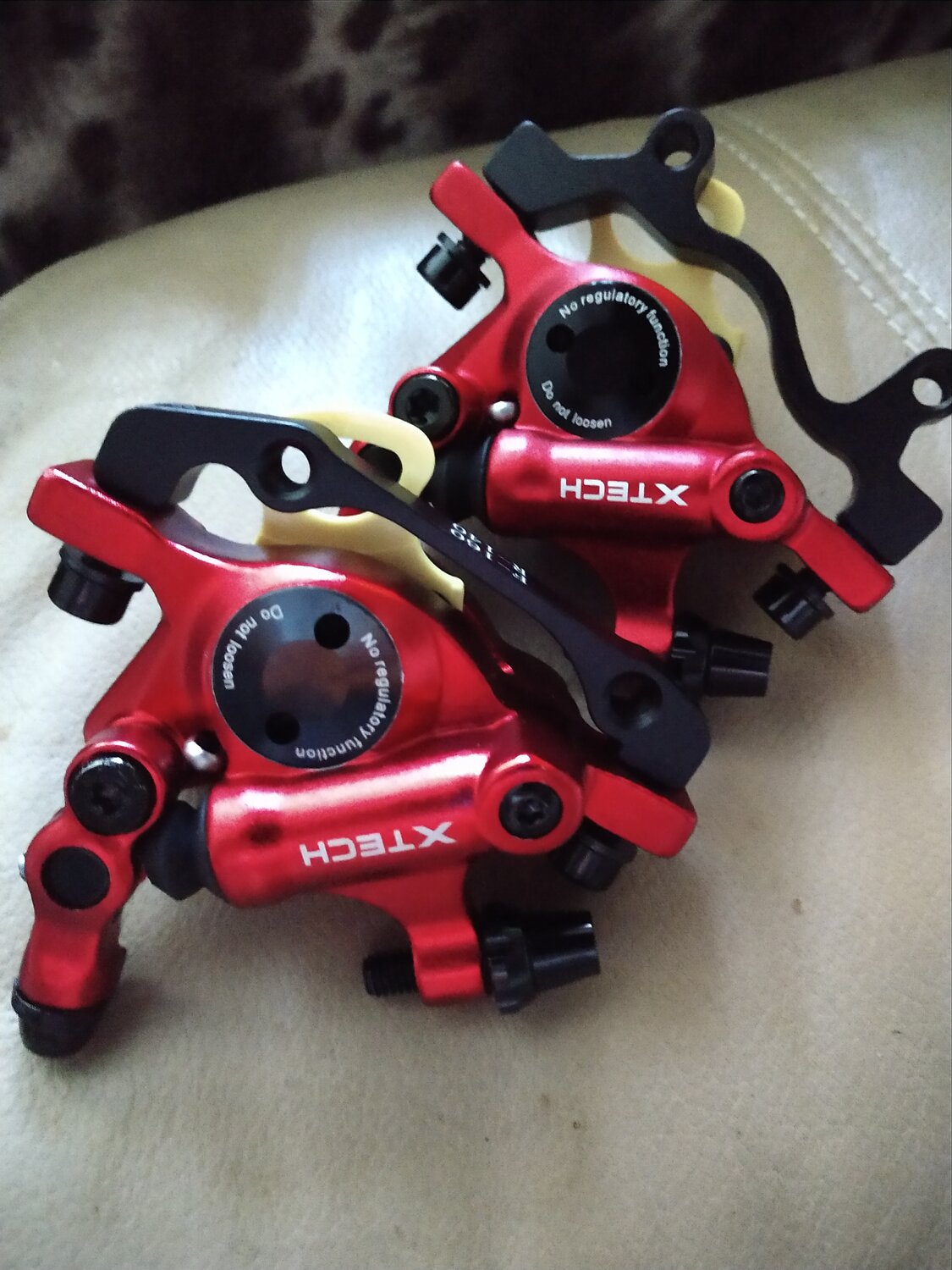

Waiting for cables $27 in Amazon

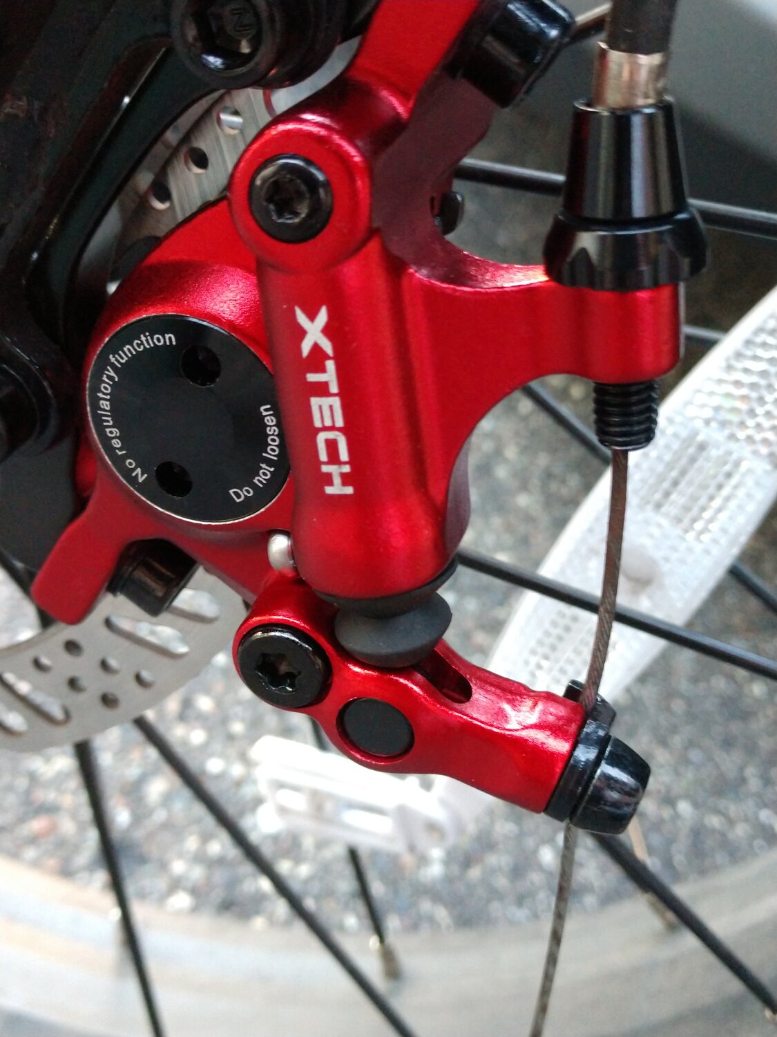

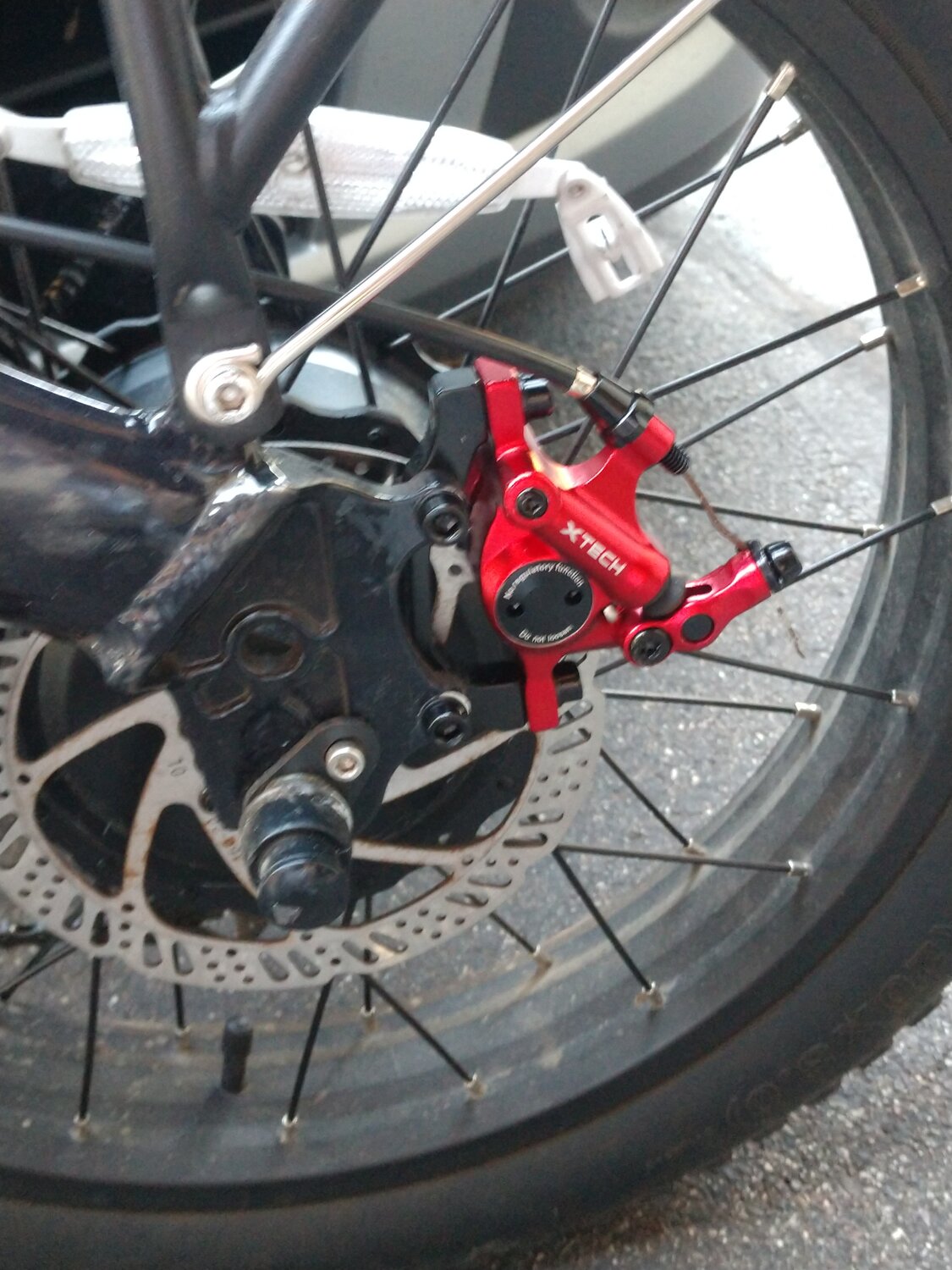

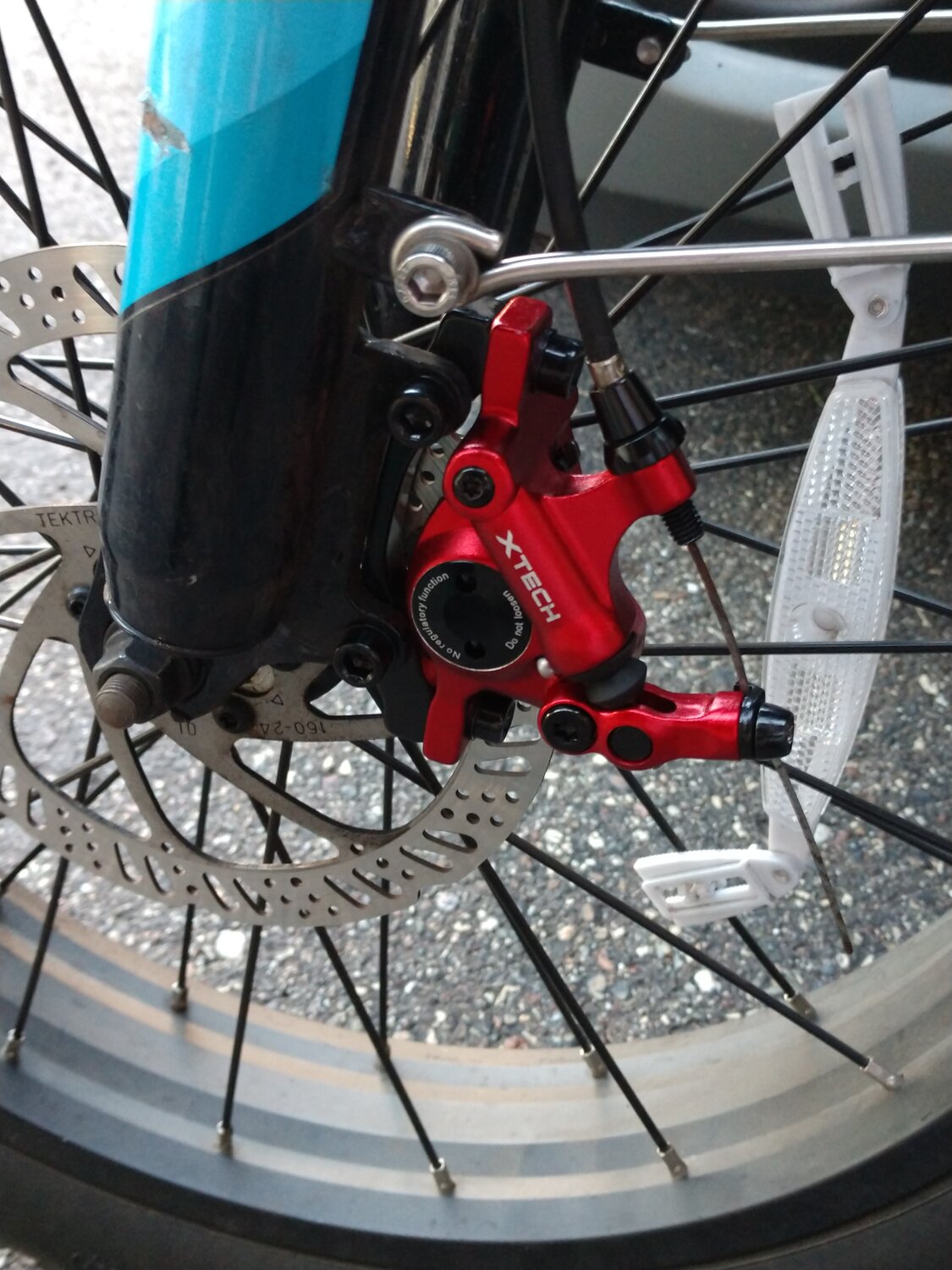

Installed used the bottoms of stock brakes to keep same height had to pull the front caliper towards the fork cause it was playing a tune on the spokes

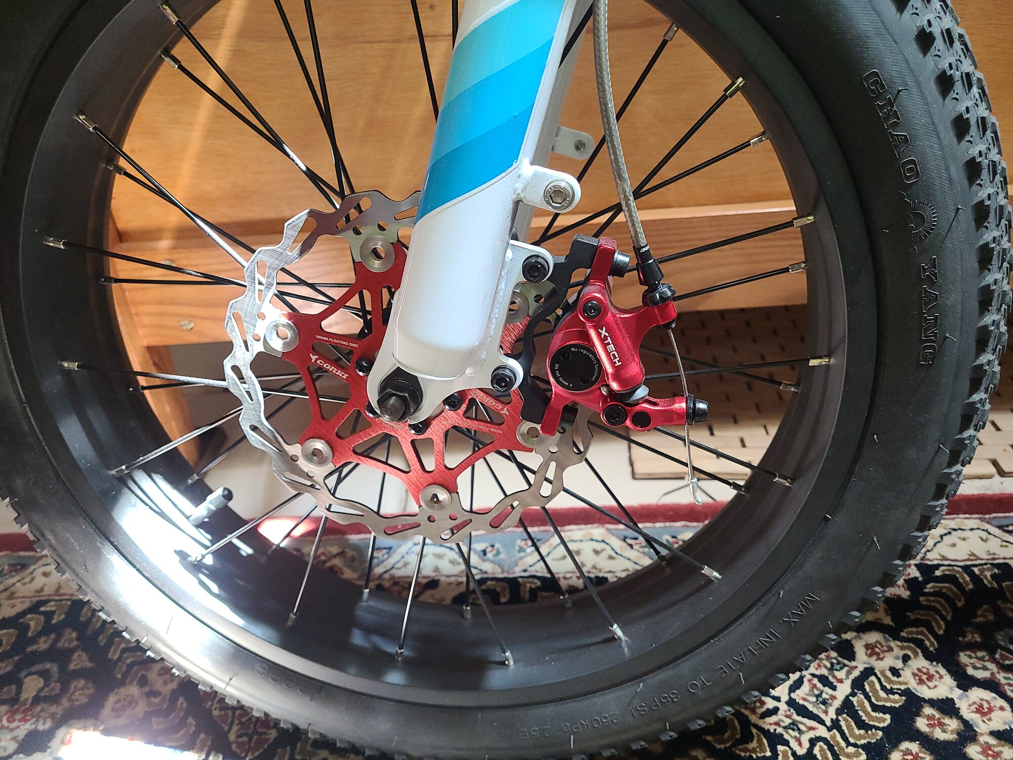

That is one of the reasons I installed a 180mm brake disk on the front of my XP 2.0 with the Xtech calipers. That places the front caliper radially outward a little bit so the Xtech caliper does not interfere with the rotating spokes.
