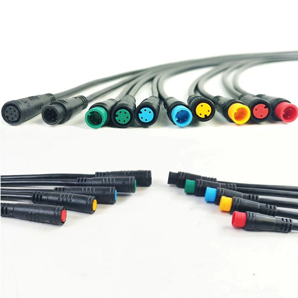

So has anyone found another brand other than Tektro from Aliexpress (that is much cheaper) with a Julet connector for the motor inhibitor that works?
@Timpo
I see many on Aliexpress with a 3-pin plug (unspecified plug type). If that is Julet would it be enough to just get a 3-pin to 2-pin Julet adapter?
This is an example https://www.aliexpress.com/item/400...earchweb0_0,searchweb201602_,searchweb201603_
I don't understand how Higo and Julet should look like.
That's what I thought!
Thanks!
Is there maybe a list with names of all the types of Julet connectors?
I don't know if they have names?
They're usually self explanatory, such as 2 pin, 3 pin, 4 pin, etc...
The weird thing about the Julet connector on the Moscow non Plus in that is not that list. I really don't know where they got that 2 pin connector from. Seems like they're the only one using it.
Sure I don't think that would be a problem.

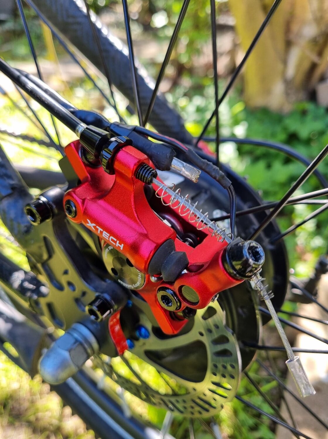

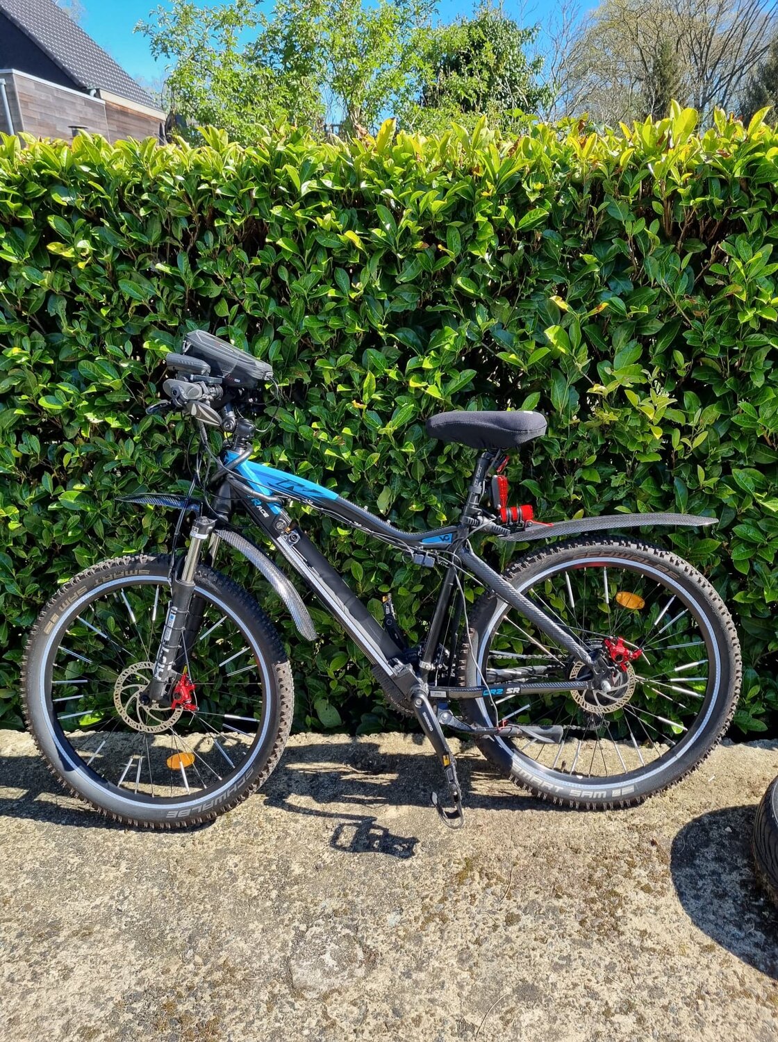

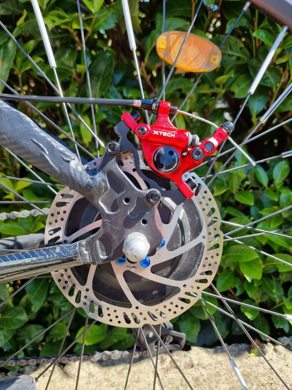

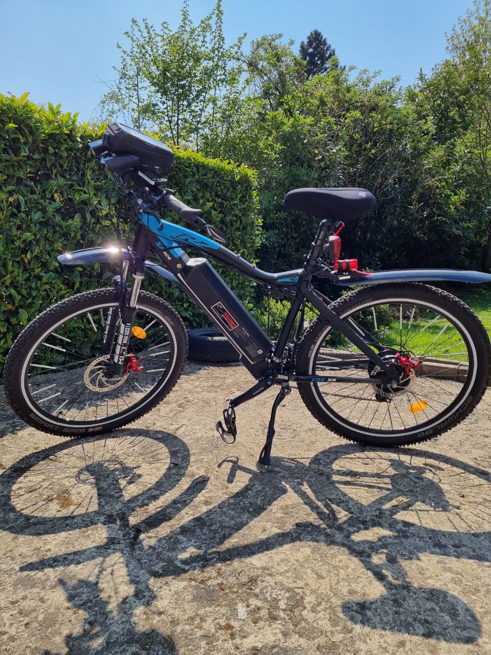

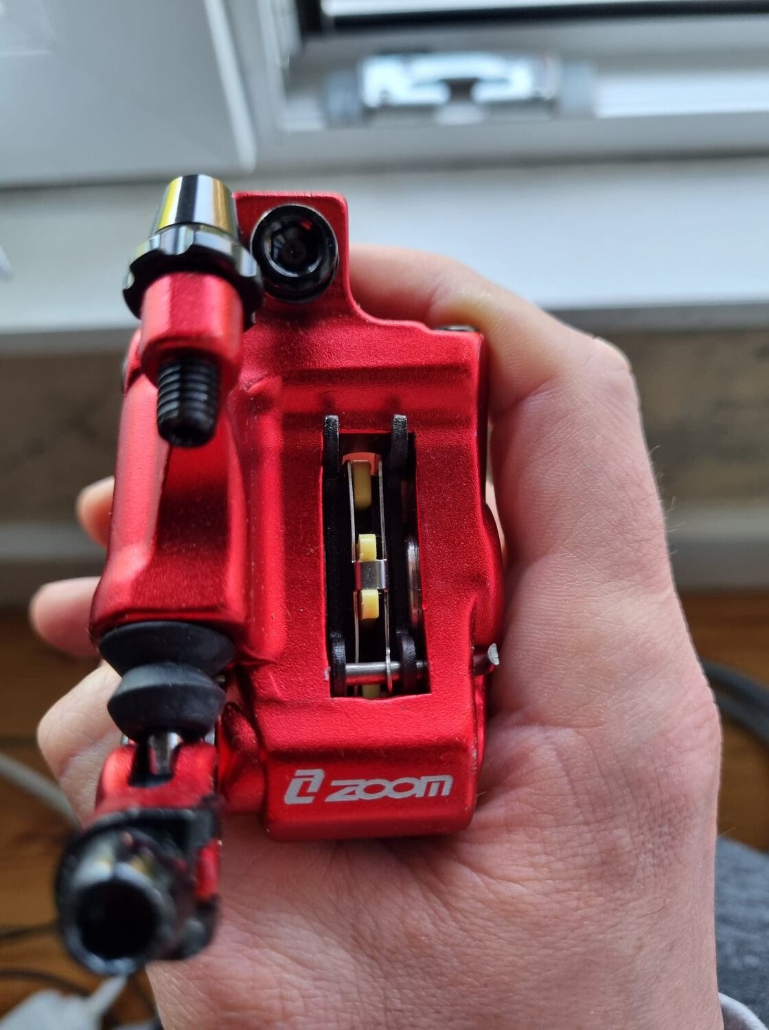

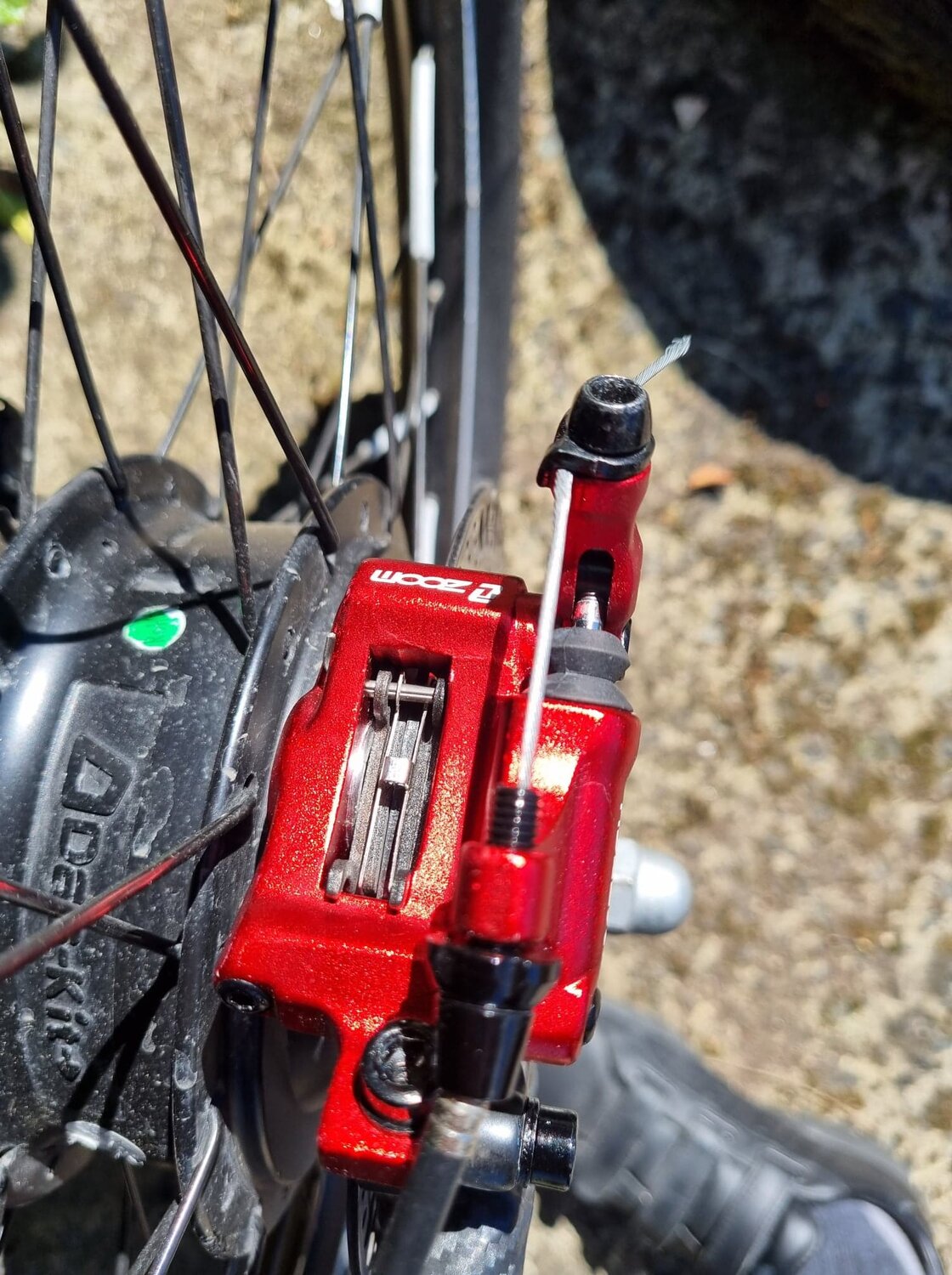

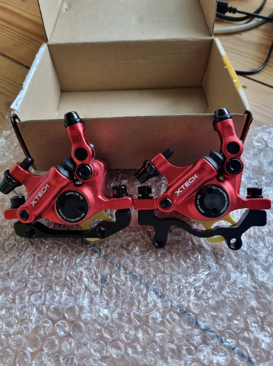

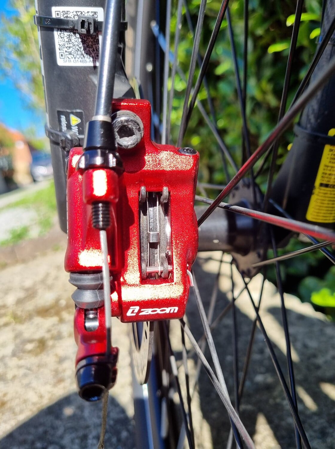

The brakes working well and looks nice. The lever is pressed hard like on mechanical brakes but has a double piston, easy to adjust,to mount and much easier to change the pads.
Interesting. So the cylinder with the fluid is part of the assembly that mounts on the forks? Unlike a conventional setup where the cylinder is attached to the lever on the handlebar with the fluid pushed down thru a cable?
Yes, the cylinders are in the brake system and normally there is no need to add fluid because it is sealed. But if it's necessary you have a screw where you can add fluid. I talked to the seller and he told me that there is no need to do that. You can see more tutorials on youtube about this brake, for only 36 € I think they are best buy.
The only thing I don't like it at all are the tektro levers, it's hard to press compared to other mechanical levers. I'll try to lubricate it, maybe something will work out.Maybe someone has an idea how to make the tektro levers to work easier or buy better ones. :) https://www.youtube.com/results?search_query=zoom+extech+hb100
Are they still working? I read a lot of reviews where people complained eventually it will leak oil.
