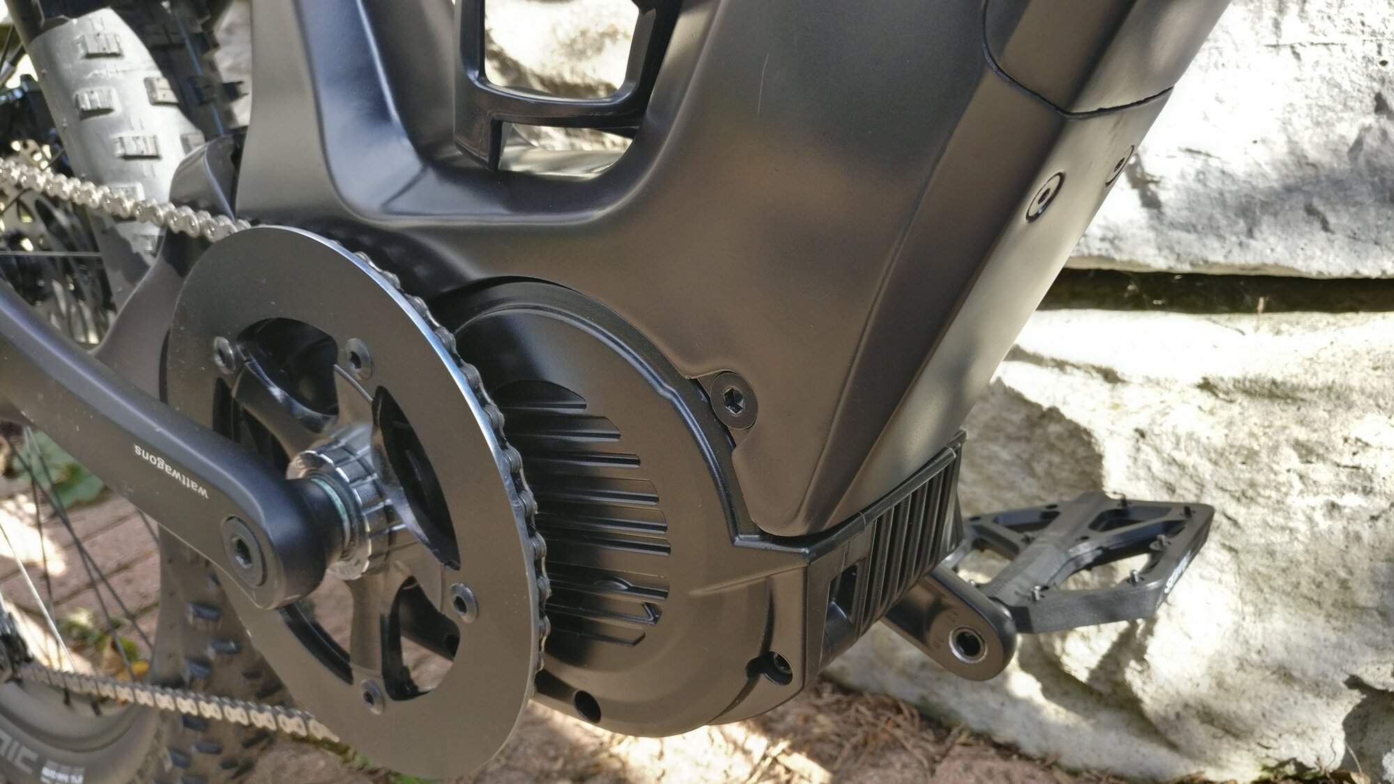

I also swapped both my stock M620 and X1 power cables for 10awg + XT90 from the board to the connector. Mueller Electric coolflex 45 has a thinner jacket than other high strand 10awg silicone cables - still a little thicker than the 12awg but still can fit through the motor grommet. This also gave me maybe another 8" of power cable and eliminated the APP45 connection in there. Unfortunately seems like my X1 shipped with a faulty speed sensor
