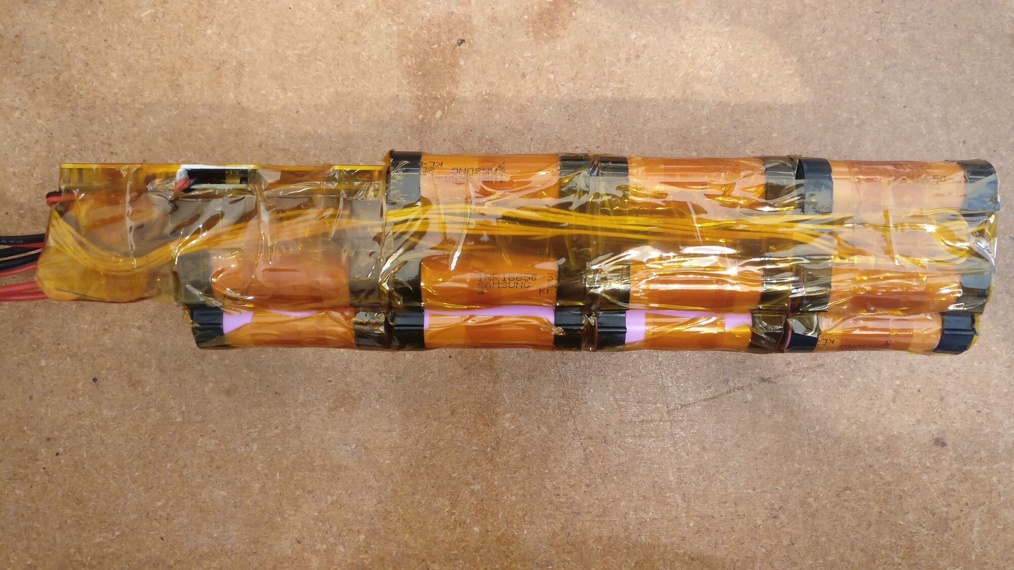

Hi, does anyone have a photo of a hydra battery where you can see the cells and the bms? so practically the 4 screws opened and the pack pulled out? br Andy
Welcome to EBR Acid. I will be interested to see this too. If no one posts one up my Hydra and extra battery are on the way to me now and I will take a picture.

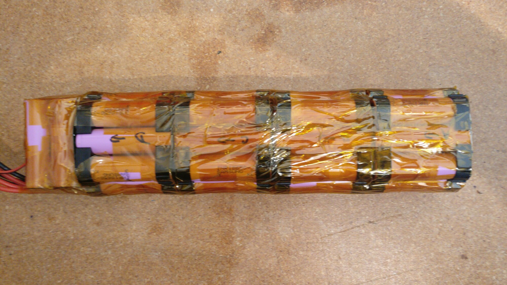

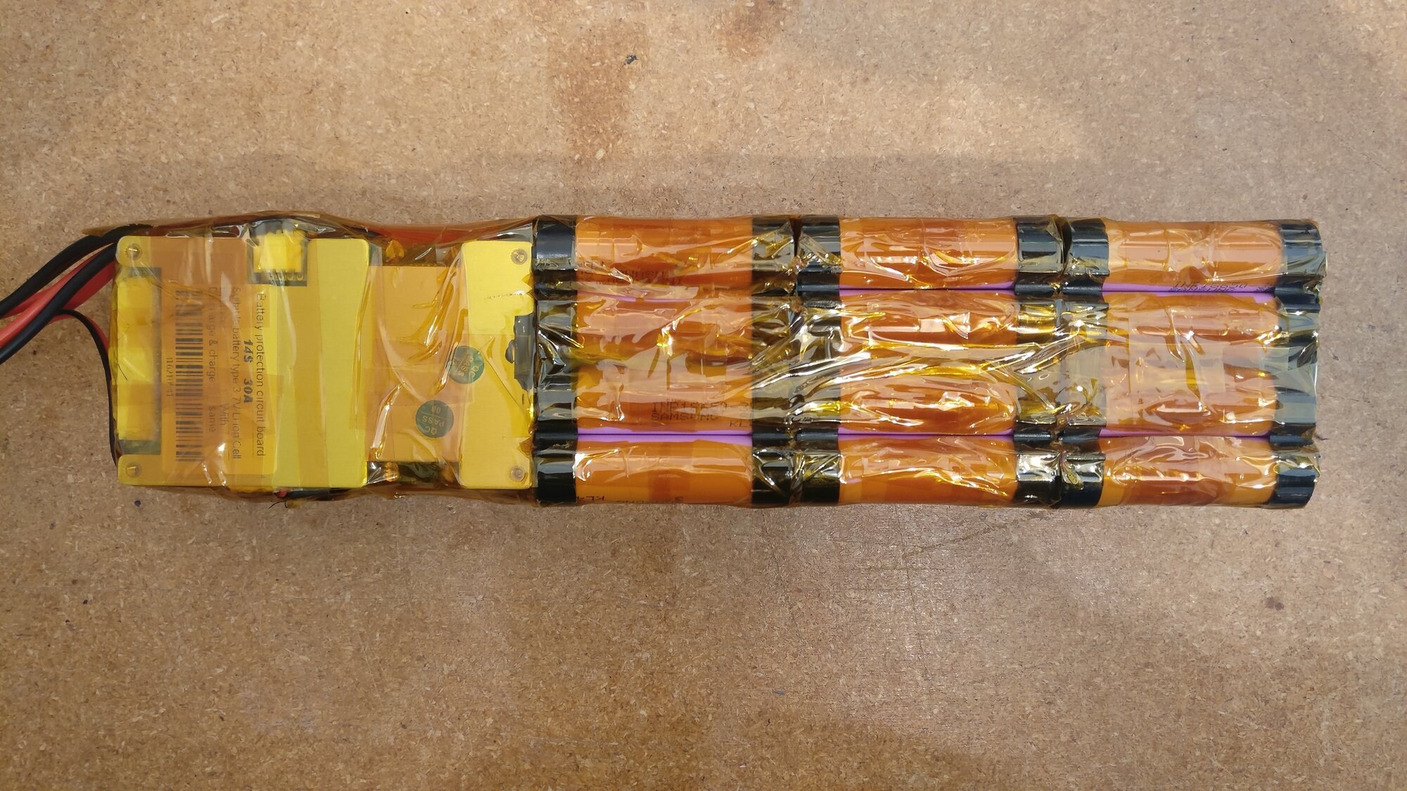

I don't feel like taking it apart again anytime soon but here's a picture and some info I posted earlier. There's not much to see with all the kapton tape.
My guess is there using a 14s 5p configuration and probably the Samsung or LG batteries rated 3.45mah or 3.5mah. Color will usually tell you which manuf the batteries are to.
14s5p is Not possible in the Original Case
I had the battery open to add an enable switch and you're right, it's 14s4p. We've been lied to. It's not 17 Ah. Now it makes sense why the BMS indicates a 14 Ah battery.

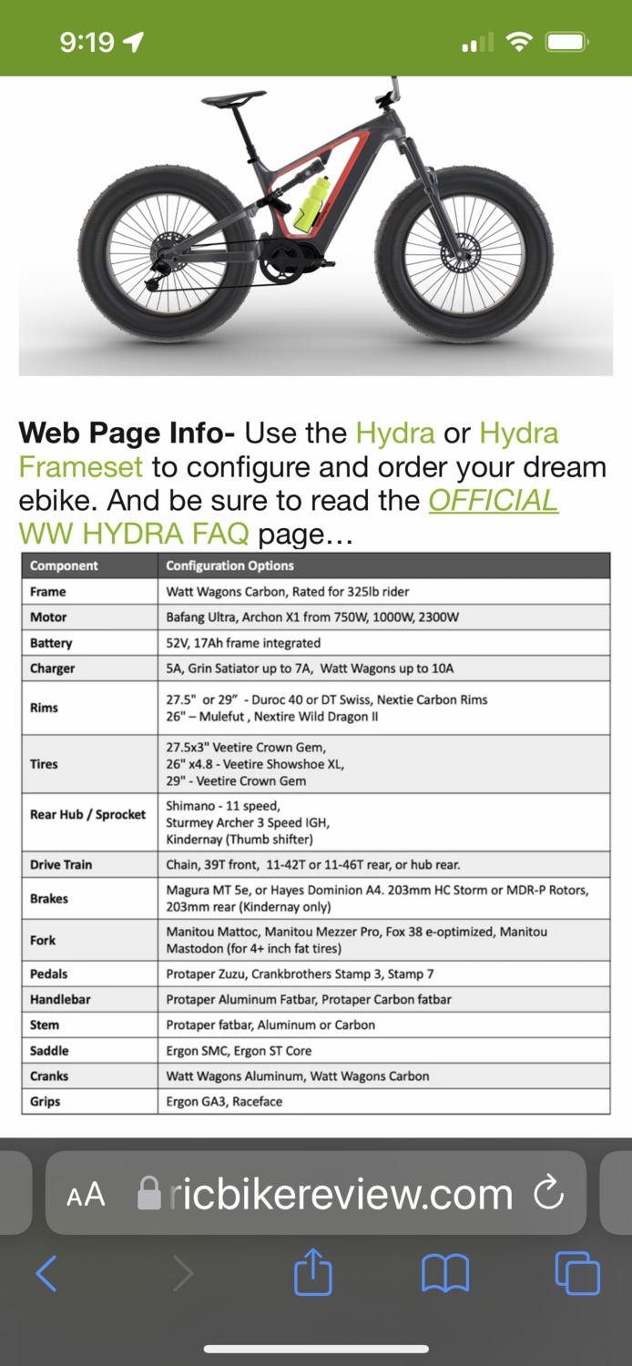

Ahh folks, please use the search tools and see what Pushkar has stated on the forum with “14Ah” and “17Ah” searches on his posts. The UCPro has a Shark like battery that is 17Ah mounted external on the down tube. The battery on the Hydra is 14Ah and inside the down tube…
Example search:
@bexamous i know you and others are disappointed with this news and yes I too see the bad advertisement on WW saying this is 800Wh. But if Pushkar was fibbing about 17Ah, wouldn’t he do a Marketing spin saying 884Wh or round to 900Wh??? I suspect this is a future battery that is being worked on and mentioned (see searches!). But regarding your 14s4p -vs- 13s5p; how would you get the extra 9 batteries in there??? Clearly the Hydra Black is 13s4p. I have tried Ultra and non-Ultra bikes with a 13s config (48V) and think the performance is the same as my 14s pack when on empty! I can tell when I am low voltage as performance is meh and the power display no longer pegs……
Thus why the Hydra Black doesn’t have 2.3Kw option….
52V times 14Ah (a Samsung IRL18650 is 3.5Ah per cell) is 728Wh….(roundup error?? IDK!)
-BB
That was old web page info I compiled from my notes. Please use the latest web page info. Thus the “Unofficial “ title! Thank you for bringing this error in my Unofficial post to my attention. I will try to fix that post and that of the Helios. But this was clearly a copy past error from the UCPro battery specs….
