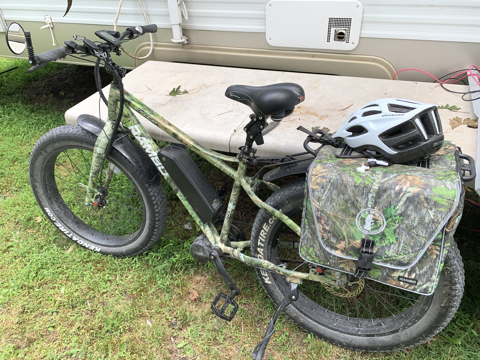

I recently managed to find matching camo panniers on e Bay for $69. RAMBO wanted $89. I’ve also added a Mirrcycle handlebar rear view mirror.

ps... Good score on the matching Rambo bags!

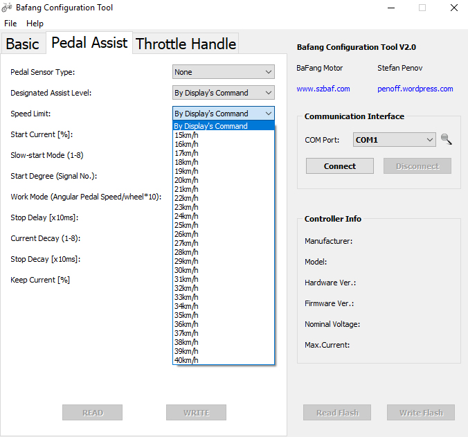

I just took the bike to a local guy who builds Bafang driven mid motor e bikes. He has all the cables and software to “jailbreak” my motor controller, and just reprogrammed it for me to increase the top speed from 18 where it had been set by Rambo to 24mph. That’s more than enough for me for now. (He could have set it at 30mph.)

I recently managed to find matching camo panniers on e Bay for $69. RAMBO wanted $89. I’ve also added a Mirrcycle handlebar rear view mirror.View attachment 61032
Hey Brian
I don't know what “jailbreak” is. . and he may have some software that I haven't heard of. But the readily available software allows you to make several changes to the controller including setting the Speed Limit. Since you don't have a Windows pc, next time have him set it to " By Displays Command" this way you can continue to make future changes as you like using the display. The Speed Limit can be set for both the PAS and Throttle independently.
Hey Brian
He had a Luna controller box that he plugged into the controller cable. It brought up all the standard parameters the cable and Windows software would have, and he used Luna’s settings for the BBS02. We set the top speed at 40kph.
As soon as the rain lets up here I’m going to take it for a ride and see if I like these settings. Ifnot we’ll tweak it some more.
Coolio... 👍
It's nice to tweak it to how you ride. I like my BBS02B much more now that it responds as I want. I found the stock parameters way to jerky and aggressive. Feels much more fluid and refined now.
