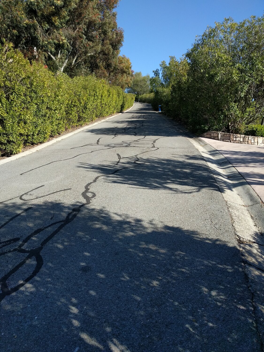

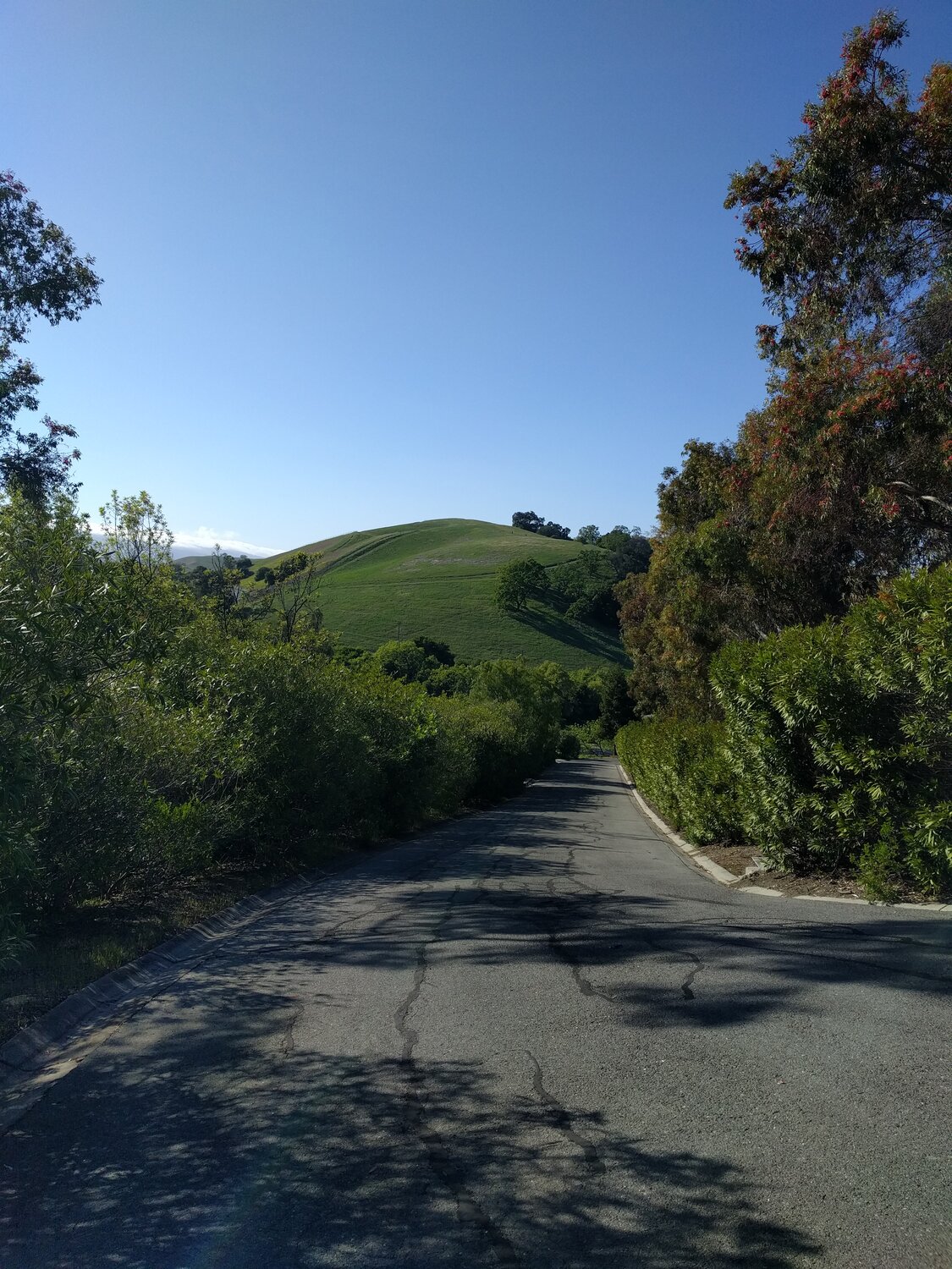

yep its at least 20% grade or a bit more. my garmin wont get the cal;umation in time before you run out of hill. its a bear one of the steepest I have found.
I couldn´t get up the upper of the 2 hills on Egg & I road in walk mode. No point anyway cuz I´d have to
come back down the way I went up. I hit 38 mph goin´ down the lower hill. I´m not really prepared to do
80 mph comin´ down the upper one.:eek: In a car ya need a 60 mph run at it. My van would never make it.
Thereś a hill south of Sequim looks just like your picture.

ya I dont know how fast it would be going down. there is another one by my daughters house thats a hair less then this guy. on the tandem I don't want to know how fast just coasting would be. before upgrading the brakes we could not even stop on it. but it was great for breaking in brake pads.
And I thought we had hills!
so this hill is no problem?
What is the location of this road? you can compute the grade from google earth.
It will depend on the rider whether it is a problem or not but it looks doable.
Several climbs that I do regularly with my regular bike, mid drive and direct drive hub. first and last are %20 when measured from google earth. The middle one depends on how you traverse the curve. I can do all of them at the lowest setting on my direct drive(which should be a worse climber than geared hubs if gearing is right).

it is in portland oregon. I tired measuring with google it but its pretty short but it feels a little over 20% grade.
Looks like the one on Egg & I Road; reminds me of an olympic ski jump comin down. Why? Have you
climbed it? Looks to gain 120 ft in 200 yds or less. Egg & I isn´t ´that´ steep but it´s 3 times as long.
Thereś one like that leaving Virginia City on the way to Carson City.
do you mind telling what portion of egg and 1 road that hill is? trying to calculate the exact grade on earth.

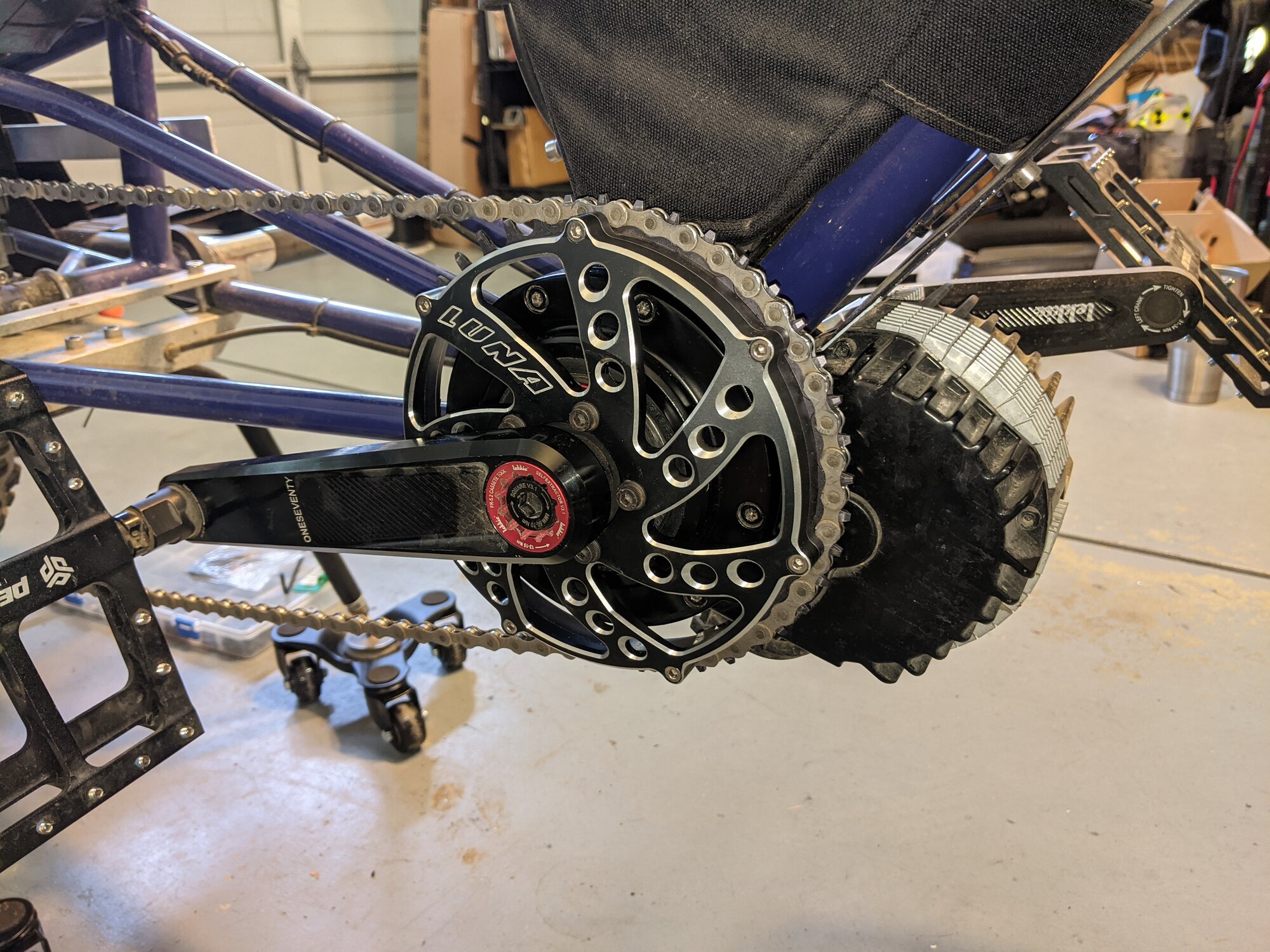

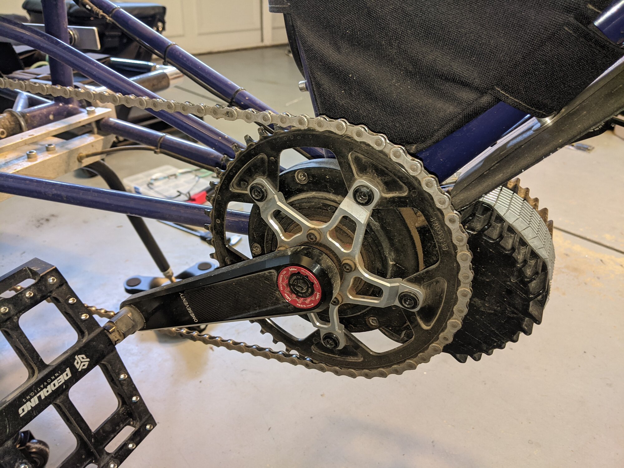

I spent the morning changing the brake pads on the BFD ... and then giving myself a leg up for my next run up that chute tomorrow. Was 48T with almost no offset. Dug my Eclipse out of the spare parts bin and used the 42T ring. So less teeth and enormous offset now, so it will be happy on the inner cogs. Ascent should be no problem now but we'll see.
I'd make the run today but today's ride is to the grocery store lugging back a full load o' supplies.

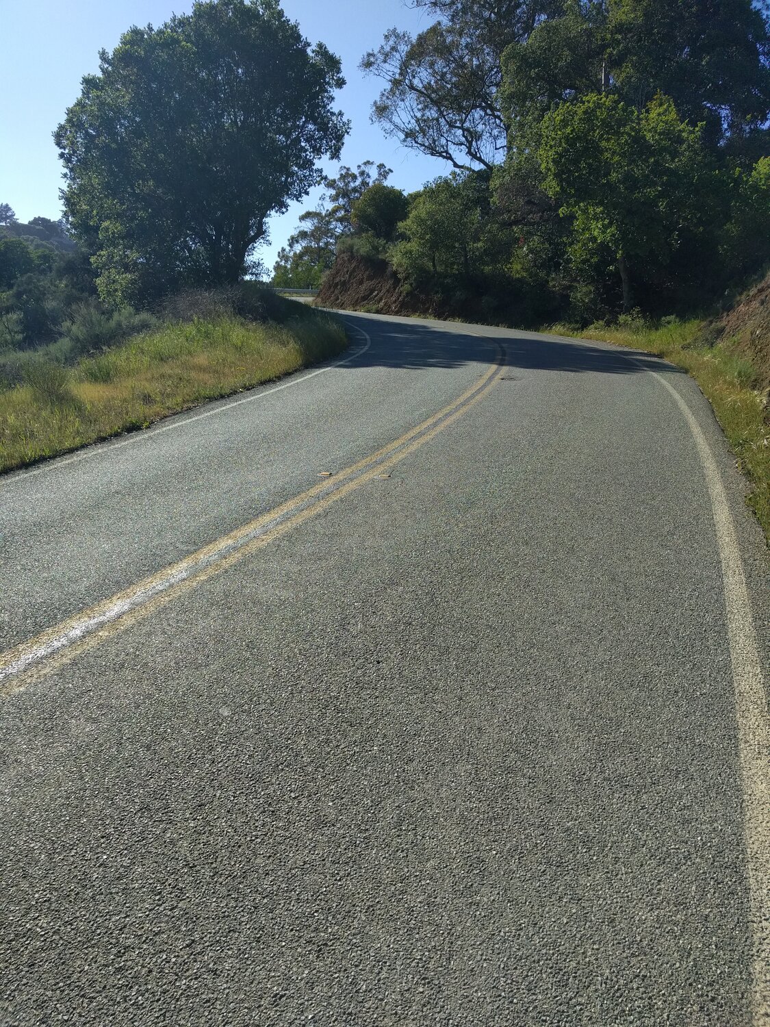

I tried in terrain mode but didn´t get sufficient resolution to see any topo lines. The steepest part runs west
just b4 turning south to dead end.
You don't need to see it, in google earth just measure the distance between two points that you like to find the average grade, find the difference in height in between end points and divide it to the distance. The desktop version of earth actually have this as a feature built in but the web version does not.
I don't know if this is the part you mentioned. This section that I draw is 250m long and the elevation changes from 92m to 117m, 25m delta, hence the grade is around %10.
