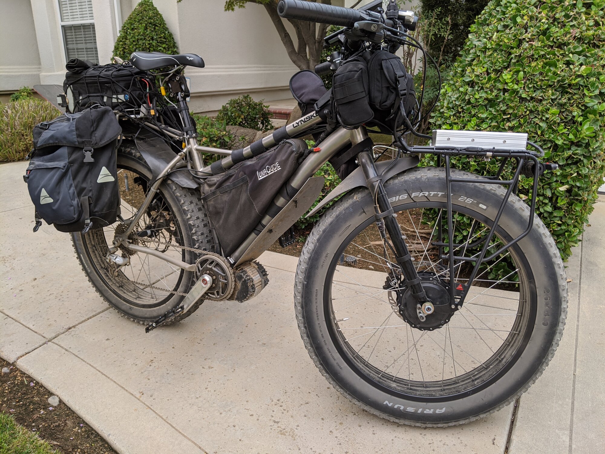

Hah thats my article and my bike. The pic that you showed was it being all cleaned up. Its all dirty again as of yesterday. Not as bad as it is here, but dirty is its native state.
As I said in that article and the companions to it - from experience actually building bikes that are all more powerful than anything that can be bought retail:
  • Single (rear) geared hub drive is out of its league overland. Period. I am talking 80Nm bigfoot Bafang 750's with a 35a controller and a 52v battery. Reason being it is singlespeed and powers the bike thru the axle. You try riding with no gears up a hill and see how you like it. Motor may be powerful enough to get you by but it is by no means in its element. Want to upgrade that hub to 60v so it is running 2kw continuous (it can take it)? It will be good (40 mph) on the street but overland meeting resistance from muck and reeds etc... you'll peanut-butter the nylon gears.
  • Dual geared hub has all the wonderfulness of awd but is still saddled with the axle-powered singlespeed thing. I could get my 4kw+ 2wd geared hub bike to climb anything, but my ears told me the hub motors would not live forever and I want forever.
  • Mid drive alone is good enough for all overland conditions. There is a reason all quality eMTBs that are not the budget version are mid drives. It will not set the world afire with speed, and a conversion bike has to be built with more care, planning and experience than a hub bike, where all you have to do is mount the motor and run some wiring (kind of).
  • AWD Mid+hub is the best of the AWD concept. Its an absolute mountain goat. There is a learning curve associated with a powered wheel on serious singletrack but the article gets into that.
