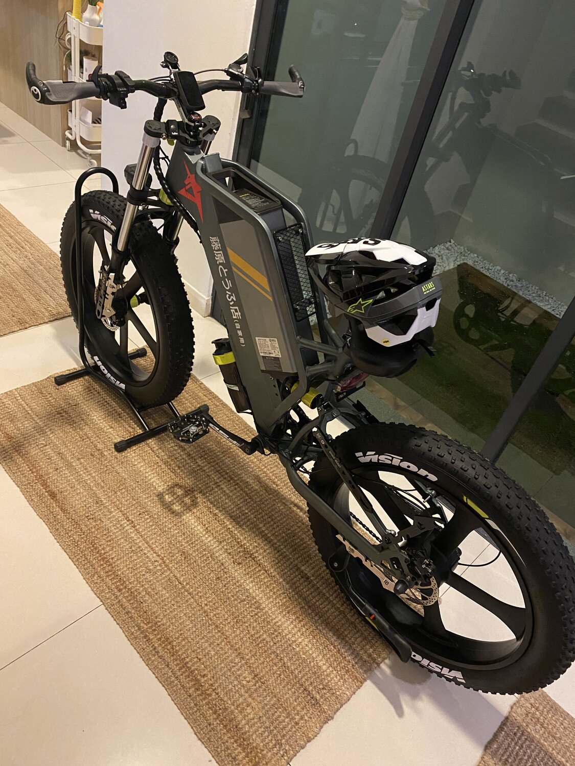

Just got my bike last month, it FTN/Coswheel T26

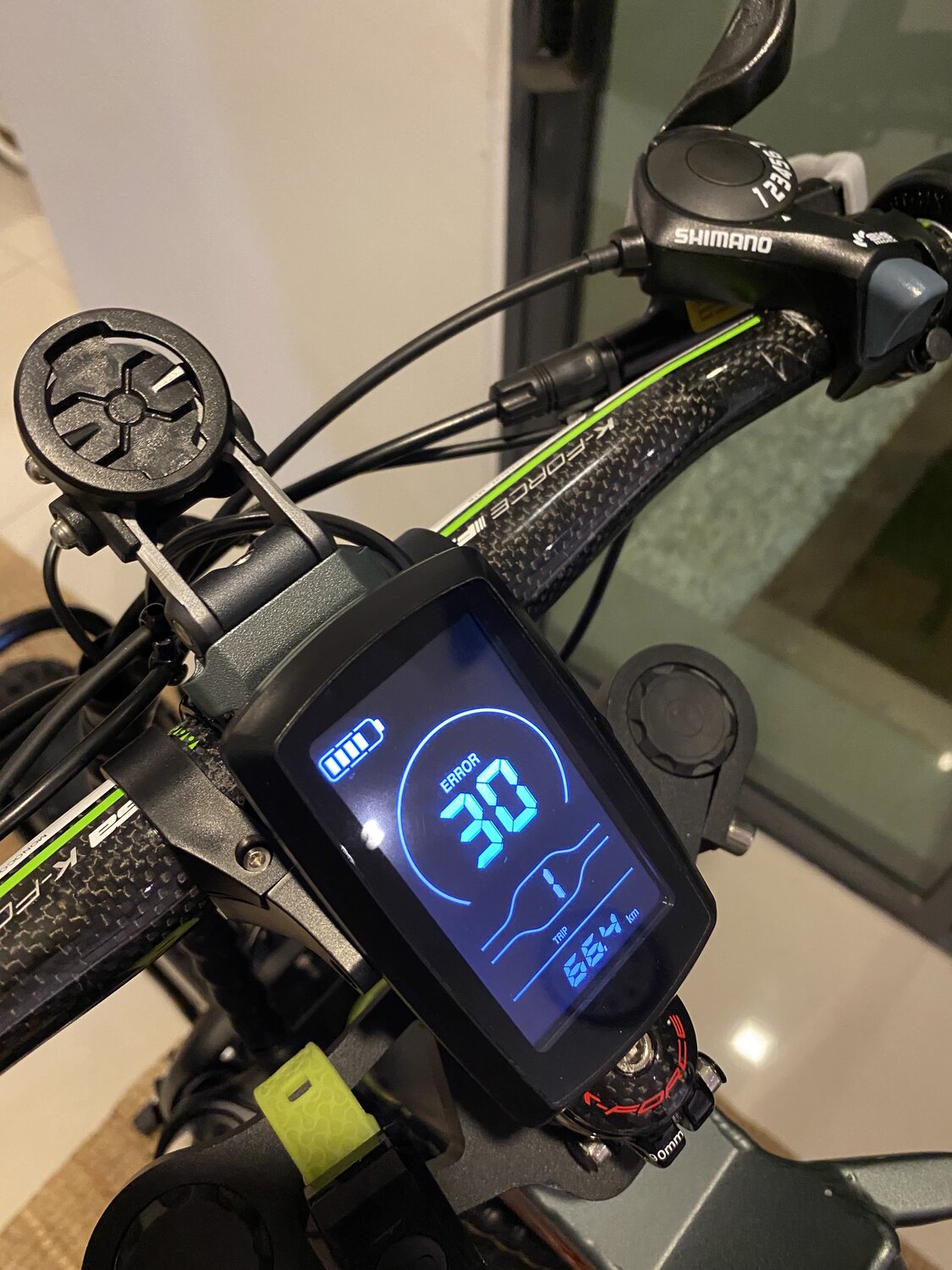

quite heavy bike. I'm trying to replace the stock twist throttle with a thumb throttle and got myself with Error 30.
Appreciate any advice regarding how to troubleshoot this mysterious error. Thank you

What number display have you? looked up error 30. It´ś a communication error either
with display or controller. It talks about a default setting. Check error code 30 online.
my guess it involves the display?
