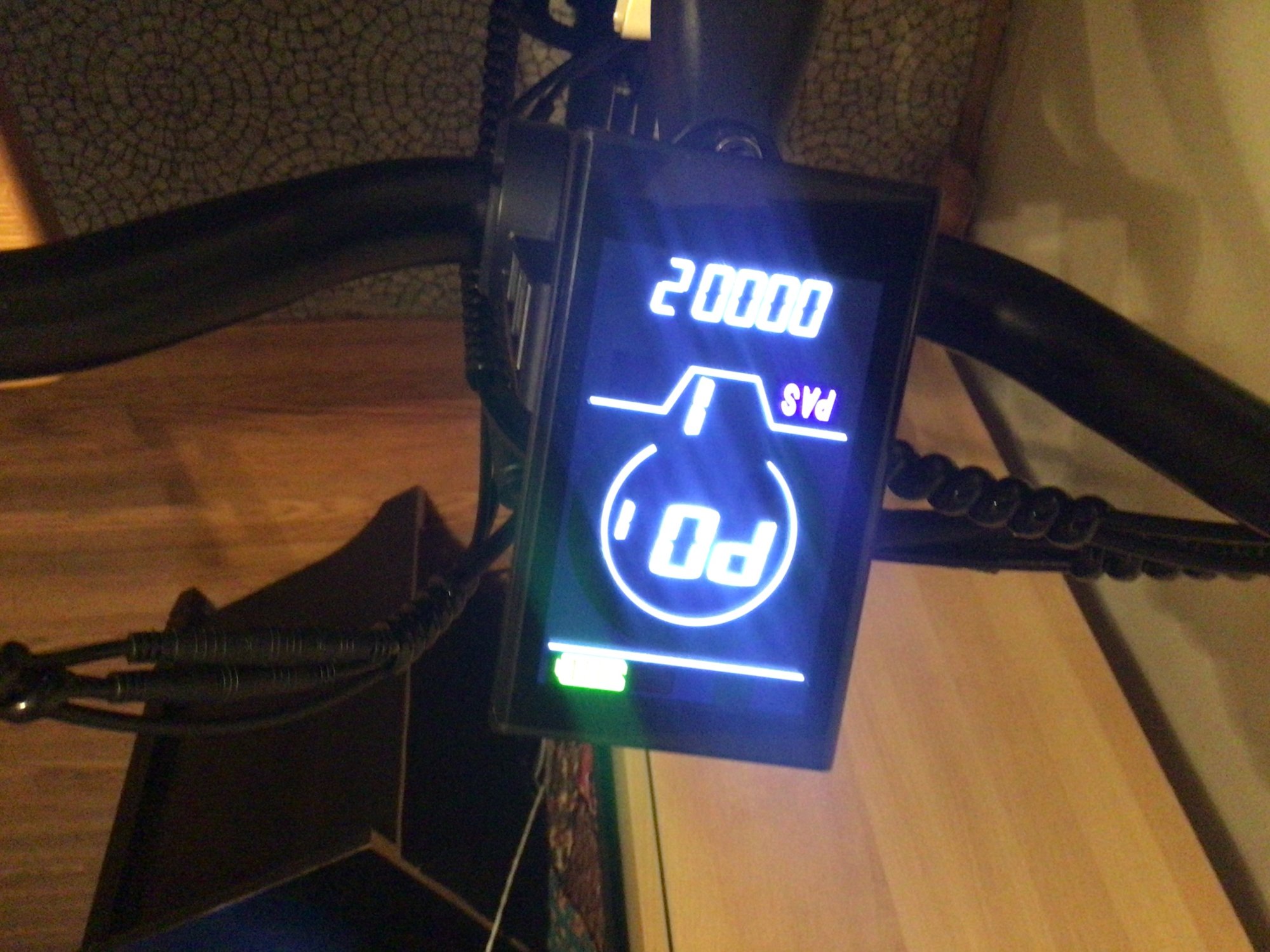

As for option 2) … These pics are upside down when uploaded but not otherwise…but they show the full range of my options. 5 speeds. Po1 and po2. And they show how the wire is connected. I think I can? Merely unplug the wire without it being damaged by unplugging it to check it is 5 pin, and then order similar 5 pin one on Amazon that allows option to change speed. Perhaps I should order multiple screens and return ones that don’t work. Here is Amazon one i am thinking of.

I have a 500w hub motor and it gets up to 1200+ watts. All depends on the controller and what it will pull.
There are ways. Firstly there is the metric conversion trick. Set wheel size to 60% of its true value and the display to metric. Now the bike will go 40% faster and the speed will be accurate in miles per hour. Next long press Up and Down to see if a sub-menu pops up. Tab to Speed Limit, and set it anyway you want. Report back.
I’ve tried that. But I don’t think I have a speed limiter to begin with. I mistakenly thought that due to misunderstanding peak watts for regular watts. I thought I have 1200 regular watts but really I only have 350 regular watts. And I doubt that gets faster than 35kmh anyways.
Yes, a hub-drive with 350 is less than half of one horsepower. It is okay for high-end, super-light mid-drives.
