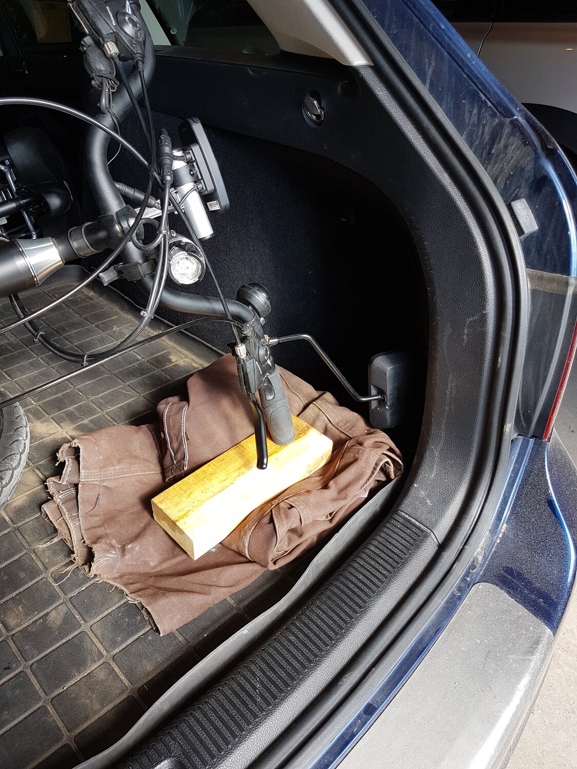

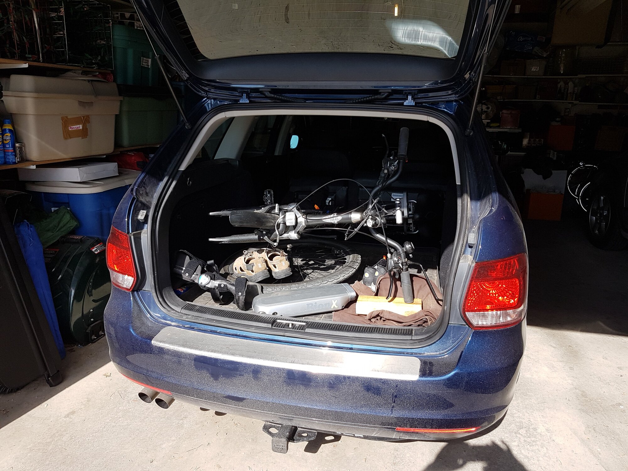

Tried out the back f the wagon today as compared to my usual hitch mounted platform rack. My reasoning is I intend to head to the Rockies to ride with some friends that live in Canmore Alberta, and I try to limit the time my bike is on a rack at highway speeds. Speaking of speeds, more on that later.
My Townie fits fine, so I am very confident that when I get my new ride, it will fit also.
I have a mirror that had to fit, and a scrap of wood worked OK for a test. There's a small well area that fits it.
