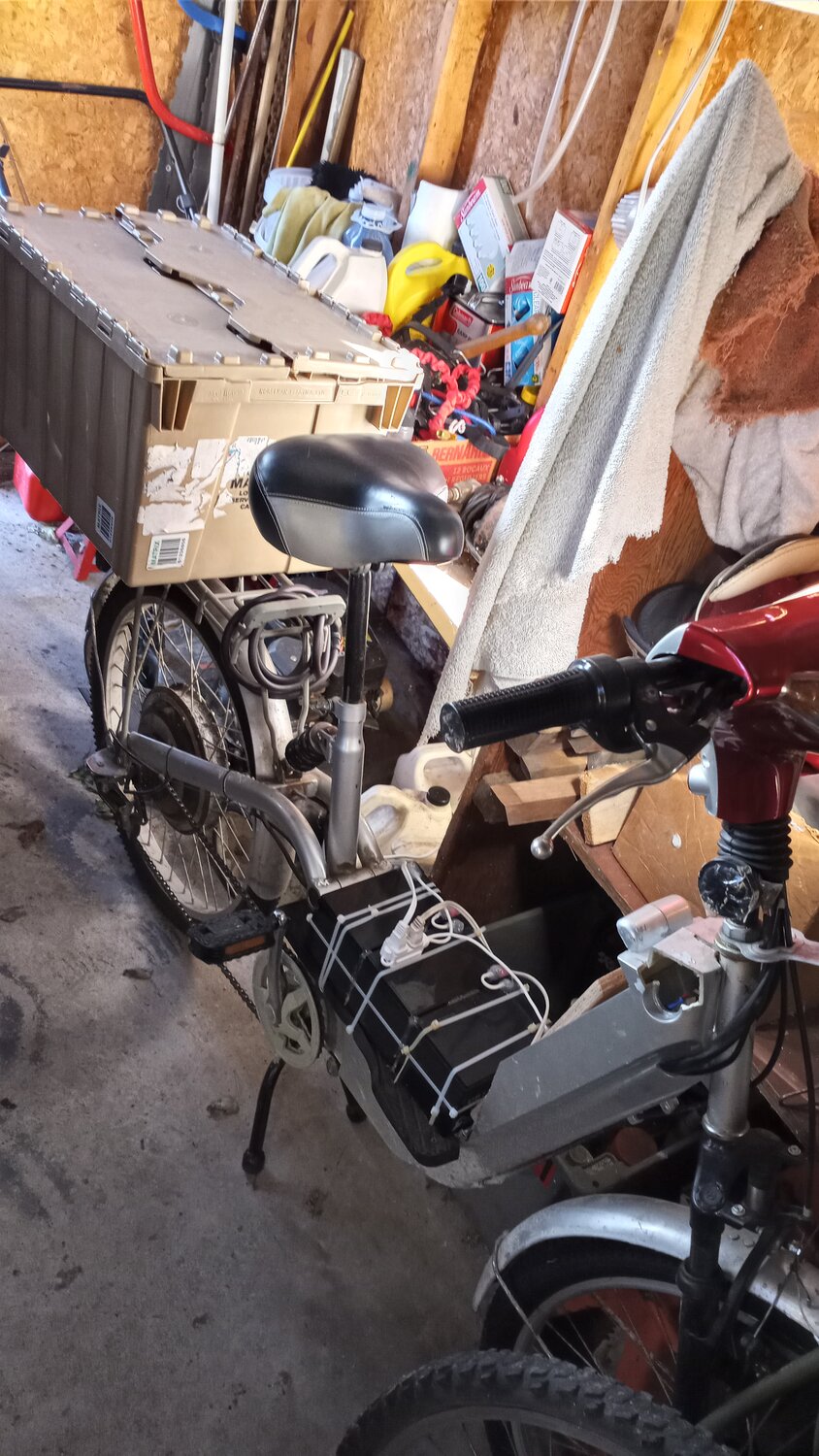

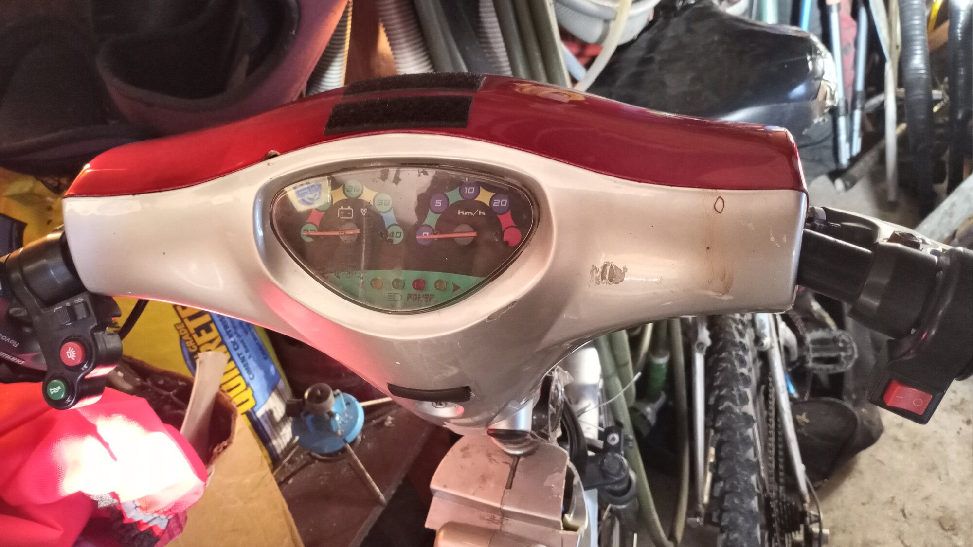

Oh, I didn't think of that.
Interestingly, I've got an old e-bike that has the twist throttle on the right for the North American market, so now the gripshift is on left with the numbers upside down and it rotates backwards.
View attachment 168586View attachment 168584
It's got a direct drive 250 Watt motor with regeneration.
The power cuts out at 22 kph, then the regeneration kicks in at 25 kph to prevent you from going any faster.

I was out for ride and I noticed a guy on a 10 speed gaining on me fast, so I started pedaling.
It got harder and harder to pedal but the bike Would Not go any faster than 25 kph.
It was embarrassing to be passed by an acoustic bike while I was on my powered ebike.
I did notice my voltmeter shoot up to 42 volts, so at least I wasn't wasting all my effort, but it doesn't have an ammeter so I don't know efficient the regeneration was.
It does have SLA batteries, so I wouldn't have to worry too much about over-charging the batteries.
They would just boil over and not explode like a lithium battery.
It's got brake switches too that engage the regeneration.
If you pull a brake lever a little bit, the regeneration kicks in before the brake pads touch the rim.
I do like seeing the volts go up when that happens.

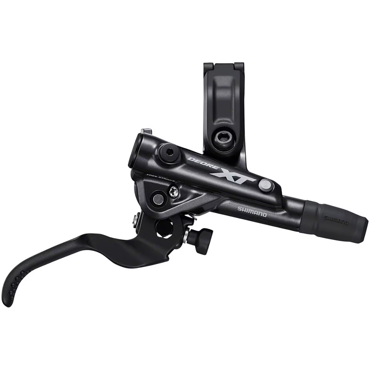

no that's not the case. the longer the levers the more fingers they are designed for. at least with me I can't get full braking with one finger on a 3 finger lever. a single-finger lever is short and takes a lot less effort to pull. this is a single-finger brake lever and I can stop our 400-pound tandem with one finger on each lever even on the steepest of hills. few bikes come with single finger brake levers.
If the OP grabbed a handful of brake and went over the bars, the solution is not to make the brakes less powerful, it is to use the brakes properly by not grabbing them by the handful. All decent mountain bikes have 1 finger brakes, even if the lever might technically have room for more fingers. They are not rare.
