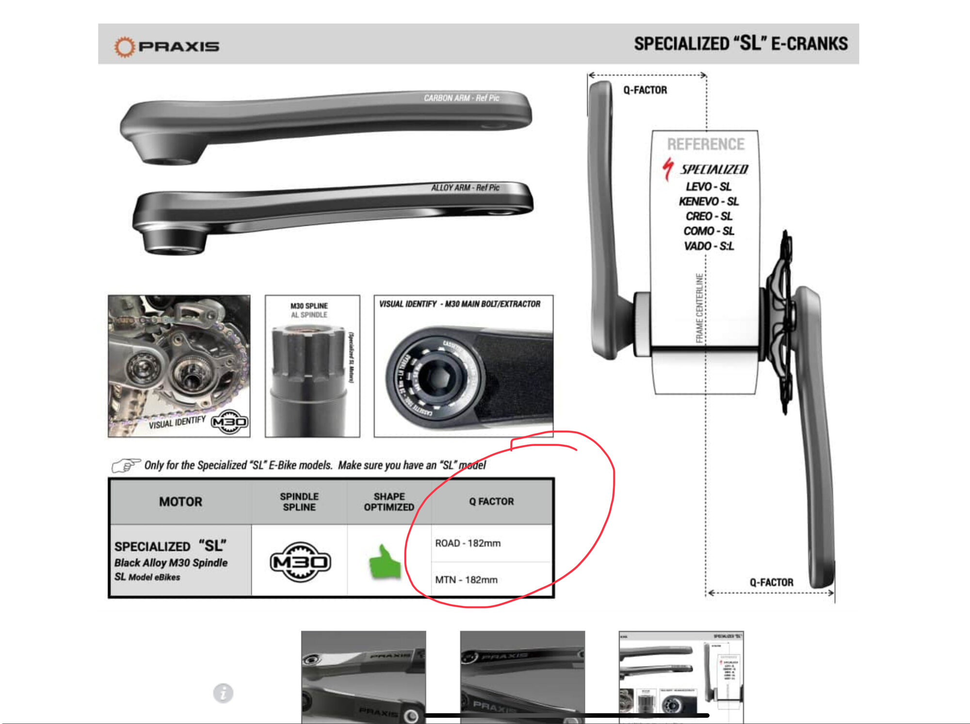

Hi, I'm very interested to hear what carbon crank you got for the Specialize 1.1 from Praxis because the M30 spline all have 182mm Q-factor

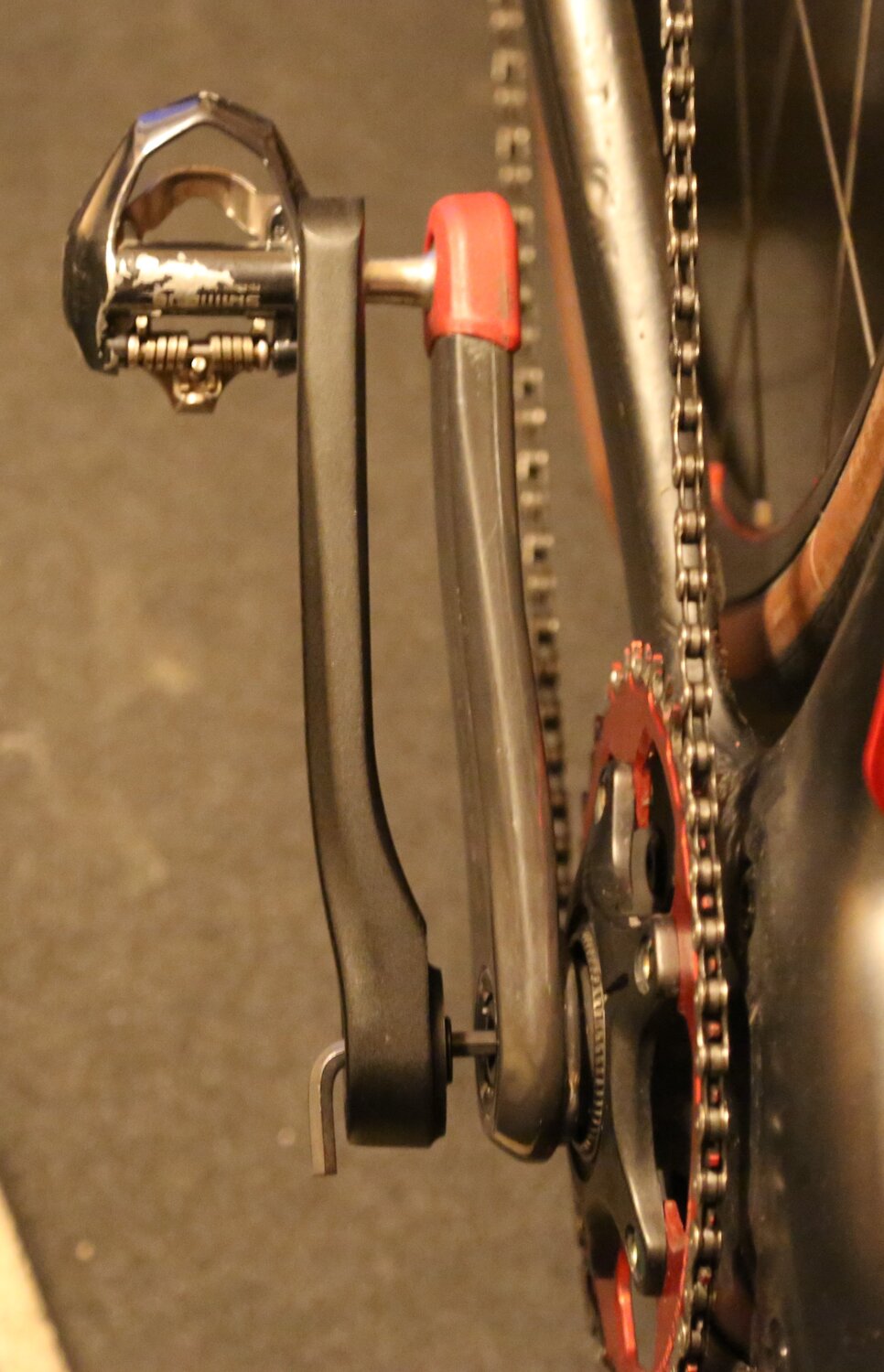

I have the Praxis M30 175mm carbon and they did feel narrow to me as soon as I fitted them. As you will see in the photo, I have laid the alloy one next to the fixed in place carbon and the alloy does go further out
